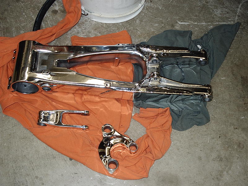

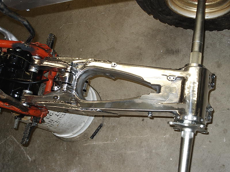

First off great website. I'm so glad there are so many trike riders out there still. I think you guys do a great job with the site and it just keeps getting better. Second, I was wondering if you would like to put my project on the Restorations/Projects page. I'm working on a Custom CR500 to ATC500 conversion and have included some pictures for you to check out. I'm not sure how you setup the projects page so if your interested let me know and I can send more photos. I've done a pretty good job of taking digital photos to mark my progress and have some info on final goals and specs. A general rundown would be I have completed:
Started with frame from 1987 CR500R, a 86 CR500 engine and various parts from a 1986 ATC250R.
Swing arm 100%
Swing arm was built by cuting and grafting a CR500 arm and a 400ex arm, using the CR500 linkage, polished are and replaced all bearings.
