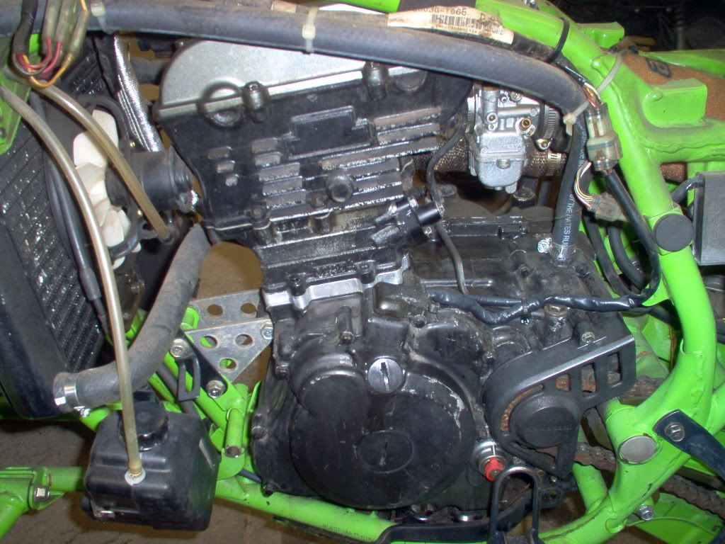

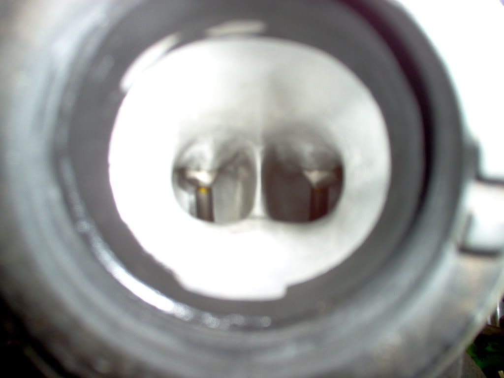

    here is the pic of my 411 stroker engine that mickey dunlap at four stroke tech. built for team kawasaki back in the day. Ported and polished, big valves with a big set of cams.....oh and ofcource the stroker crank and spacer. Havent had any probelms with the spacer plate.....oh and this thing is MEAN since stock it was a 250 lol
