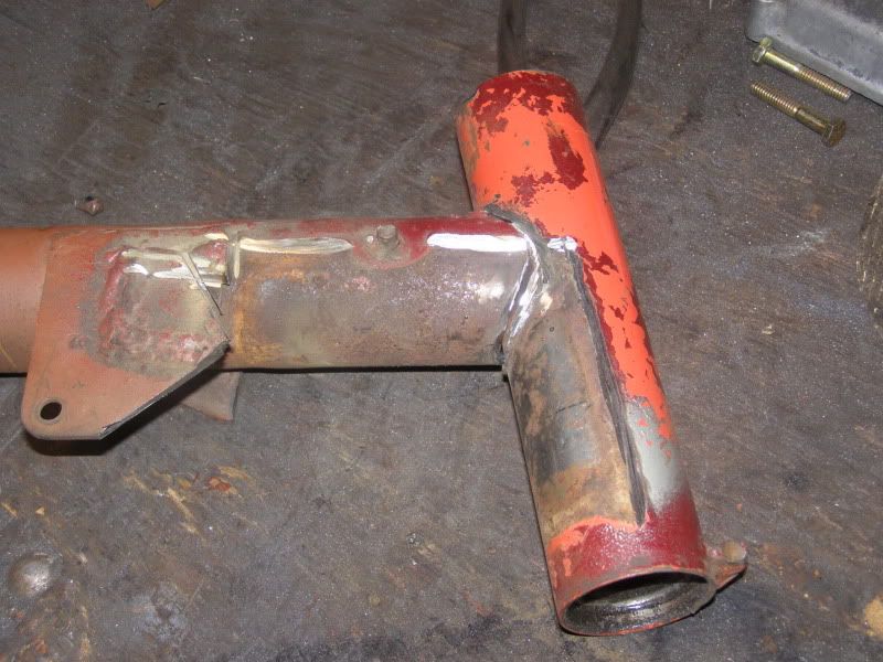

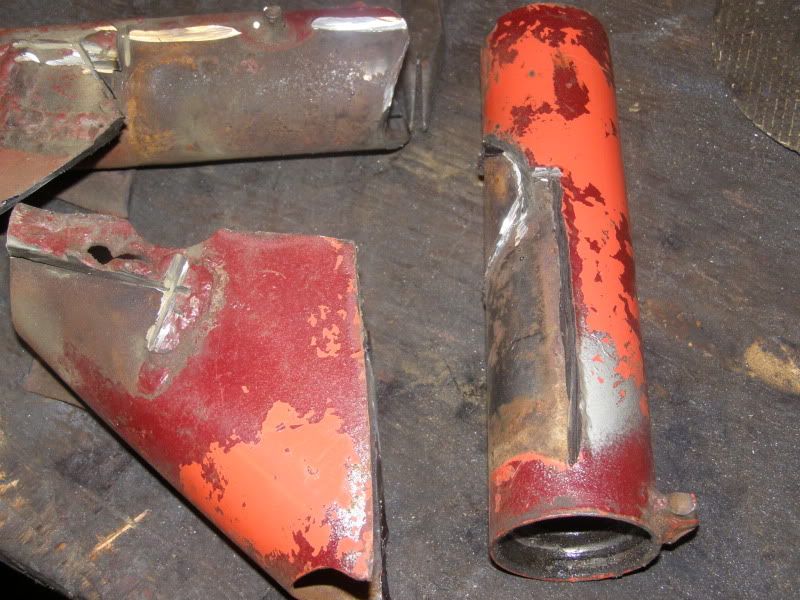

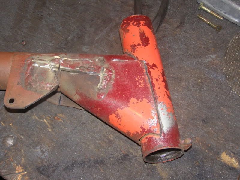

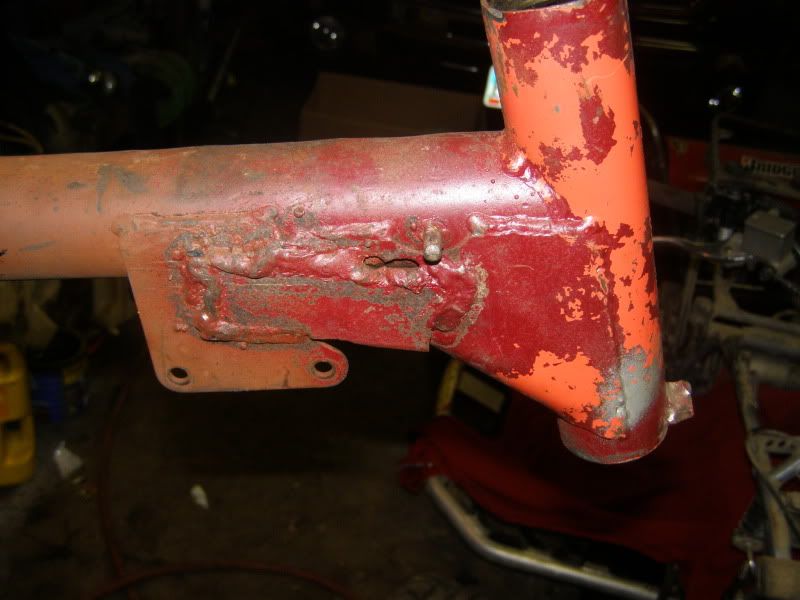

    this 73 atc70 seen better days. the neck was bent and twisted a couple of times in its life and repaired to the best of whomevers ability, the also welded on some other guesset to help the neck. i noticed the steering head was a little of kilter from the rest of the trike so. out came the cut off wheel and choping started. i also think i will strech it 1" at the steering head for a little more room at the tank and fender to motor area.

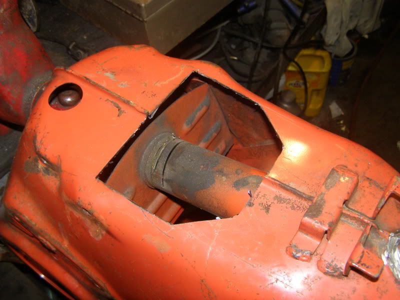

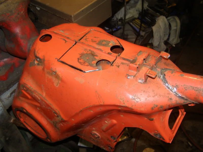

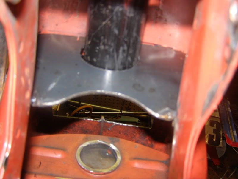

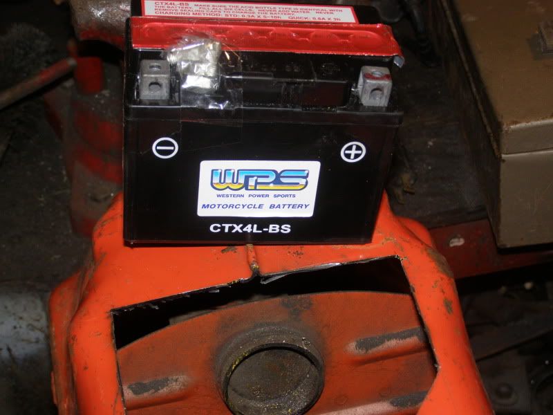

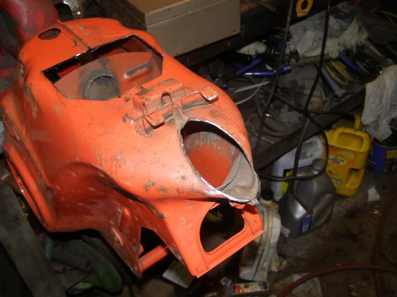

    i plan on (did allready) cutting a hole just under the seat to hide the battery and cdi. since its in the way of the neck i will resupport it off to the sides of the battery.

    as you can see the the steering head is off a little.
    battery and cdi hole
    extra guessets that were added

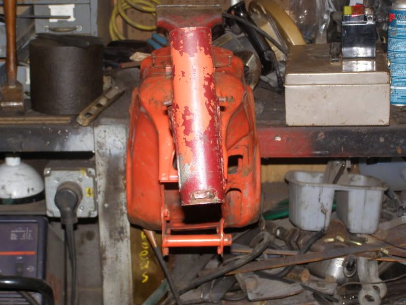

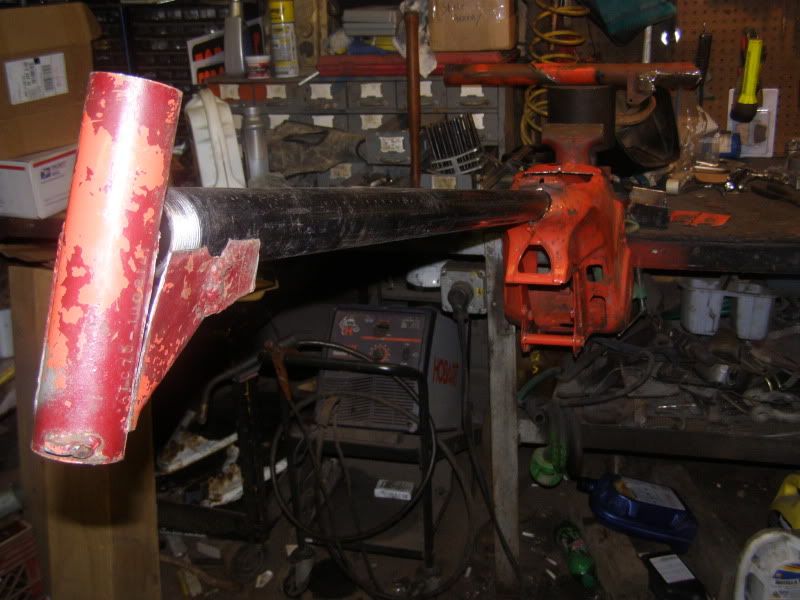

    neck removed
    new support for the new neck
    cutting the steering head off

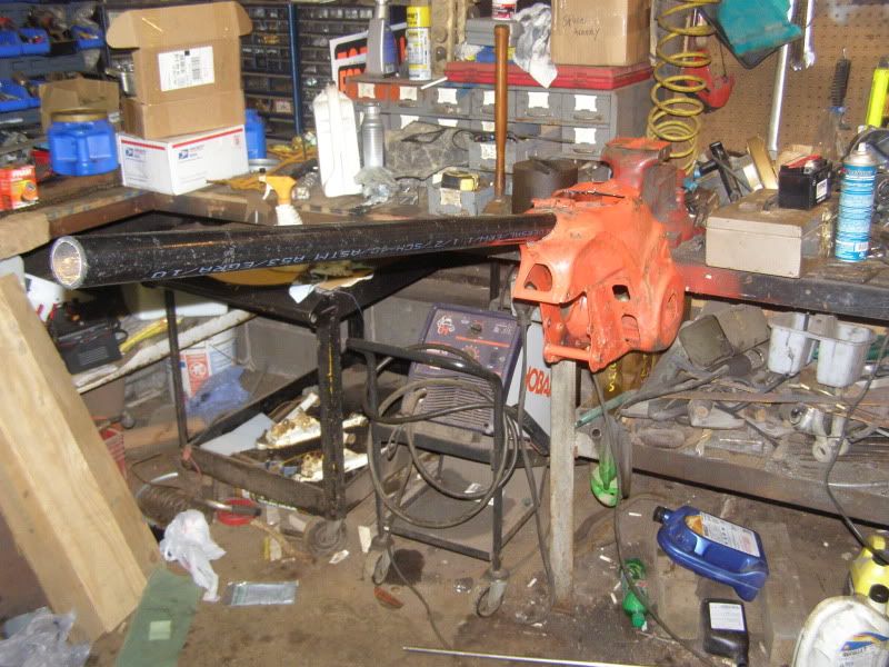

    i went to home depot and found that 1 1/2" black pipe is just the right size.
    i got sch 80 so it will not bend again. it was 3.78 a foot, i bought 4' just
    incase.
