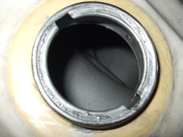

    POR15 is a much better product than Kreem. I pulled the Kreem coat out of my BR tank to put a por15 kit in...

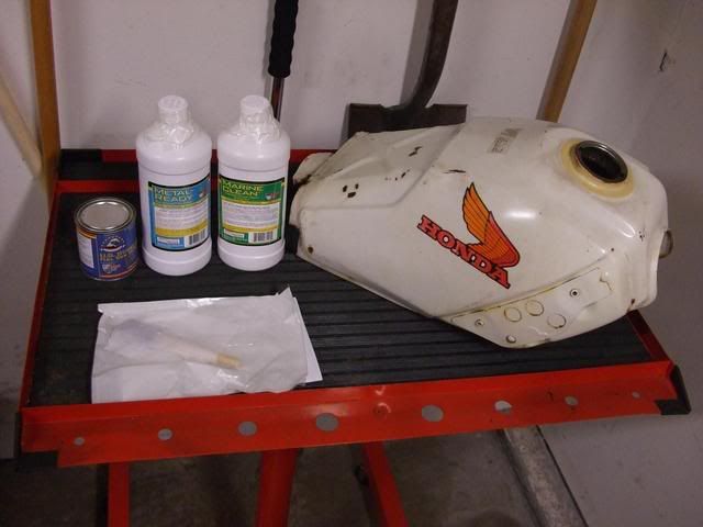

    So what is is POR 15 that you guys speak of? What does it do? Where do I buy it? How much does it cost? I have a little surface rust on the inside of my Big Red tank, will the POR15 get rid of that? Thanks

    POR-15 kit plugged pin holes in my 200x tank, and no more rust to worry about. No leaks since last summer.

    Quote Originally Posted by Mondexbrute View Post
    You can buy it off eBay directly from POR-15: http://cgi.ebay.com/ebaymotors/POR-1...Q5fAccessories or from their website: http://www.por15.com/CYCLE-TANK-REPA...ductinfo/CTRK/.

    I just ordered the kit off of ebay!

    Seems reasonbly priced, and it doesn't take long according to the directions... Ima use it on my 90.
