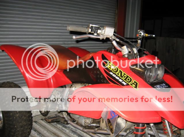

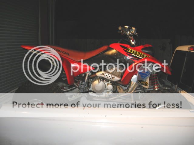

    2002 400ex stage 2 cam, kfx 400 exhaust, pretty nice over all came with a set of geeky high school girls (tall skinny knobbies) and a set of sand star paddles. runs good other than having way old (probably ethanol) fuel in it biggest problem is 3rd gear doesn't want to stay in thinking bent shift fork not 100% though will have find out when I get the case tore apart and look at it. but even if I have to replace a drum or gears I'm still in the green as I only paid 1k for the bike.

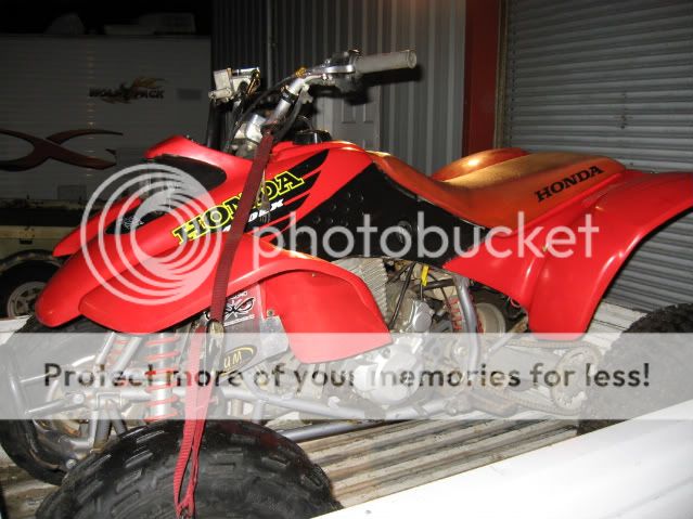

    its ok, the plastics definitely show that its been rode hard nice big crack on front left fender and the left side mount for the fender brace on the rear plastics is broke off and there is a hole in the plastic these plus other small scratches and gouges but overall is nice. Can't wait to be able to ride it, trading the skinny knobbies on it to someone that knows what they are doing for the engine work, have a set of that I could use for a dirt tire. I don't really ride dirt often as I mostly ride in the sand dunes so don't give me too much crap about using
    and the seat cover is pretty well shot so that is on the list of things to replace but I want to get it riding first

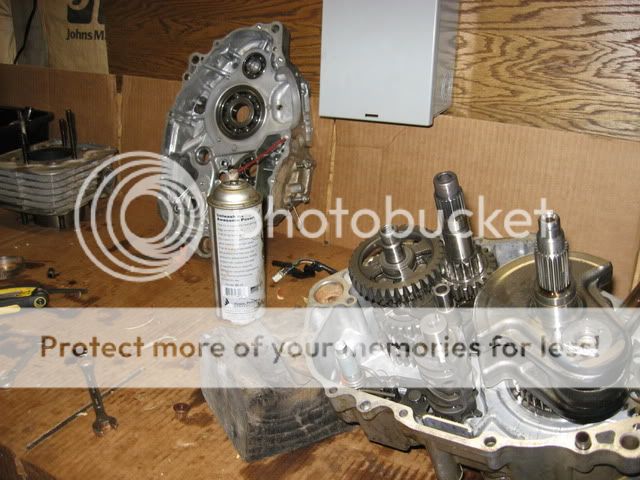

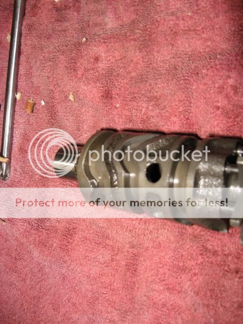

    parts all got here except the gasket set which I'm hoping to see today, got the motor tore apart and found the only problem was the shift drum, gears and shift forks were all good. Some pics for now
