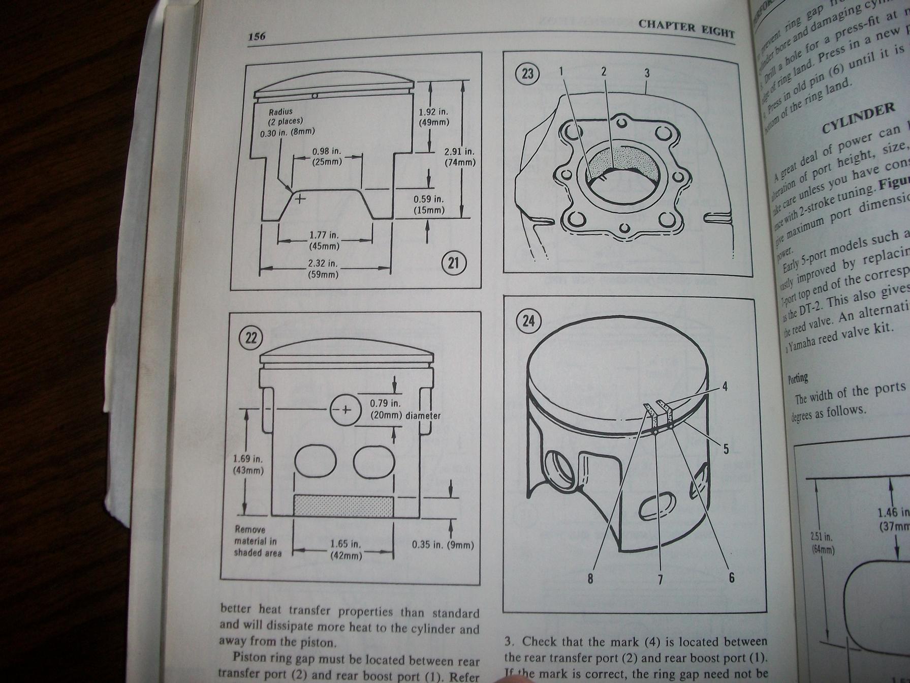

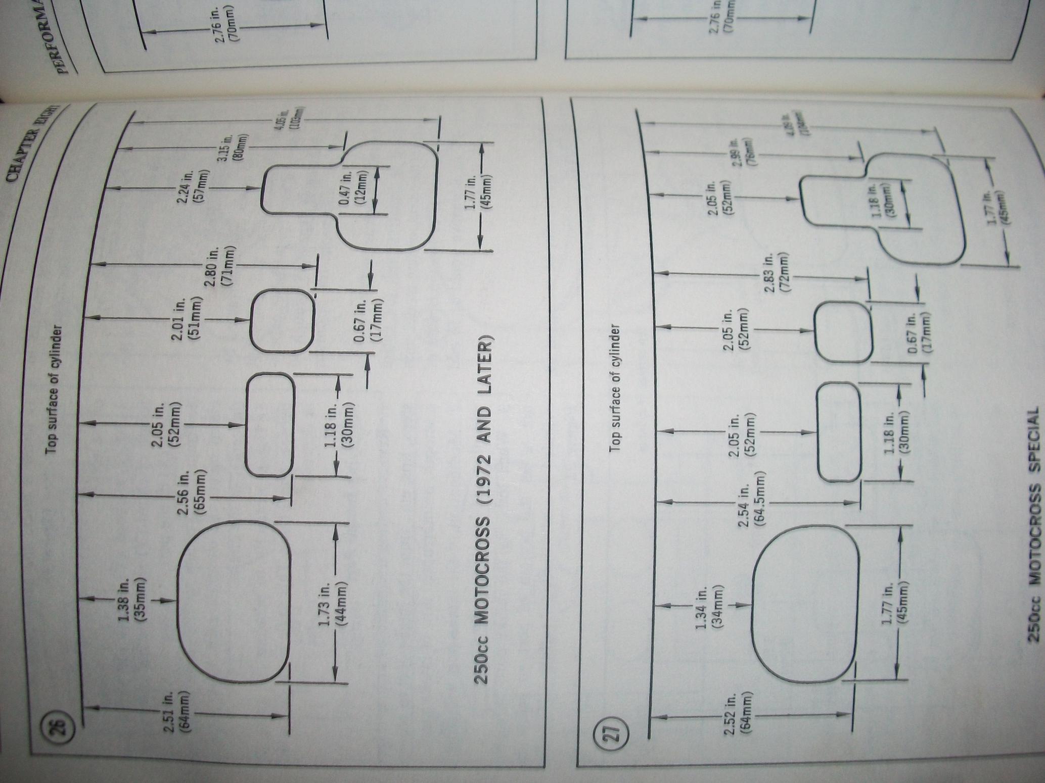

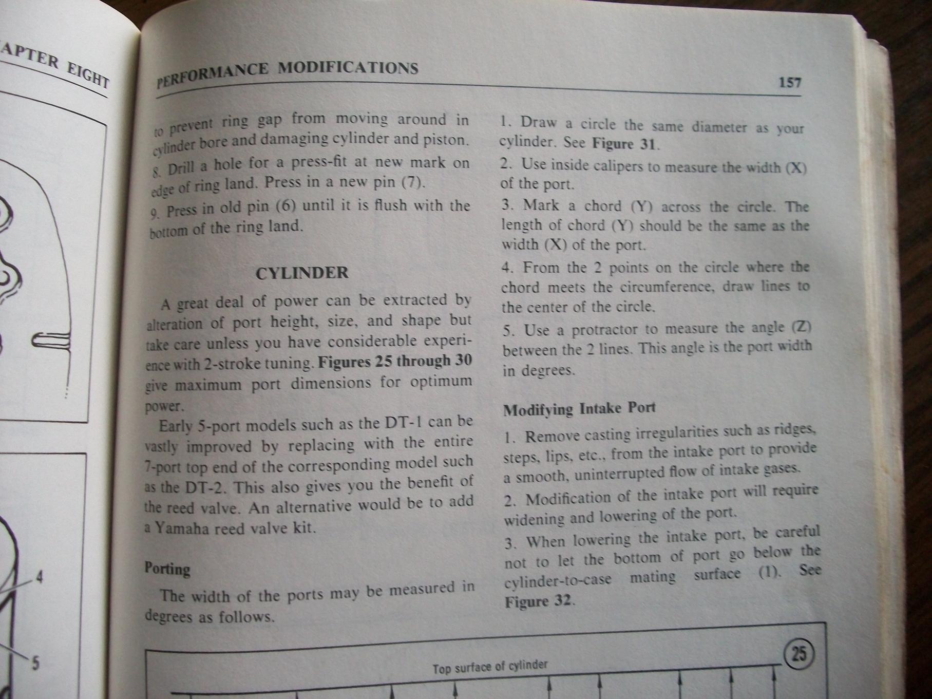

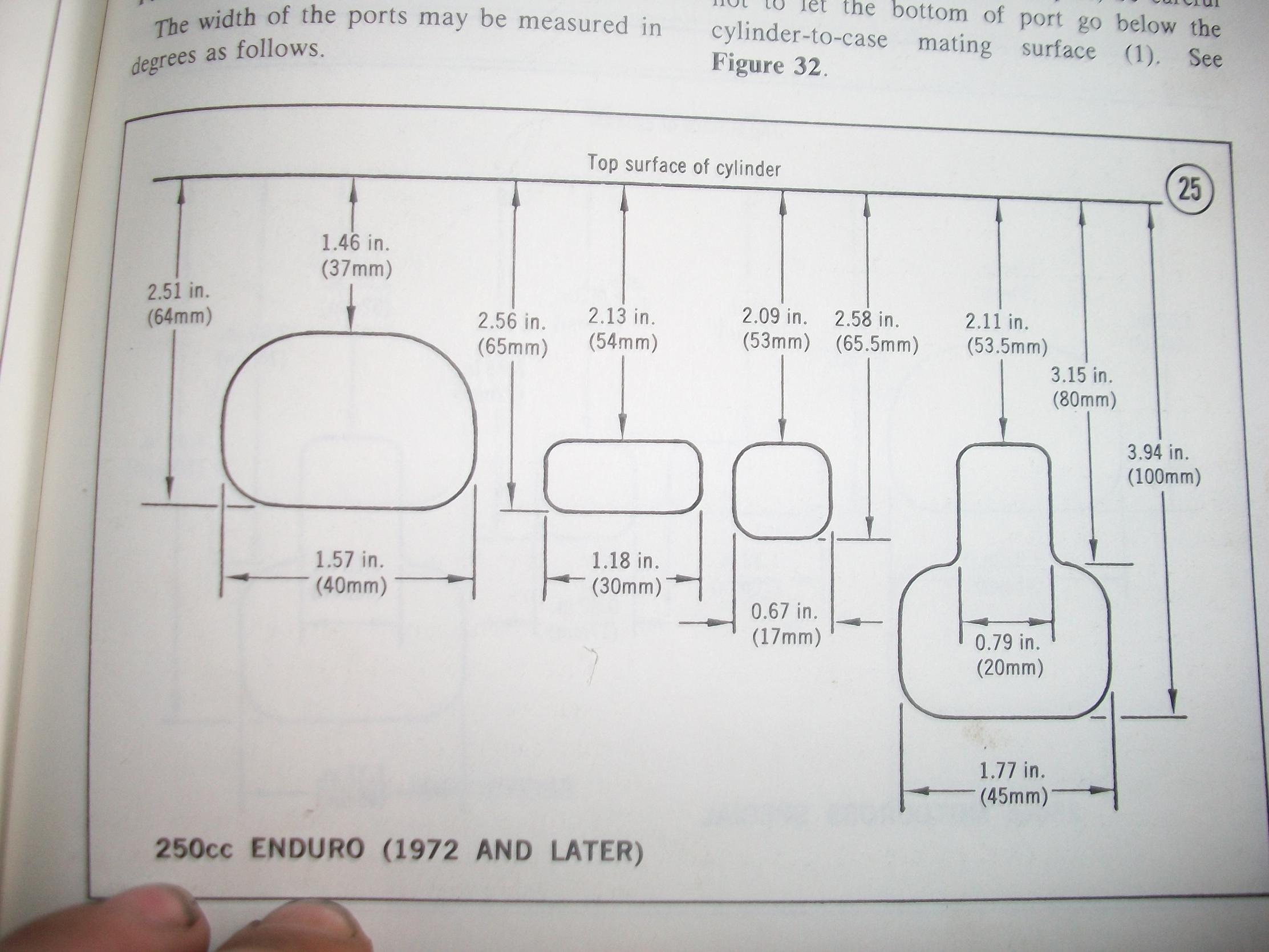

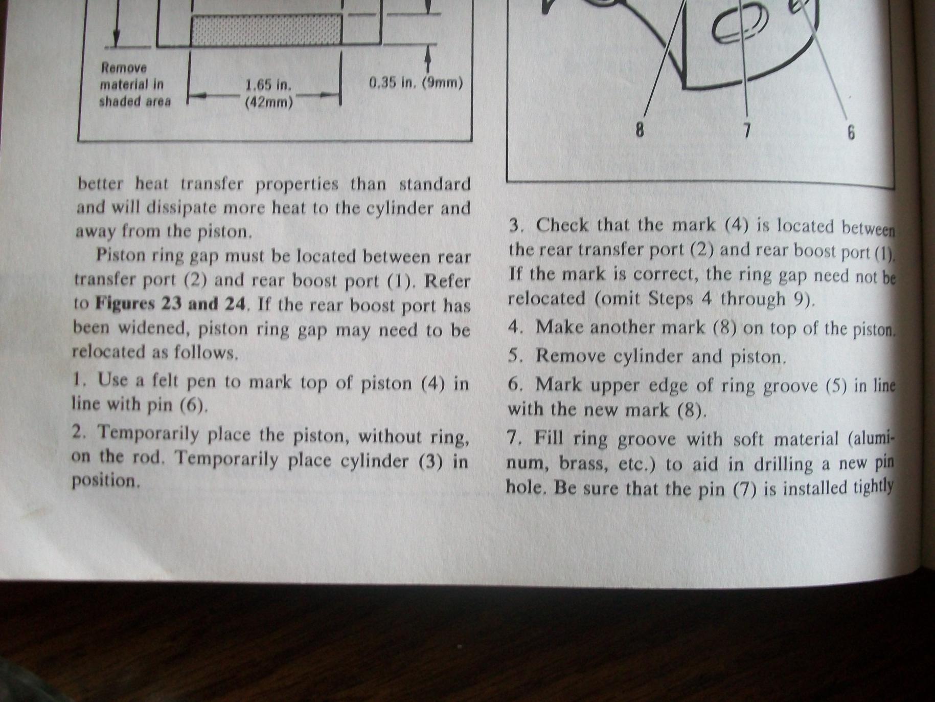

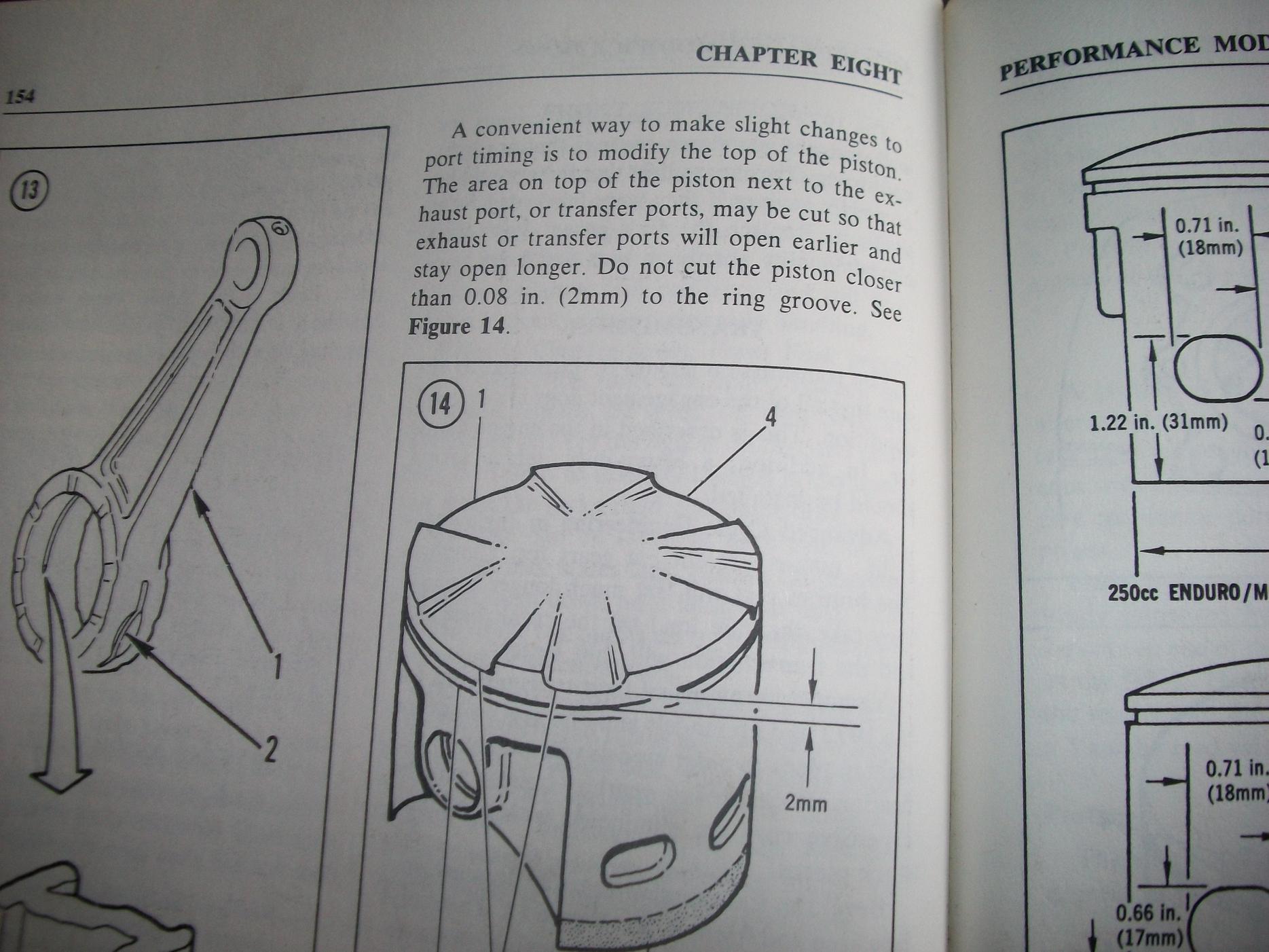

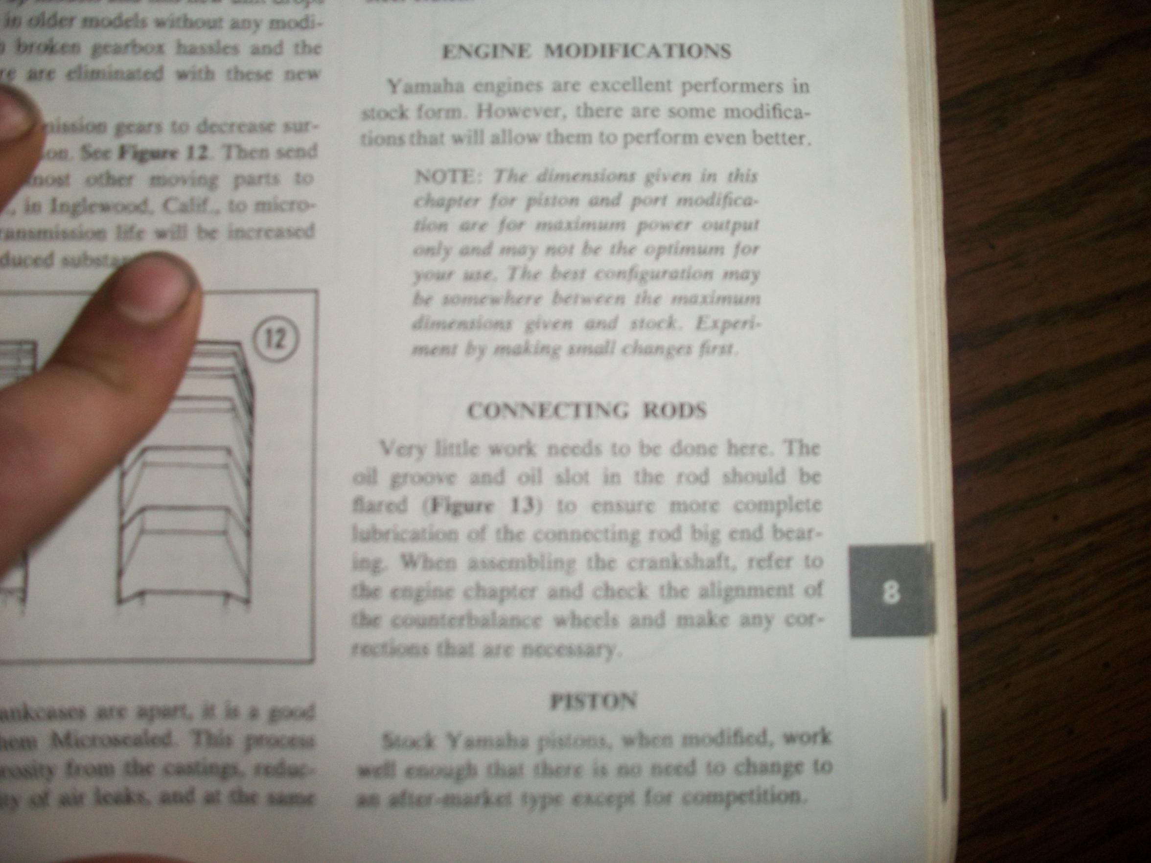

    i figered some of you guys would like to port your own motor but are scared of messing up your motor so i borrow this book i will be getting more and better pics later tonight but this is basicly whats in it

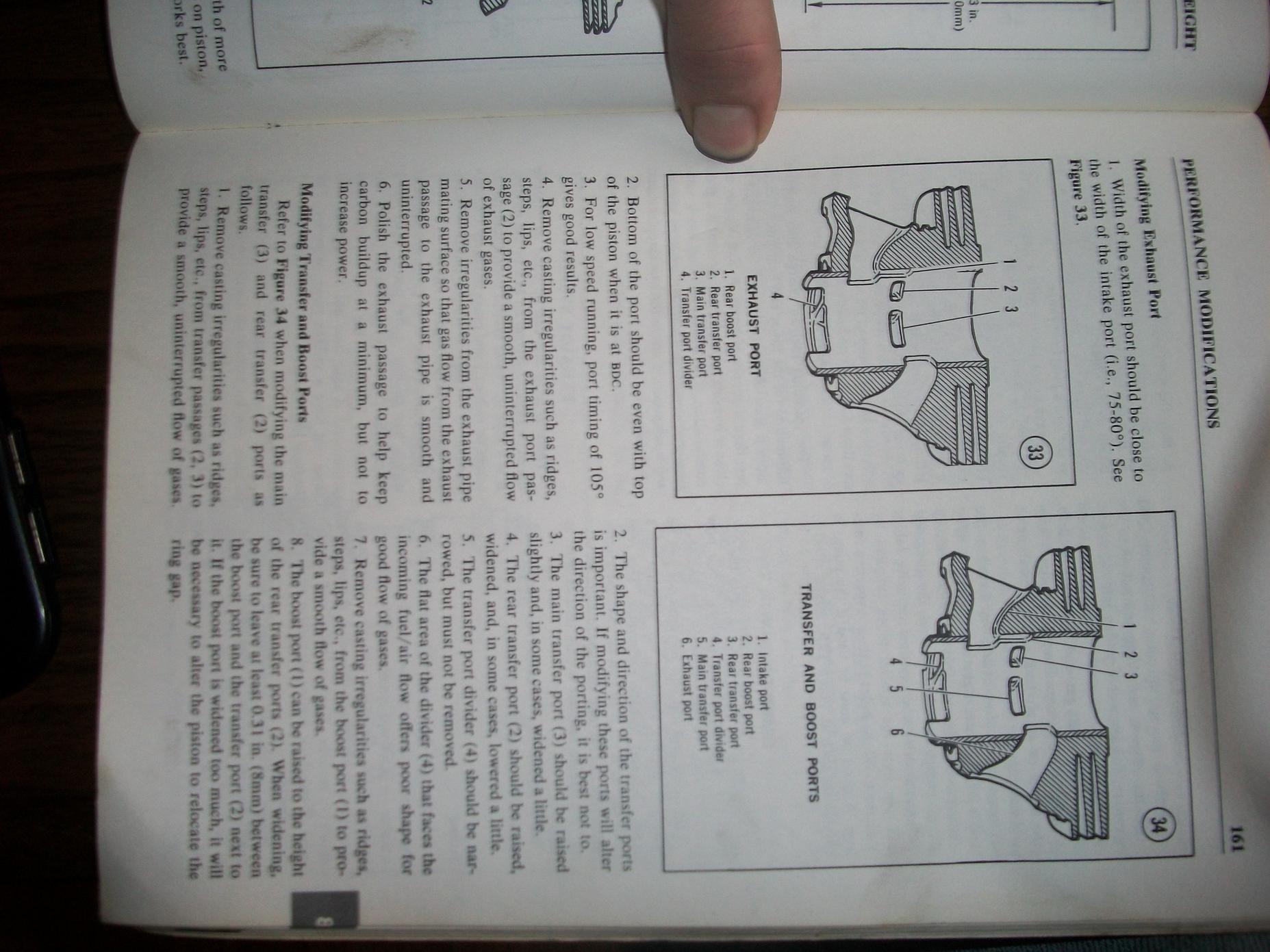

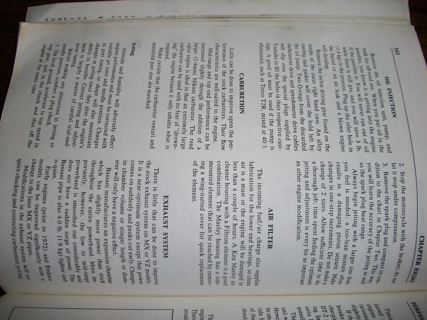

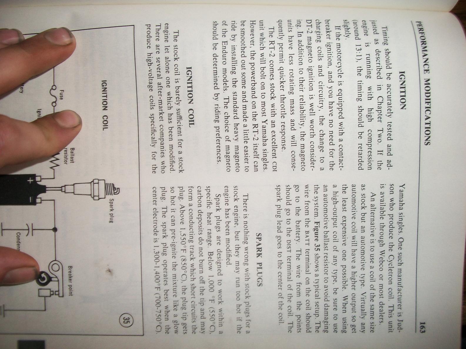

    edit: contrary to what VAhuffie said page 161 to 163 are non motor specific most info on thease pages can be helpfull to most 2 strokes please dont make negitive coments unless you read thouse pages some other pages contain info that is also non motor specific what you do with this info is your choice do not compain that some one was nice enough to make this book avalible online as you wont find it anywhere else ive checked

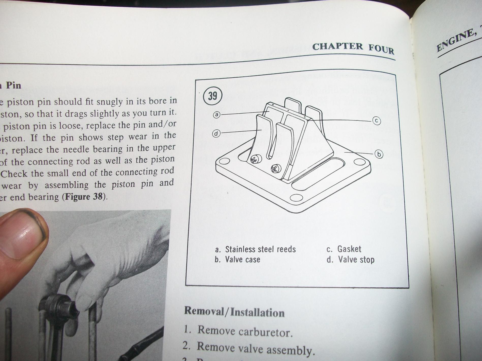

    you have no idea what your talking about theres even info on what reeds to use in the book have you even seen a old yz motor
    osoyoos bc canada
    1,057
    unless i imagind this but then it would have been hard to get this pic

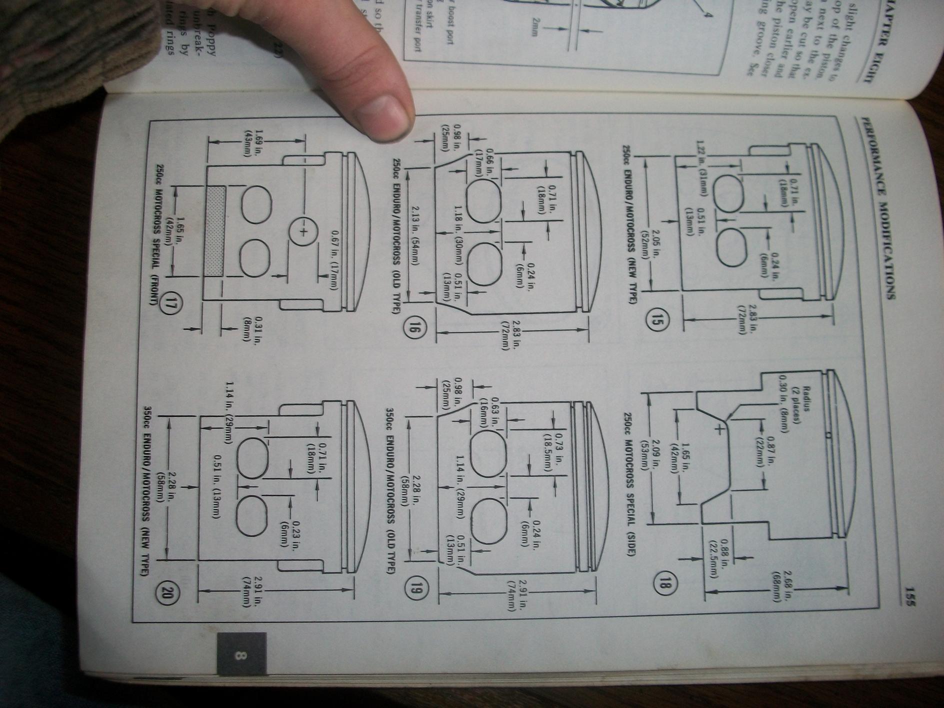

    I entered the information for the 250cc for image 25 in my program here. It's actualy not to bad on the timinings. 184.4 exhaust duration, 117.4 on the main transfers, 122.2 on the aux transfers, 119.8 on the boost port. This gives a blowdown of 31.1 degrees. Most ported engines have 30-35 degrees of blowdown. This is the time from when the exhaust opens to when the transfers open. This is somewhat similar to what i run on my trikes.
    And that book does explain port modifications for more power, it's not just a repair manual. On page 8, in the first picture posted here, it states that it gives demisions for maximum power, this is more than stock... lol read the book before you say what it is not :-p
