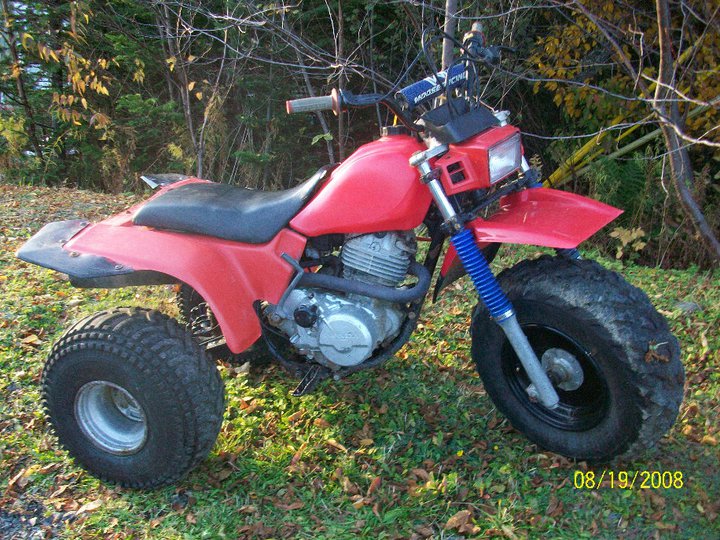

    this is my 85 250sx
    Jordan patey
    85 honda 250sx with 300 honda motor
    81 honda 250r
    83 honda atc 110
    84 honda atc 70 with 125 lifan motor
