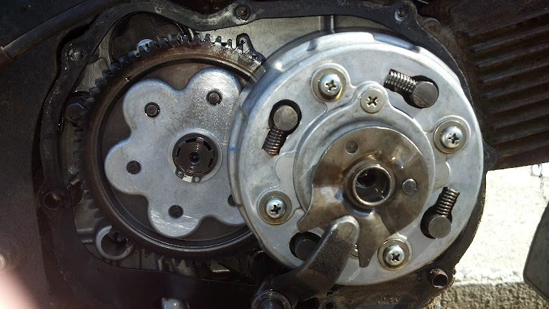

    Hi everyone, Sorry its been almost a year later in response. I just pulled the cover off this week like you guys said and everything appears to be moving and shifting fine. What should be next step be? Thanks

ID:	143259 On the center of clutch where that metal piece is there is 2 drilled holes on that metal piece. One hole has a bolt/pin through it, the other is just a empty hole. Should it be like that?
    Here is another picture of the inside
    Everything looks like it should be working i don't know whats wrong
