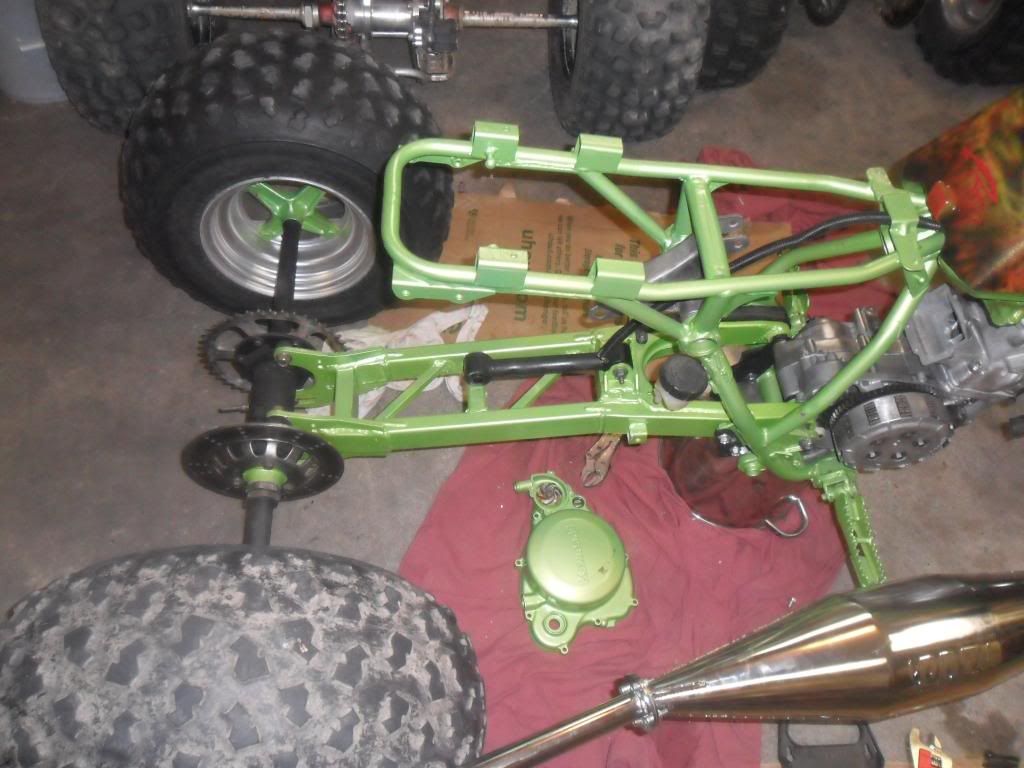

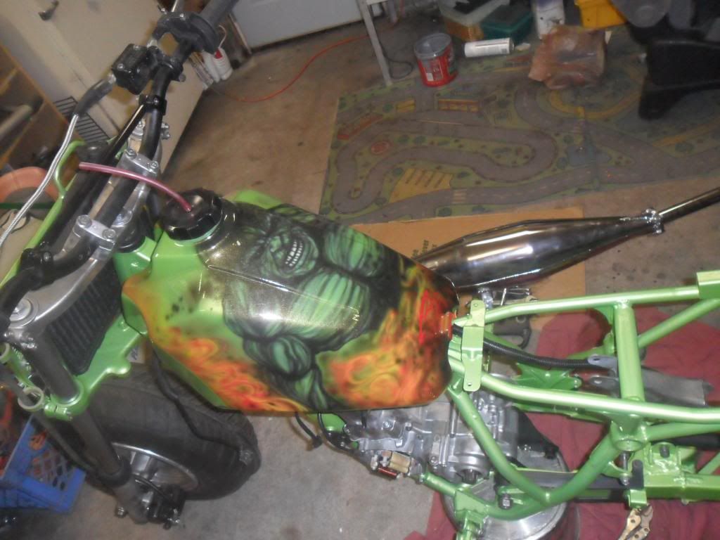

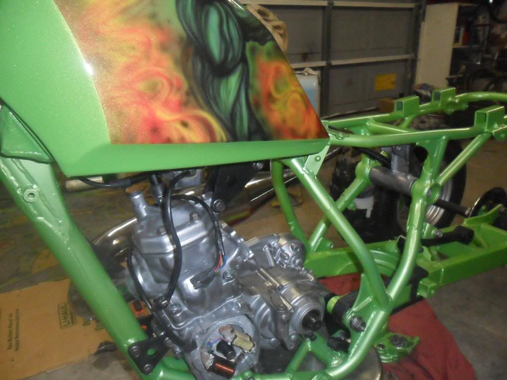

    going with a rdz drag pipe v force 3 reeds so far waiting on a Brock's cool head going to run alki need a builder what should i run stock want to see low 4's got 4'6 300 foot out of my 84 hulk bike 80 over on 110. i need a 12+swinger who makes them and who is the best t3 builder ? trying to get done by trike fest 11

    It looks great, man, nice work. Engine builder....????, by trikefest, is not going to happen. There is One that built the oldschool Jimmy White Tecate's. Look up Klemm Vintage-http://www.klemmvintage.com/. Harry Klemm used to be Klemm research. He's one of the only one that does the 'A' Tecates. He was in his busy season with his marine business, but may be ready to roll. Klemm will be offering a big bore kit. No other company does at this time (by my knowledge) for the A's.

    its going back to rdz this winter for a full drag port so for now he told me what he wanted out of the intake side so with beer in 1 hand and dermal in the other i went at it lol so it done i put the hole thing back together and she runs.compression at 190 going with 110 for now got to find a carb to switch over to alky i got 2 pj 36mm alky carbs for my banshee but they wont work on this intake need to find different hubs for it these ones only fit 10in rims and i got a set of 8s i wont to run with sum 21-11-8 12 paddle haulers for it
