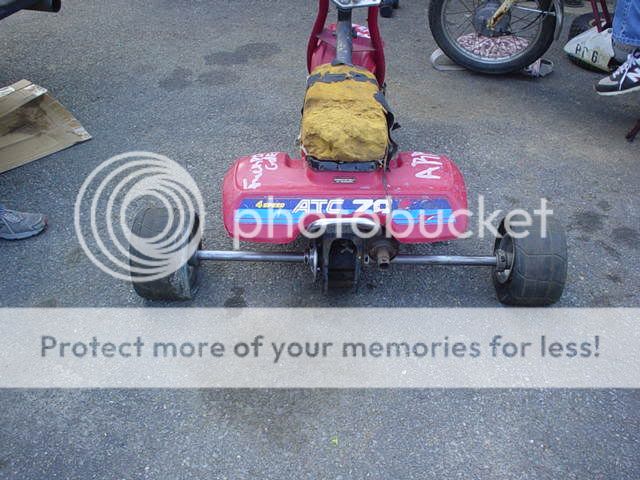

    How are you bolting up the go-kart hubs on the 70 axle?

    I have not done it myself but I have seen others that have had the axle turned down to 1" and used the kart hubs and others have turned the atc hubs down and re-drilled them. I took a set of atc hubs to a machine shop last summer to have turned down and they tried to make a big deal out of what I thought was a simple job so I did not have it done.

    Does anyone have stock hubs that have been turned down that could post a pic of them?

    We [mad 70s] take a stock hub and turn it down on to 3.100" then drill the cart bolt pattern in them, the thread we posted most of that stuff on is under mad 70's or Mad 70's In Action , the cold has had us all hiding all winter so there is not much happening with our gang right now
