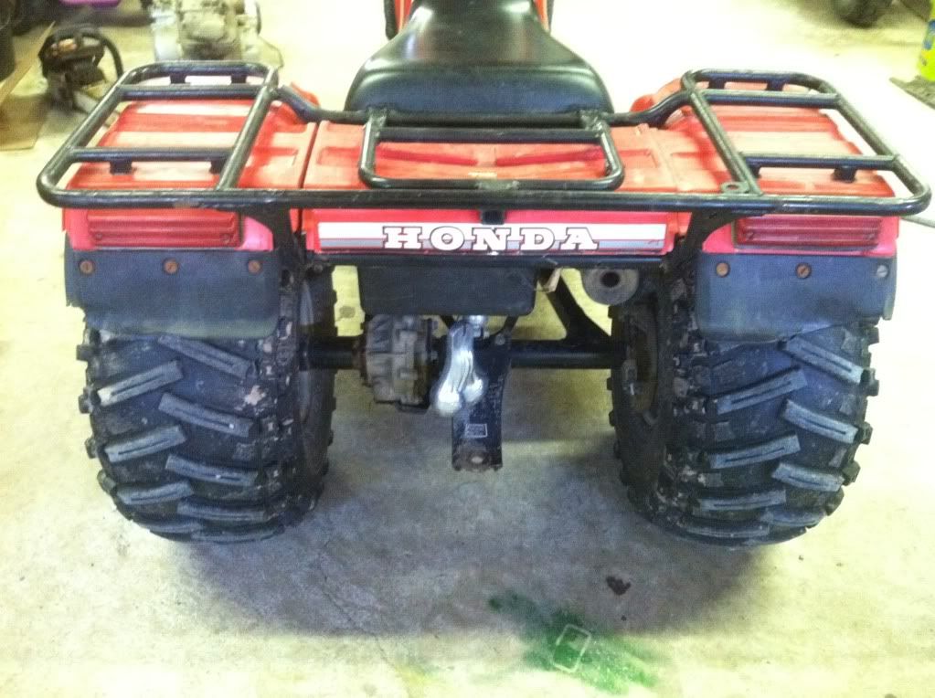

    4.) Added rear disc brake set up. These work so much better the the stock drums (especially when wet)!
    Here is pic of the disc wielded to the hub and the caliper wielded the rear axle housing.

    Here is the brake handle and reservoir.
    This set came from some random 4-wheeler

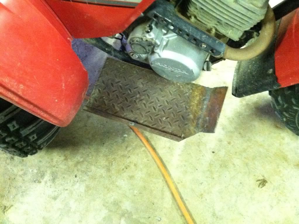

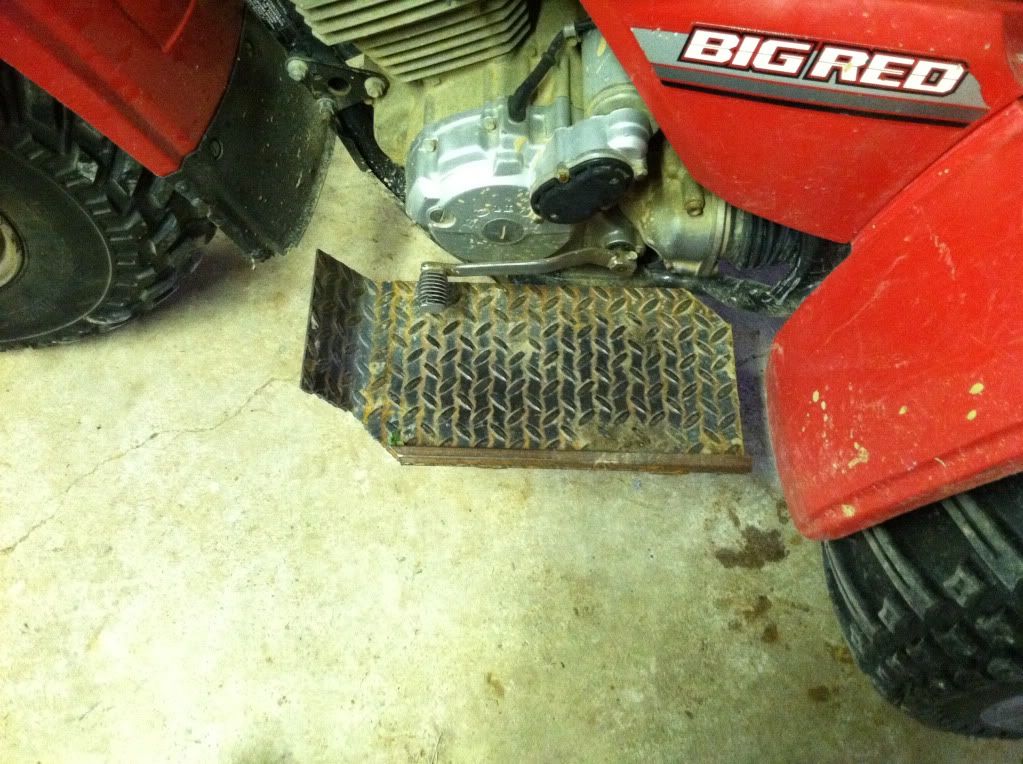

    How about some floorboards? Made these for about $20. They just bolt where the footpegs did, but you have to remove the foot brake.(I never use it anyway...) They are 100x more comfortable than any footpegs could ever be, and the diamondplate provides enough traction that you dont slip off of 'em!
    $10 from Spencer's... Probably my favorite mod.:
