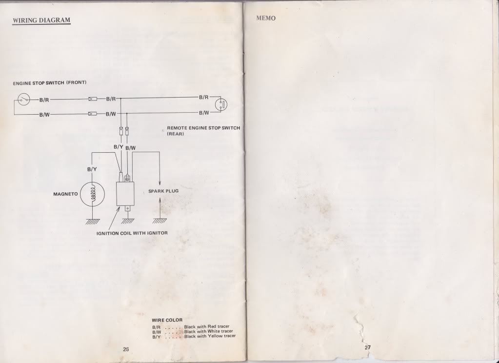

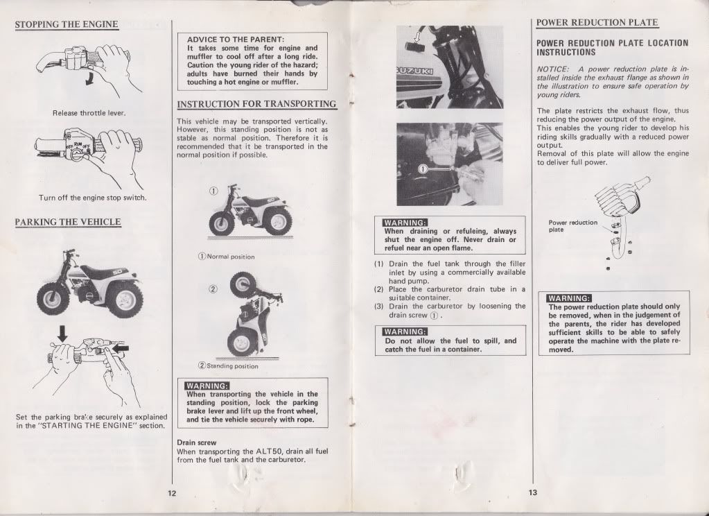

had this scince my alt 50 was new and thort it might help someone out with a problem.
it a pitty the mace have started to eat it but you can still read it.
