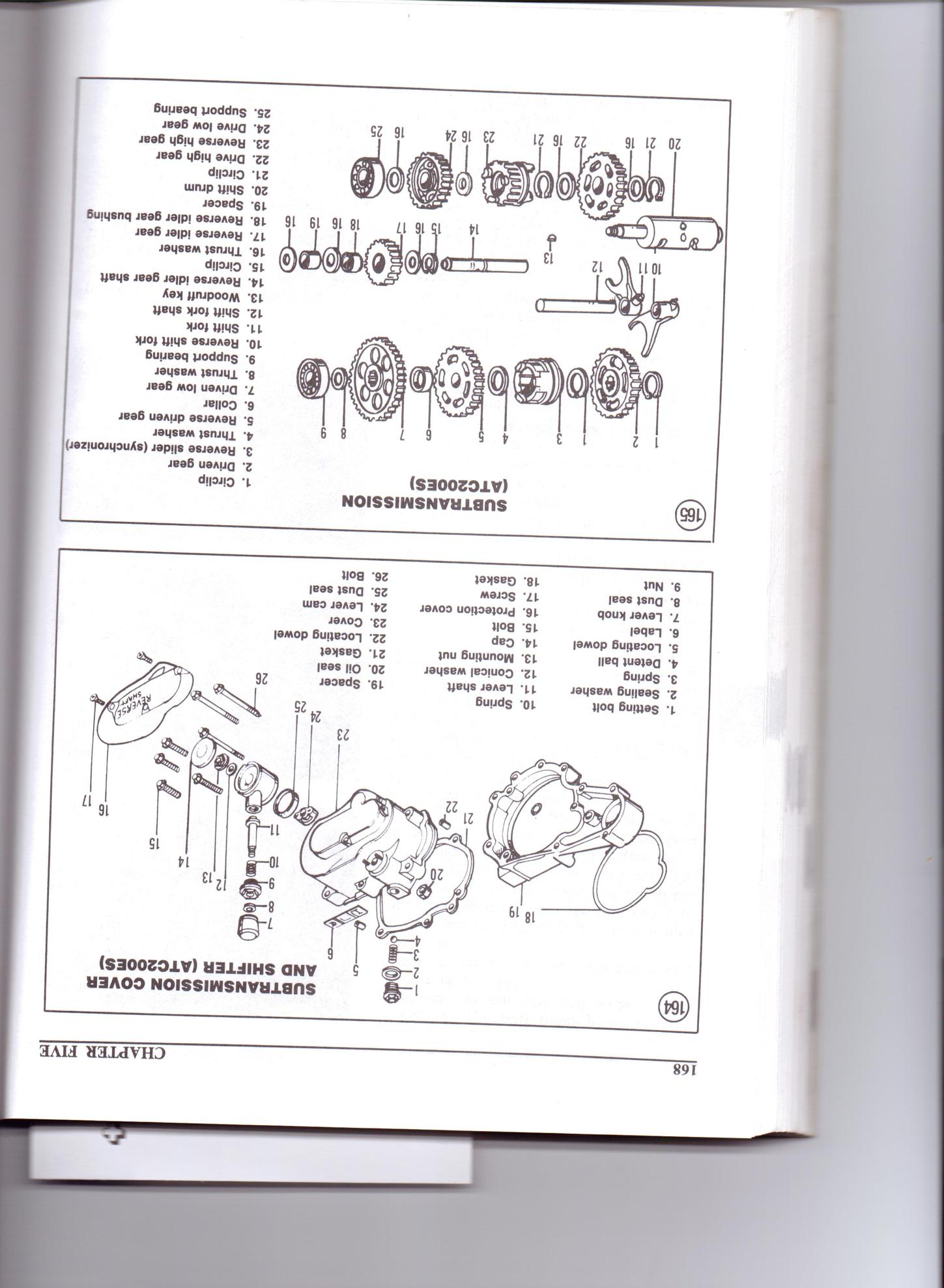

    hey getmoresoon I seen post about the subtrans on a 84 200es subtrans I scanned my clymer manual pic of the parts explosion hope this gets to you or hope you see the post under the newby discussion
    sorry its upside down... lol

    I could scan the whole assembly/installation procedure if you wanted.... let me know
