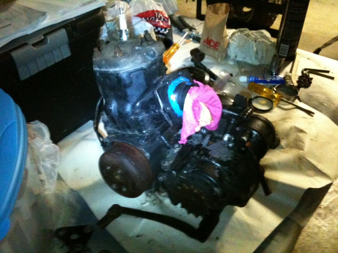

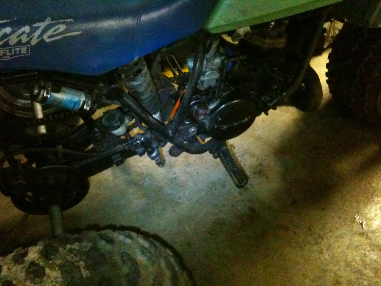

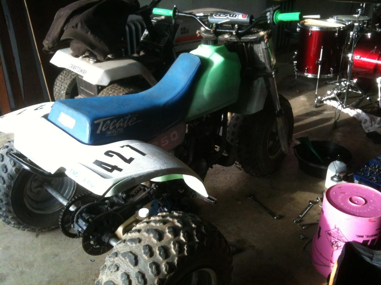

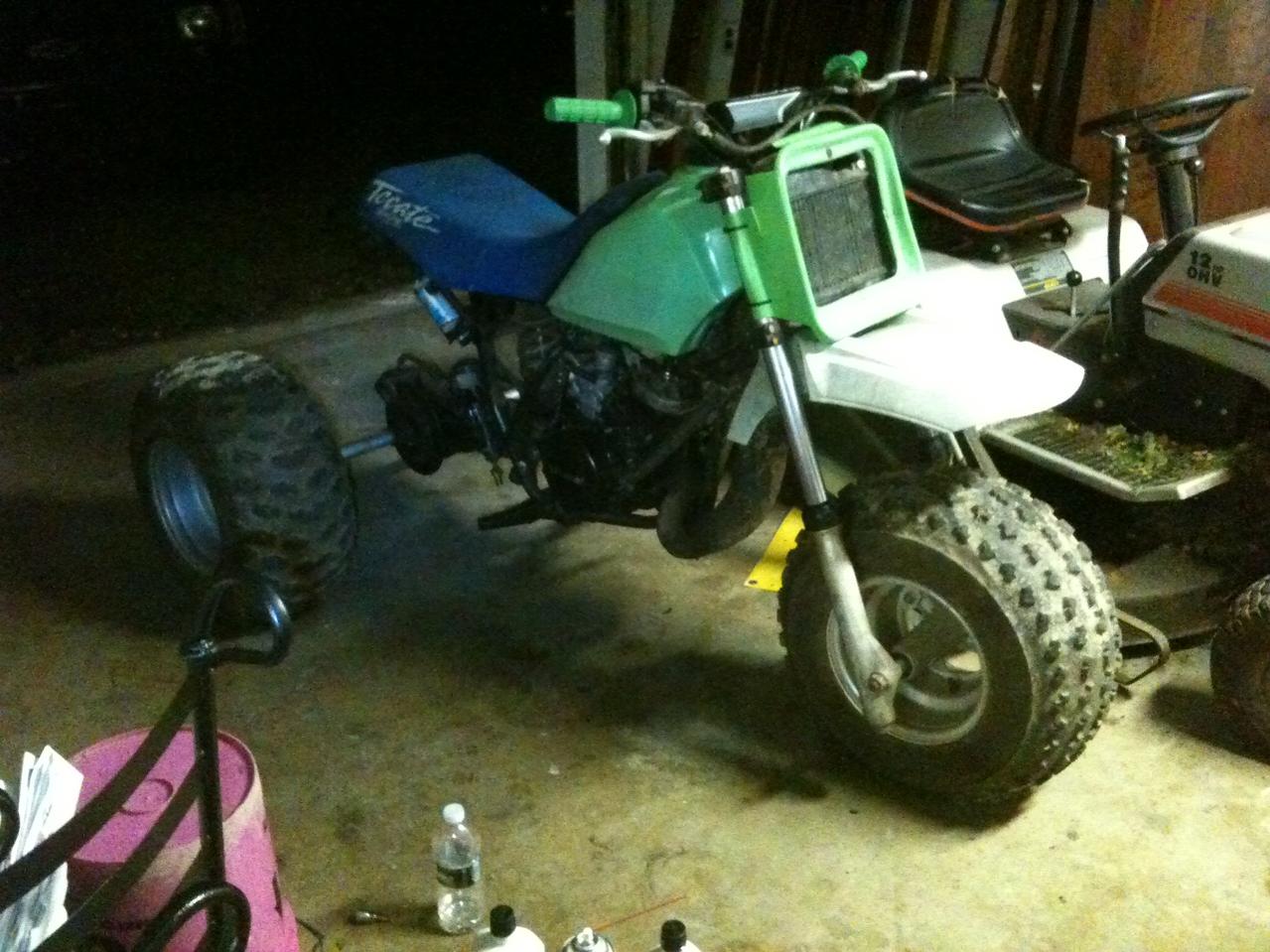

ID:	137642Click image for larger version.
ID:	137643Click image for larger version.
ID:	137644Click image for larger version.
ID:	137645Click image for larger version.
ID:	137646Click image for larger version.
ID:	137647Click image for larger version.
ID:	137648Click image for larger version.
ID:	137649Click image for larger version.
ID:	137650Click image for larger version.
ID:	137651Click image for larger version.
    these are in order from when i got it to now. ill be taking more pics of the bike and parts as i go
