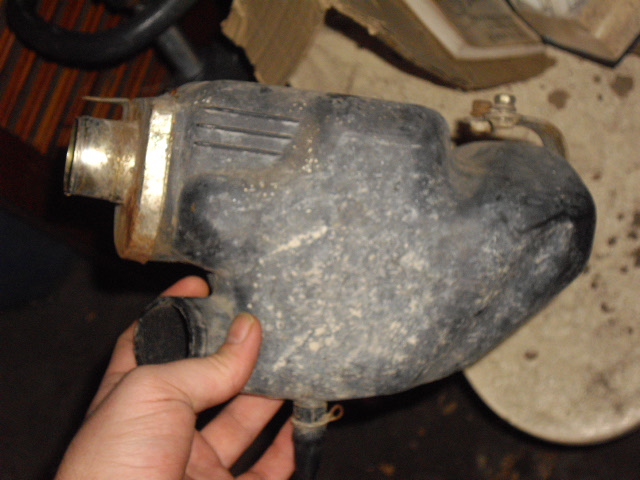

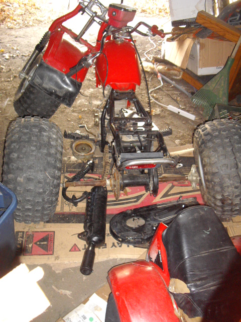

    Pile of atc parts i got for 125 bucks.
    2 sets of handle bars
    axle
    2 rear plastics and 2 fronts

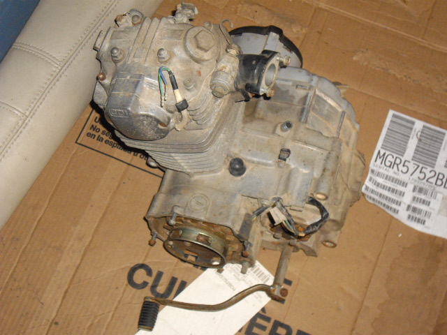

    185s engine

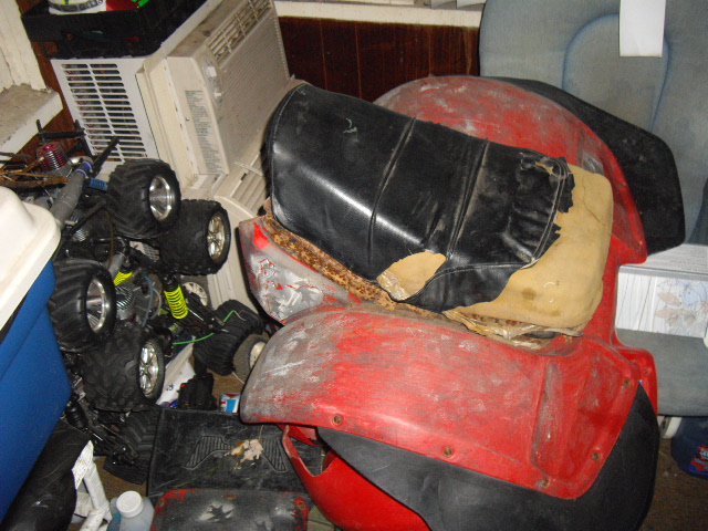

    Picked up the body a week after the parts, had to fit it into my dodge
    shadow to get it home.

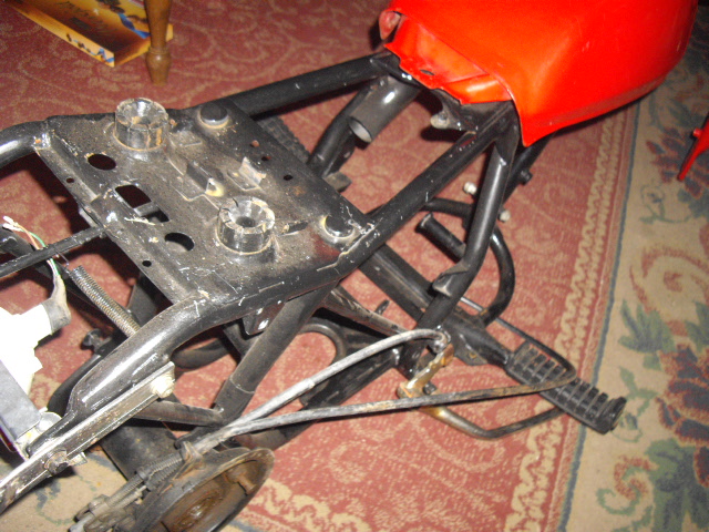

    starting to get it together.
    burnin rubber
    detroit michigan
    80
    had to buy a few parts.
    compression release slide plate that cost me $30 and i didnt even use.
    and one hub

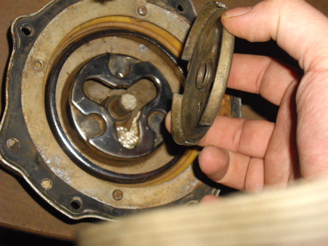

    one week after starting the rebuild. it was almost finished other then the pull start which was put on last week ,lol a year later.

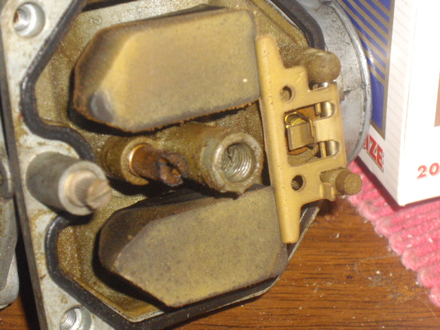

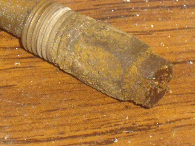

    tryed to start it but no go so i cleaned the carb, here it is before the cleaning.
    needle was so clogged
    first try on starting.
    a few more days later i got hold of someone that knew about engine over and he couldnt figure it out either , right before the guy was about to give up my friend
    george decided to mess with the carb and something made a clip noise , it was a little clip that the previous owner put on wrong so it was runnin wide open.
