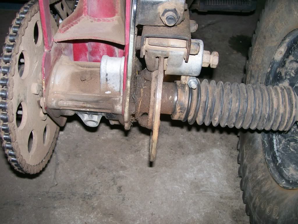

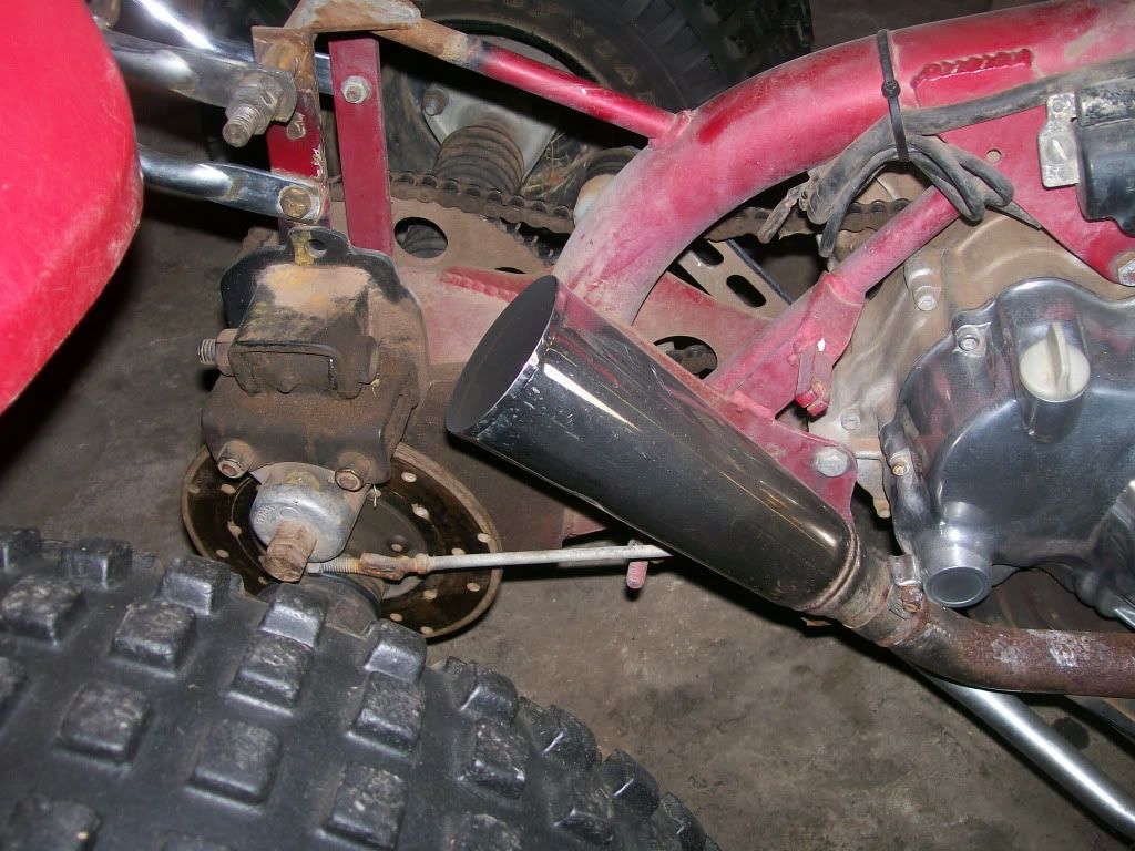

    Thanks guys... dcreel that thing looks good. how did you make the mount for the disk? or was that a purchased item?

    that rear disc set up on the 110 is sweet.. im in the process of redoing a 83 110.. love the idea...

    55stone, i think im gonna mate an 85 mx bike rear caliper and rotor to a master cylinder on the bars... seems like it will work. ill have to post some pics when im done with it.
