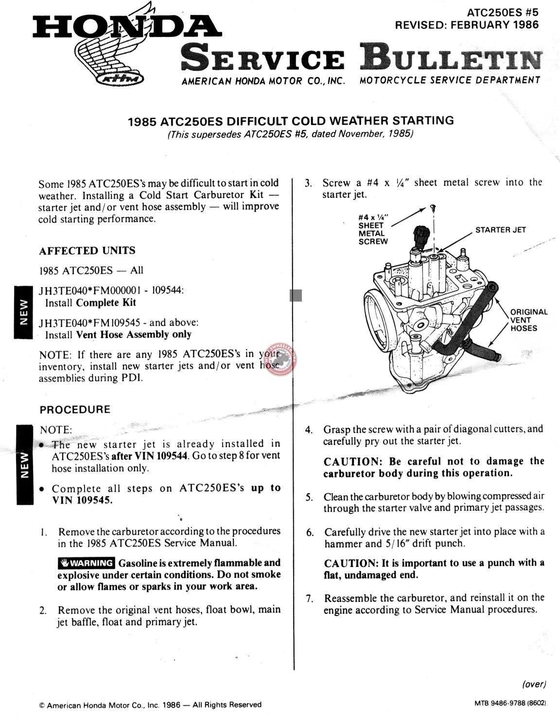

    Search in the Trikesylvania portion of the forum. This topic has been discussed recently. I believe if you drill out your main jet to .080(5/64" drill bit) that may resolve you're problem.

    yupp, lots of headaches.
    You're lucky it starts with the choke at all.
    Slosh the trike side to side violently to slosh gas in the carb.
    Take it off and clean, boil, compressed air, clean cold start jet,
    make sure choke piston has full travel..it's an enrichment circuit instead of
    the good ol' flapper choke.
    There was a cold start recall but replacement jets are impossible to find.
    Mine sorta reamed itself out when I tried to remove it with a sheetmetal screw like they say in the factory
    bulletin.
    Now it starts with 1/2 kick, full choke and warms up normally.
    yeah, search key for 'cold start' will give you tons of info.
    Mine kept me aggravated for over a year and replacement carbs are not easy to find WITH the choke piston
    intact.

    Thanks, thats exactly what I need. Ive been struggling with this for years great to know there is a solution to the problem.

    Did you happen to see a number on your keihin carb?
    like QA 01 or anything?
    yupp, I would not have believed that a slight ream on the press in cold start jet would
    make such a World of difference.
    Mine went from most hated to top favorite.

    I tried to get the cold start jet out with the sheet metal screw like they said in the bulletin and
    just by trying that a few times withOUT breaking the carb casting, it opened it up enough. so it doesn't take much.
    The very next sized drill bit up?
    or what was that? .080" or 5/64ths.?? MAYbe?
    I also found an emulsion tube under one of the screw in jets that was plugged with rust muck.
