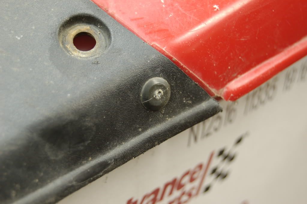

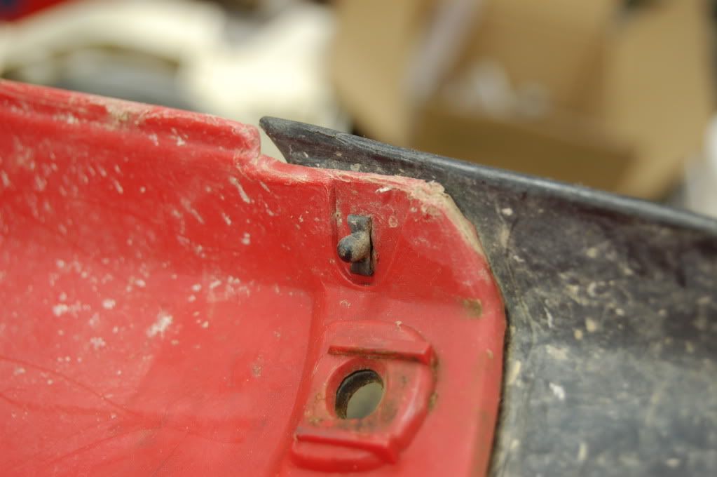

    I'm in the process of cleaning up the front fender on my 250SX. I'm removing the mud flap, and have gotten the three metal screws out (used the vice grips/vice/impact driver technique successfully).
    My question is regarding the two plastic rivets at the extreme edges of the plastic mud flap. They do not look like the reusable type. My concern is finding the replacement parts. I've checked the on-line parts diagrams, and they don't show these plastic rivets.
    Does anyone know the part number for them, or if they are available generically from the parts store? Here are pictures of the front and back sides.

    If you want a Honda part, look in the 86-87 ATC125m front fender microfiche. Number 20 and 21. It uses a slightly newer style plastic clip with a retaining washer. Those should work nicely for what you need.
