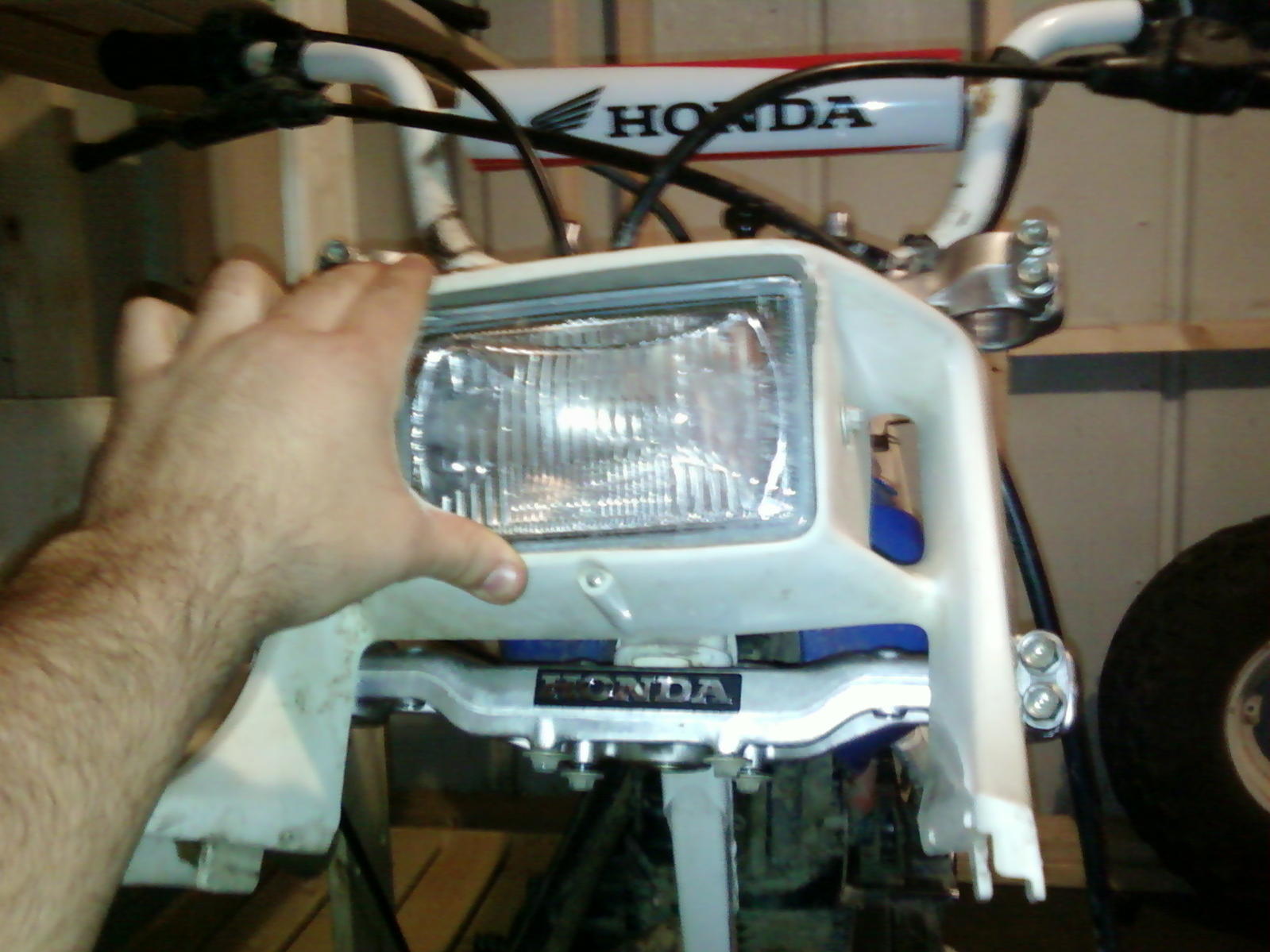

    Fitting the stock light shroud to the new 350x triples to check the fit.Click image for larger version.
    It worked out the the stock Fatcat fender and light braket bolted right up to the 350x lower triple crown, whereas I believe the 200x models mount a little different.
