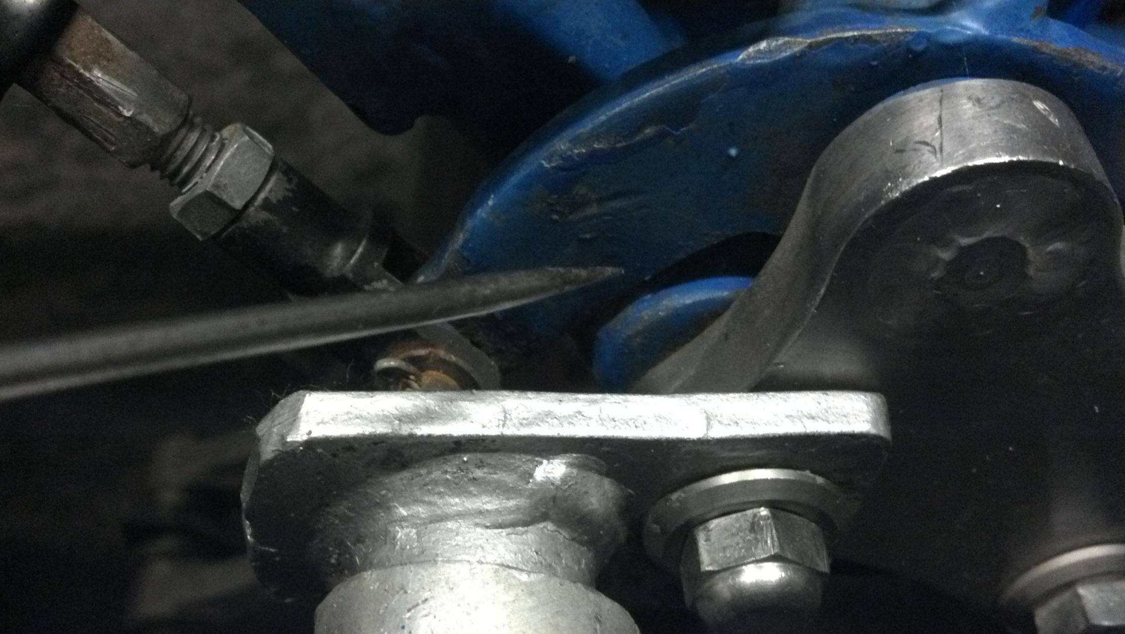

    Hey guys just wanna make your upgrade easier..you must!!! center punch directly behind the bolt hole on the top hole and Drill a hole.To allow for the top bolt to fit.Picture 4-6 you need to keep your weld to a MIN on the brake side,,, as you can see on pic 4&5 it didn't allow for the brake peddle to come up level with the peg. Pic 6 is a modified brake lever to allow plenty adjustment. take your time welding these on.. placement means everything!
    dont forget to weld up all holes in the area.. even drain holes..
    also there is a top and bottom.. the longer side is the bottom!!!
