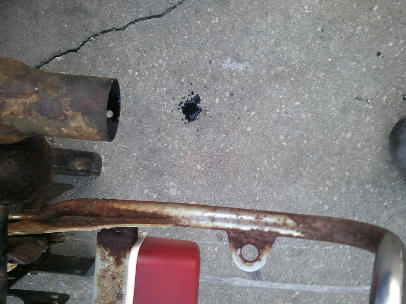

    Got her running pretty good today! Got the old milkshake out of the trans with some ATF, and some new oil put in. Everything worked like a charm, except I have a busted seal somewhere in the exhaust side letting the oil out the exhaust. I really don't plan on splitting the case anytime soon, & obviously this is not ideal, but other than watching the trans oil level, is there anything else I should expect? My trans case says 750 ml, but when I pour in with the fill level bolt out, the oil almost immediately runs out of the fill level bolt hole, should I measure out 750 ml & pour in regardless of the oil full level? I do have a silly question, I got a small inline gas filter from AutoZone but the thing didn't have instructions. I'm assuming that the filter goes this way, so you can see the trash on the outside of the filter & know when to change, but once I put it on the carb poured gas out of the bowl overflow like no tomorrow. I believe the carb is clean, but going to clean again tomorrow regardless, & there has been clean gas going in the whole time, the filter was just cheap insurance.

    I'd like to see a pic of this oil leak as well. You've got me a bit confused on that one.
    The oil may be blowing out of the level check-hole before it has a chance to settle into the rest of the transmission. I'd fill it from empty with 750ml and let it sit for a bit before checking it again.

    Those were 2 questions, for the trans oil fill level, I'll pour the oil in & let it settle longer before checking the fill level with the bolt. As far as the oil leak thru the exhaust, here's a picture of it, this was before my axle bearings came in, so its an older picture where the bike had just been idling & ran maybe 2 minutes. I didn't take any picture of the oil leak after I had gotten it up to temperature because I had to load up & get home quick. You can see the oil drip on the concrete below the exhaust.

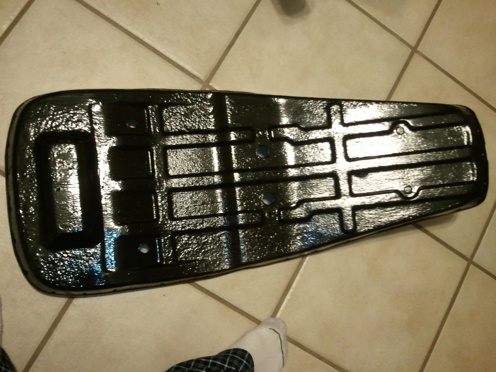

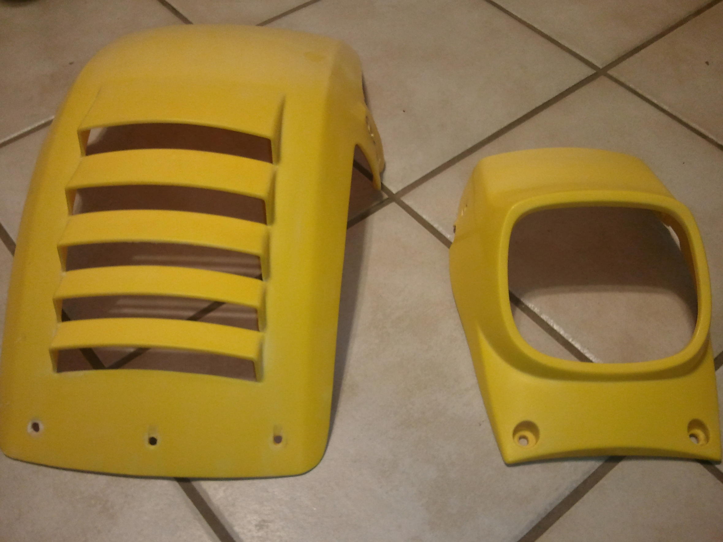

    Thanks Howdy for the offer on the rear fenders, I've stripped the fenders & am putting the finishing touches on the polish job. Right now I'm going back & getting the spots I was to impatient enough to get out up to my standard the first time! All that wet sanding has taught me patience if nothing else! I did have to get a new seat pan, which is painted & ready to go, all I need there is a new seat foam & a seat cover, & a new tail light now, my other one got busted somehow while I was riding Tuesday.

    Here's a few pictures of my plastics & seat pan. I've still got to put the finishing touches on the polishing job on the front fender & headlight cover, but the rear fenders turned out good. I've got the gas tank cover at work getting wet sanded when the time is right, I've still got to put the black stripes on it. Everything is basically ready, I'm just trying to decide if I want to get the oil out of the tailpipe problem solved. I've been talking to a coworker who used to be into dirt bikes & he knows a guy that works on the motors, but at $35 an hour, I don't really want to be into this little machine too much. I believe that since I'm getting 90 psi of compressions if I open up the motor, I may as well do a rebuild, but I'd rather get the 250R running. So far I'm only in $100 for cables, the seat pan, & all the little odd & ends. The oil leak is making the spark plugs foul every time its running it seems.

    That fuel filter picture just popped in, oops. That's also what the spark plug looks like after only about 15 minutes of running, dripping with oil.
