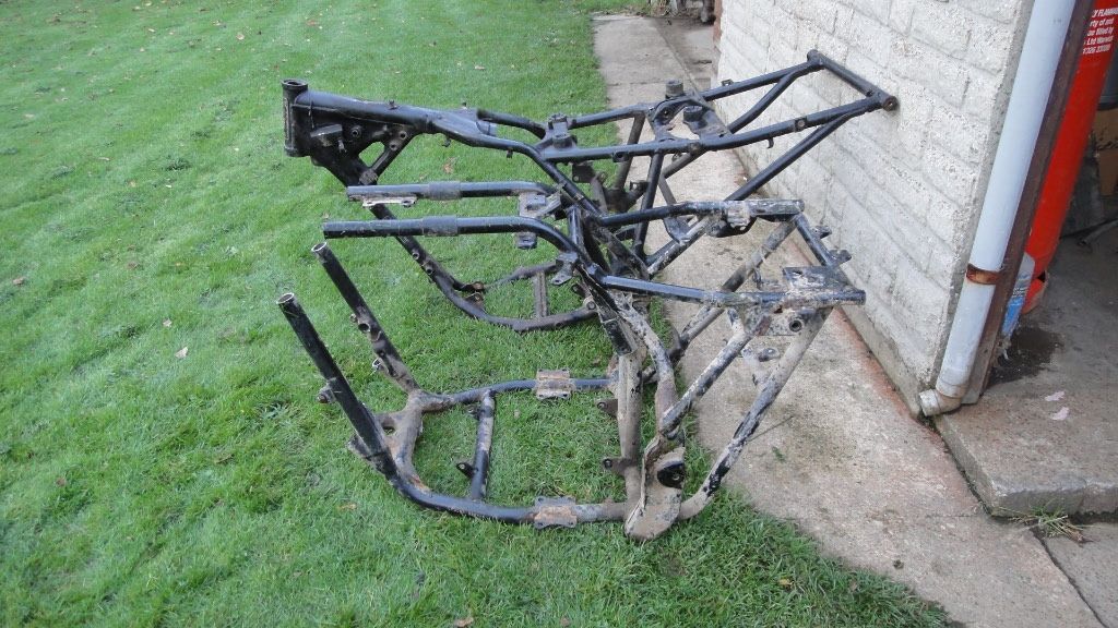

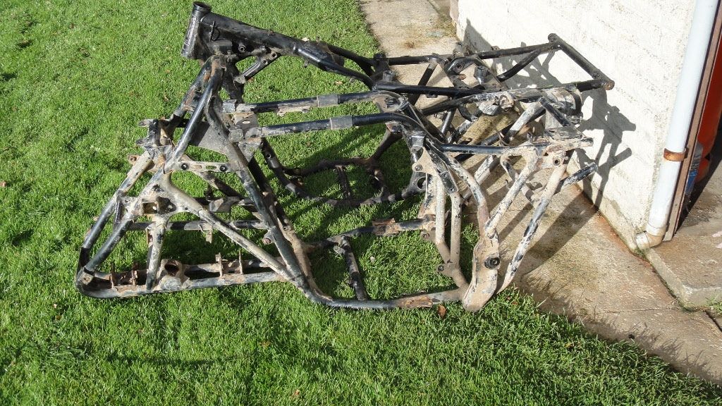

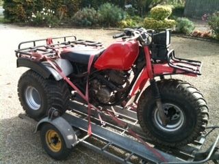

    Here is the 250es we are using, I will update this thread ASAP

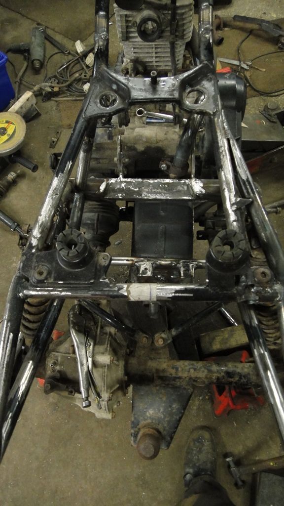

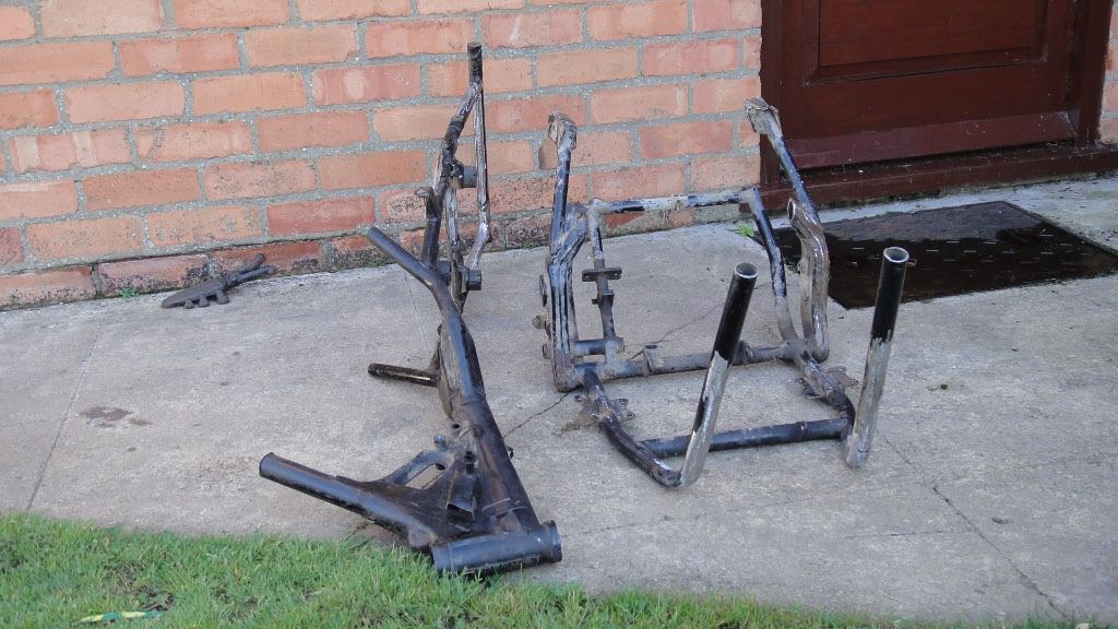

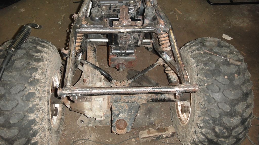

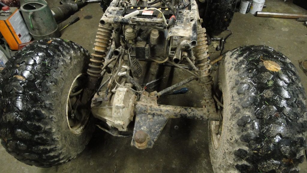

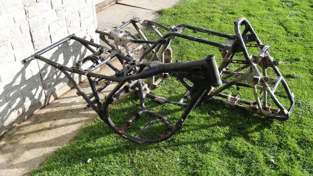

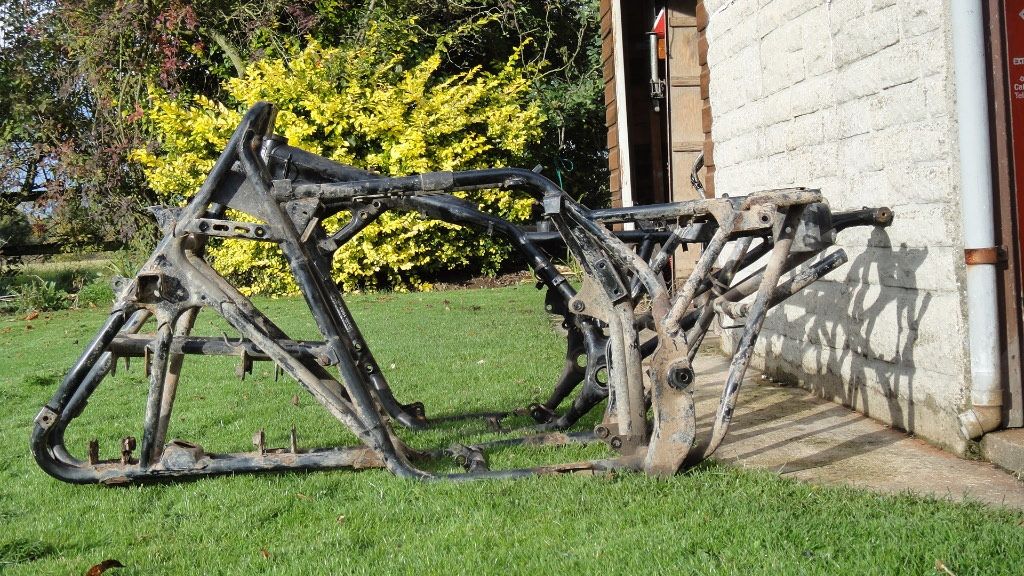

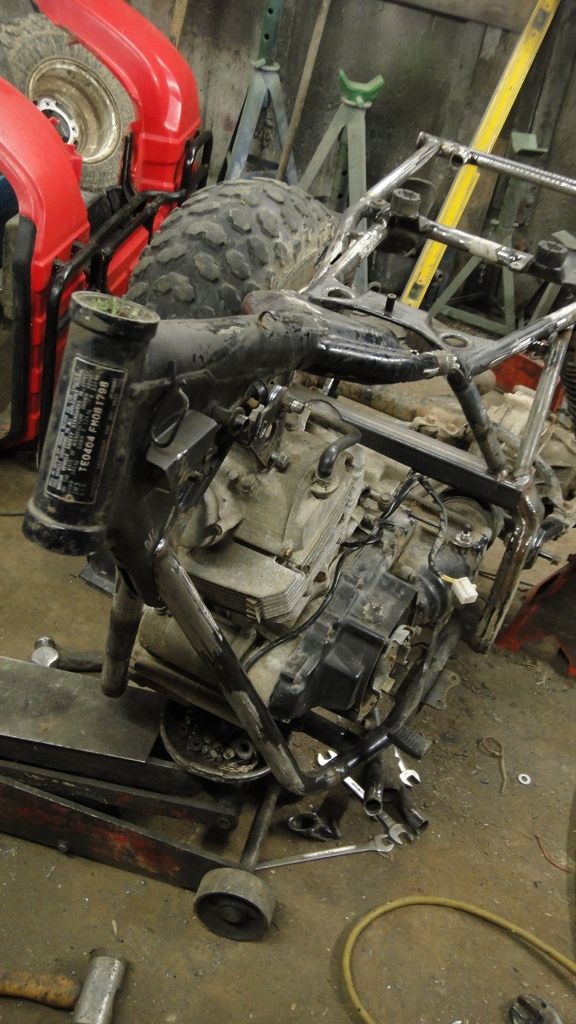

    Strip down, frame comparison and cutting:

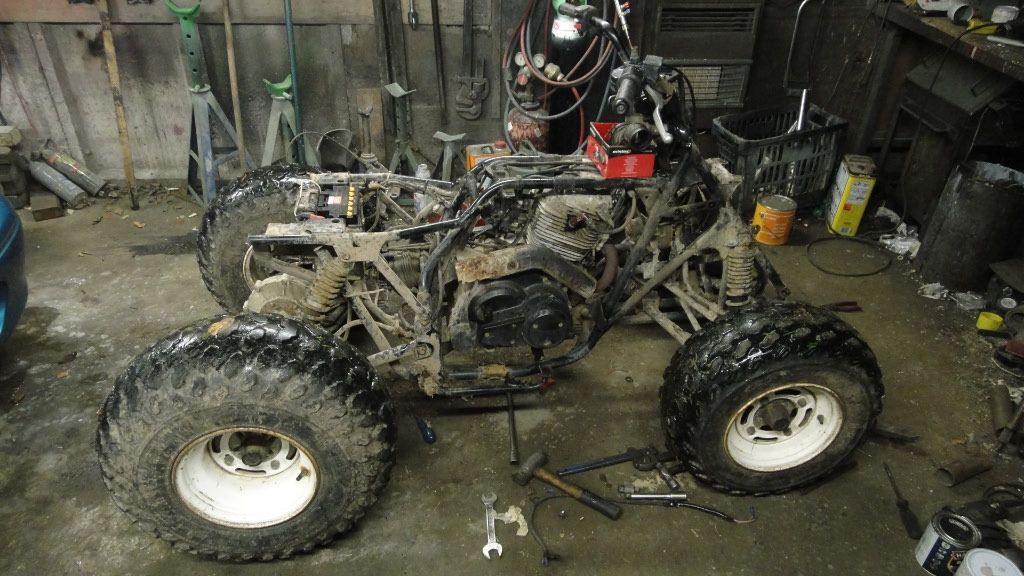

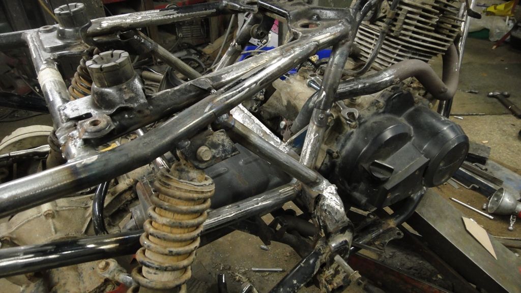

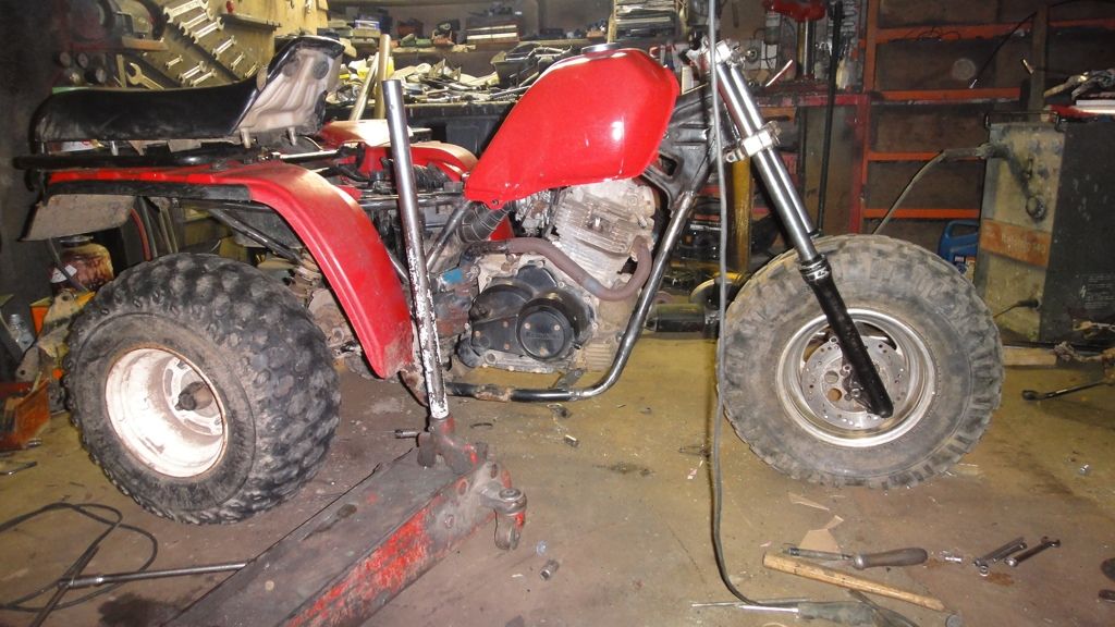

    These are the latest pics, should be rolling before long.....

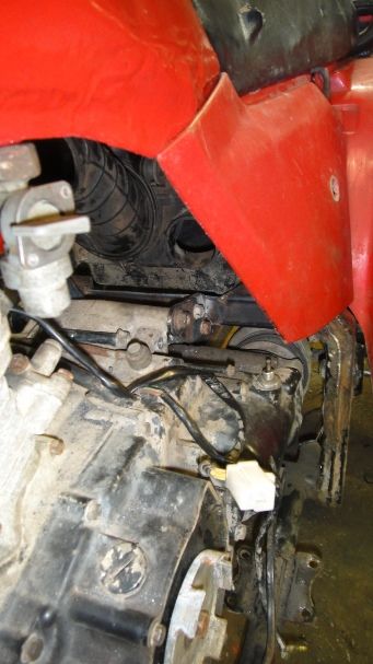

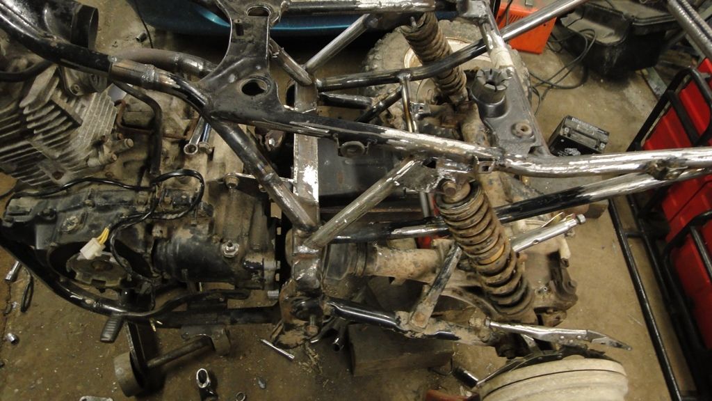

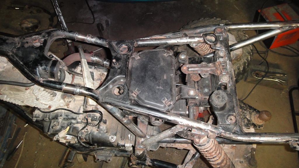

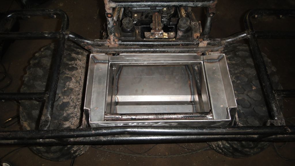

    More progress pics! Air box, battery box and exhaust mounted. Rear engine mount completed but the front engine mount is causing some head scratching:/

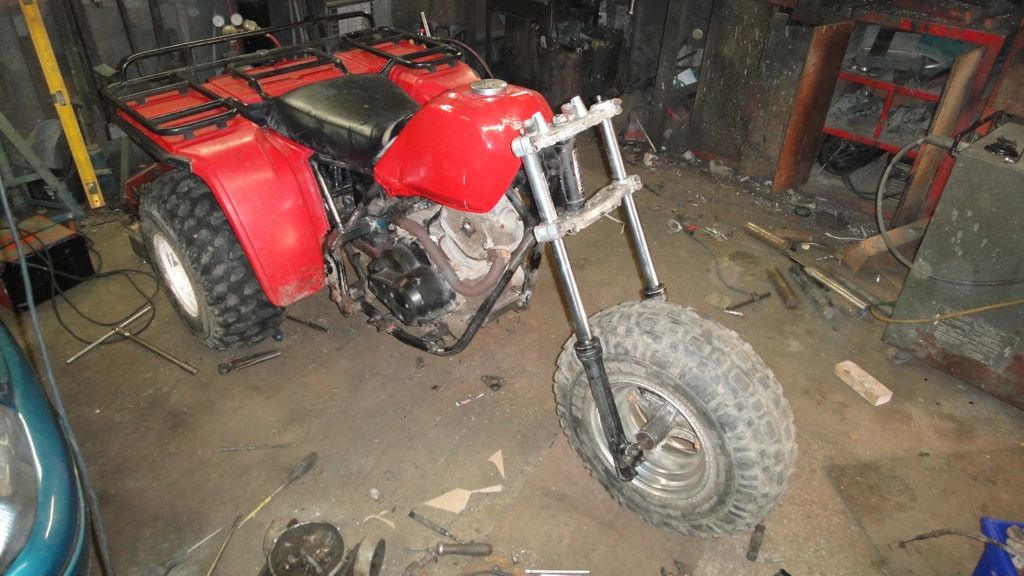

    Thanks for the comments

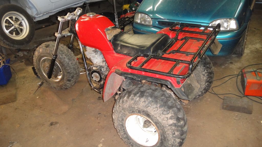

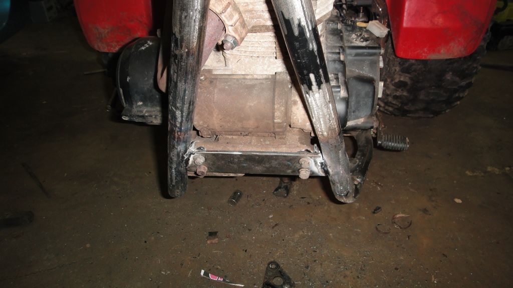

    Few pics from today's progress. I have allready told him the forks are the wrong way around, he thought it looked a bit odd!
    Front engine mount sorted as well, it's got to be removable so he can get the engine in and out.

    Pic with the forks the right way around

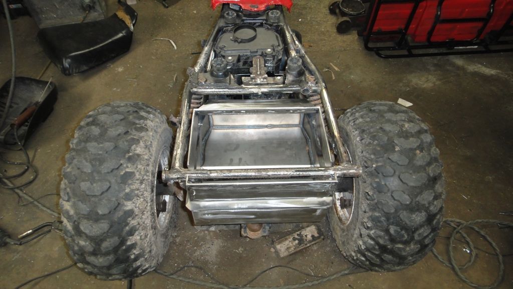

    Today he has been working on the boot/trunk. Because the frame has changed shape and the exhaust has moved
    the original ES one looked a bit small!!

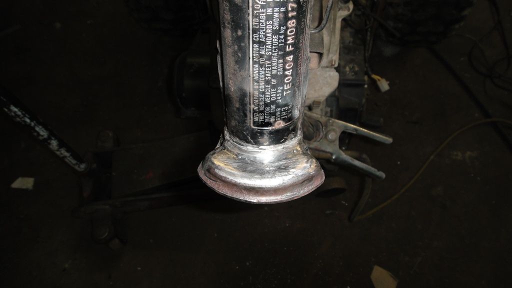

    Small update. Steering stop cut off the 200x frame and welded on the new frame
    Before
    After
