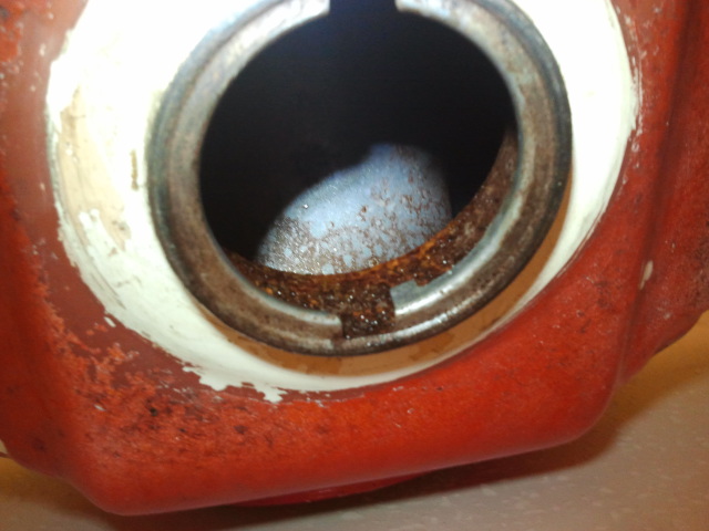

    Hey guys, I was thinking as I was cleaning my gas tank tonight that.. nobody seems to go for my "The works" method. I decided to show some people my results. I have had better results on my other gas tank. This gas tank sat for literately 30 seconds and the picture is the result of it. Look at how rusty that rim is compared to the other part. Not bad for 30 seconds. Let it sit for 5 minutes and i bet it'll be silver like new.

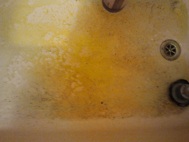

ID:	161226 Look at that rust as I poured it out into my bathtub lol. There was about 3x that after I put more water in and shook it. Tomorrow i'll throw some washers and what not in there.

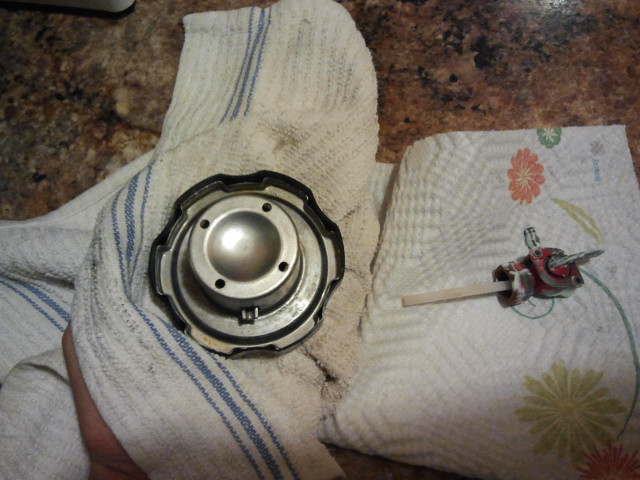

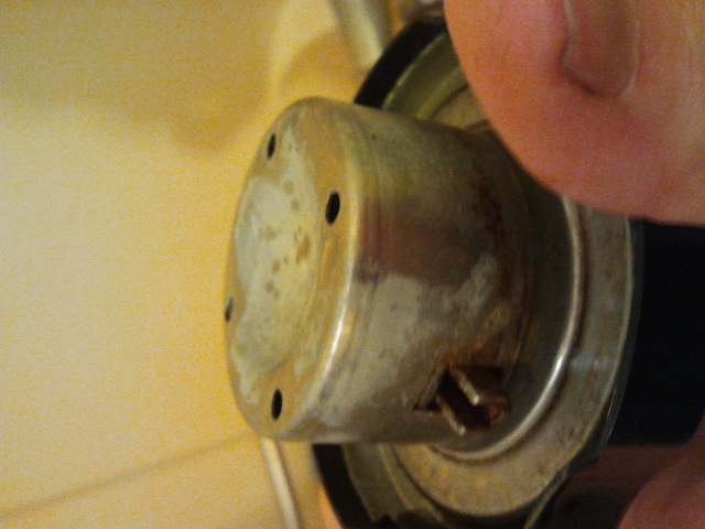

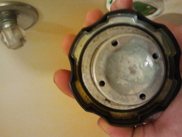

    Now onto the gas cap. The piece where I actually took my time with. I didn't get a pic of what it was before but I'm sure you could guess.. RUSTY lol

    Well I let it sit for 10 seconds and most the rust just fell off. After 5minutes the last picture was the result.
    I know there are a lot of good ways .. i.e. coke, vinegar and im sure more than that but I thought i'd show my favorite way. I only used one bottle for everything you saw there. Inside the gas tank most of the rust came off and most is weak enough to come off with a splash of water. One bottle is like $1.27 at walmart. I was in my bathroom for maybe 20 25minutes working on those.

    It works great on bolts to but if you do it TO long for things like that it WILL take off the paint or whatever it is and it'll be a weird dark grey color and rust after awhile. My gas cap, tank will be fine though so don't worry about things like those.
    MAKE SURE YOU RINSE WITH WATER right after so it stops the reaction. Don't let it touch any rubber seals. It didn't even take the paint off my gas cap to my surprise so that's good.
