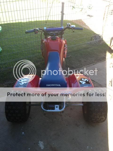

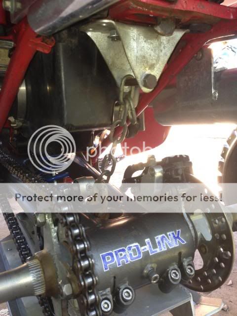

    I managed to knock a few more inches out of the height today.
    I didn't use a pull strap, I used chain. It still has about 2 inches of travel so it's not rigid.

    Hello Forever Three Whee
    “I managed to knock a few more inches out of the height today.
    I didn't use a pull strap, I used chain. It still has about 2 inches of travel so it's not rigid.”
    As previously mentioned by another member, tying the bike down is at the very least, not the proper way to do it however since it is done I must say that at the very least it looks better than using a tie down would.
    I suggest 1 additional thing in case you haven’t done it already which is to lower the front of your bike as much as you lowered the back or simply try it with the front 50 mm higher than the rear as it appears to be by amount of fork tube sticking above your top fork clamp in the photos and if it does not turn or slide easily enough coming into the big sweeper turn then try lowering it 25 mm then another 25 mm max if necessary to achieve the best turning effect.
    Lowering the back by 4 but the front by only 2 slowed your steering down. This makes it more stable at high speeds but causes it to turn or respond more slowly to steering input. Lowering does exactly the opposite.
    High front is good for straight line high speed, low front is good for quick turn on tight trails at low speed etc.
    Hope this info helps.

    All your info has been helpful and I do appreciate everyone's input. Because the track is so big and fast with really long corners I'm gonna run it with the front as is and if need be then change it as you suggested.
    I wasn't real keen on the idea of a strap because the fear of it breaking and catapulting me over the bars at 100kmh far exceeded the ease in which it would be to fit. Lol
    See that metal thing up the top bolted to the frame...... That's a shopping cart wheel holder. Lol
    Good, nice to know you will be able to come back with a ride report, lol
    xxxxx
    It might have been only 95kph, lol.
    xxxxx
    No it’s not, now repeat after me, “It is a dolly wheel I bought from the swap meet ergo no receipt Mr. Missing Shopping Cart Investigator/Police Man Sir!, lol

    Ben ,You want it as low and wide as you can get it. My 81 250r flat tracker is 51 inches wide in the back.Also you may want to lower the front alittle. If you have them get 18 inch rears and gear for them.If you dont have jumps you should do great.
    Cheers, yeah the axle is a lone star + 4 I believe and then I've added an extra 2.5 aswell to the right side (there's only left hand turns) I've got 13/36 sprockets and 18 inch tyres. No jumps either.
