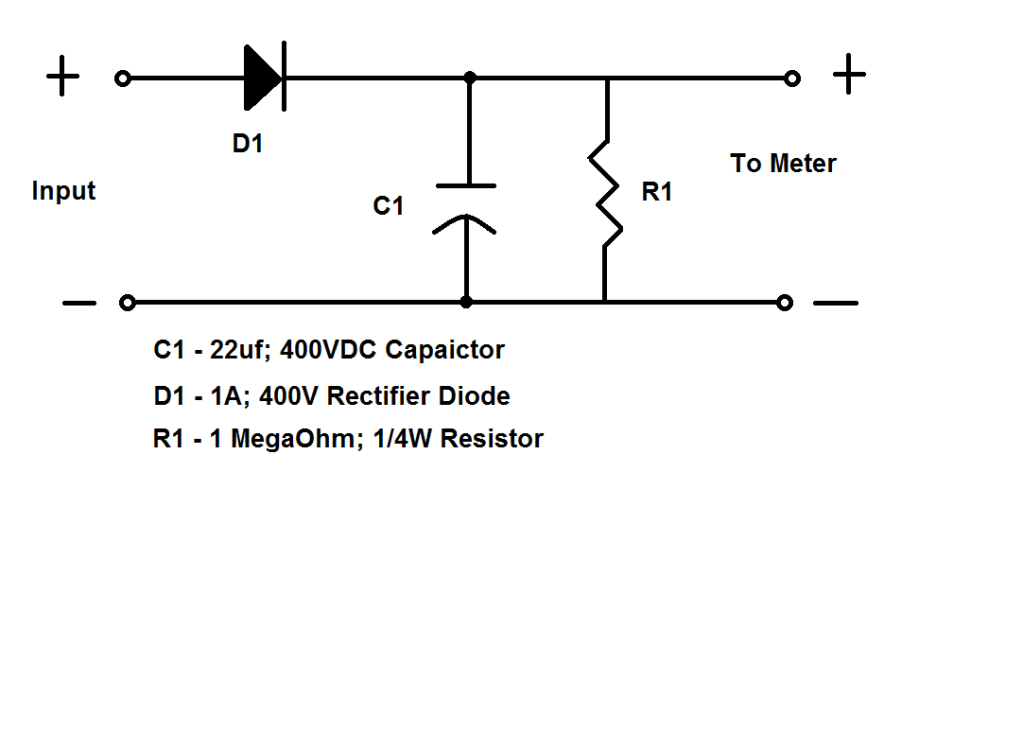

    As for measuring the output of the CDI, thats tricky because its pulsed to the coil. You can get a peak reading voltmeter but its not cheap. You can also buy a DVA but also not cheap. What i did is built one! A piece of perf board and a project box from Radio Shack along with a few components is all you need. I found a schematic online on another forum where a guy was talking about needing to troubleshoot the ignition system on his dirt bike a few years back, i did save the picture from that forum. Here it is...
