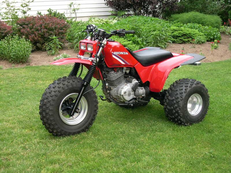

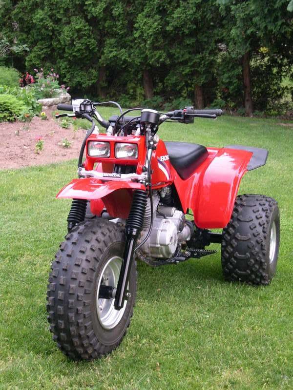

    POS250SX I live in Lockport. Where are you at? This is my 250SX. I absolutely love the 200x front. It makes the SX that much more of an awesome machine.

    Look at that SUPERTRAPP!!

    I must say Honda250sx you bike looks AWESOME i love it, i want to put a 350x headlight on my sx as well, what do you have to do to the wiring, anything?
    or do you have to splice it?

    Wow thats a sexy machine. Im on transit road. My trike is real ugly especially compared to yours lol. My forks are LONG they are off a dirtbike, but they ride real nice i love um. Ill go take a pic and post it up, maybe u guys can tell me wat ya think about my forks.
