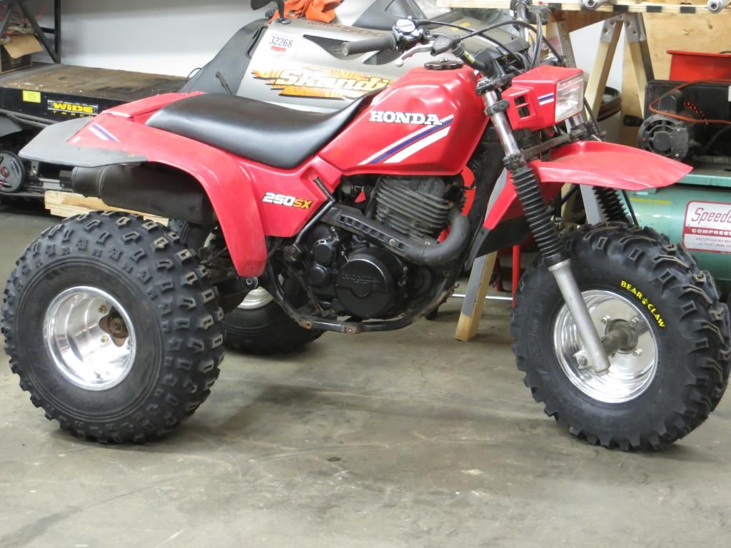

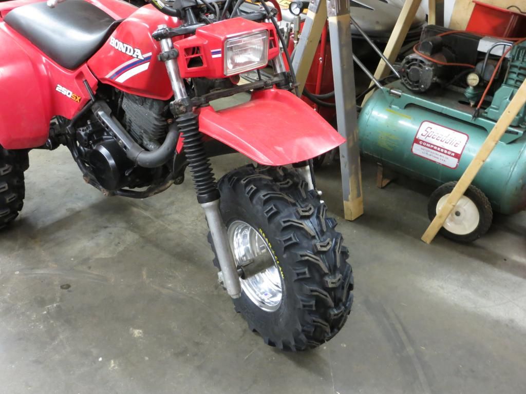

    So I was doing some more experimenting with rim fit for the SX..I found a rim that is a perfect fit for the trike without the need to spacer to get the offset right.
    Anyone wishing to improve the look and handling of their machine can use this with good assurance of fit and visual appeal..
ID:	170993Click image for larger version.
ID:	170994Click image for larger version.
ID:	170995Click image for larger version.
Name:	full trike.jpg
    This is the one I bought from Rocky Mountain ATV and it cost around $100 shipped..
    Rim: 4/110 ITP Steel Wheel 10x5 2.0 + 3.0
    Tire: Kenda Bear Claw ATV Tire 23x7-10
    Of course you can play around with any 10" tire that suits you, but this a great way to get some selection because the 8" tires are scarce and don't offer a lot of selection.
    Front end swaps are a pain and finding a decent 200X or other front end from a scrap trike is difficult..this way is pretty economical and make the SX a totally different machine to operate..
    Have fun with it..!!
    Oh yeah, mount your tire with as a right side tire to get the directional tread correct.

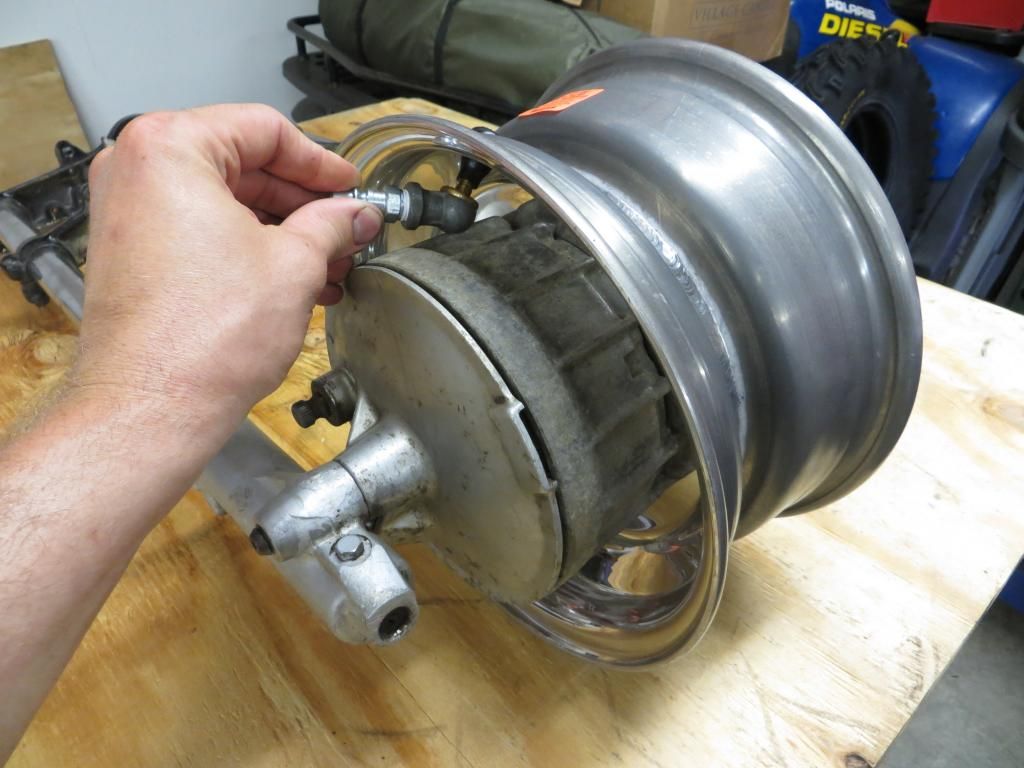

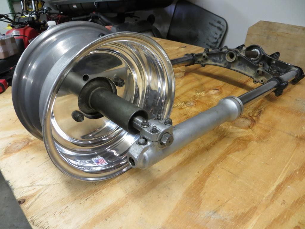

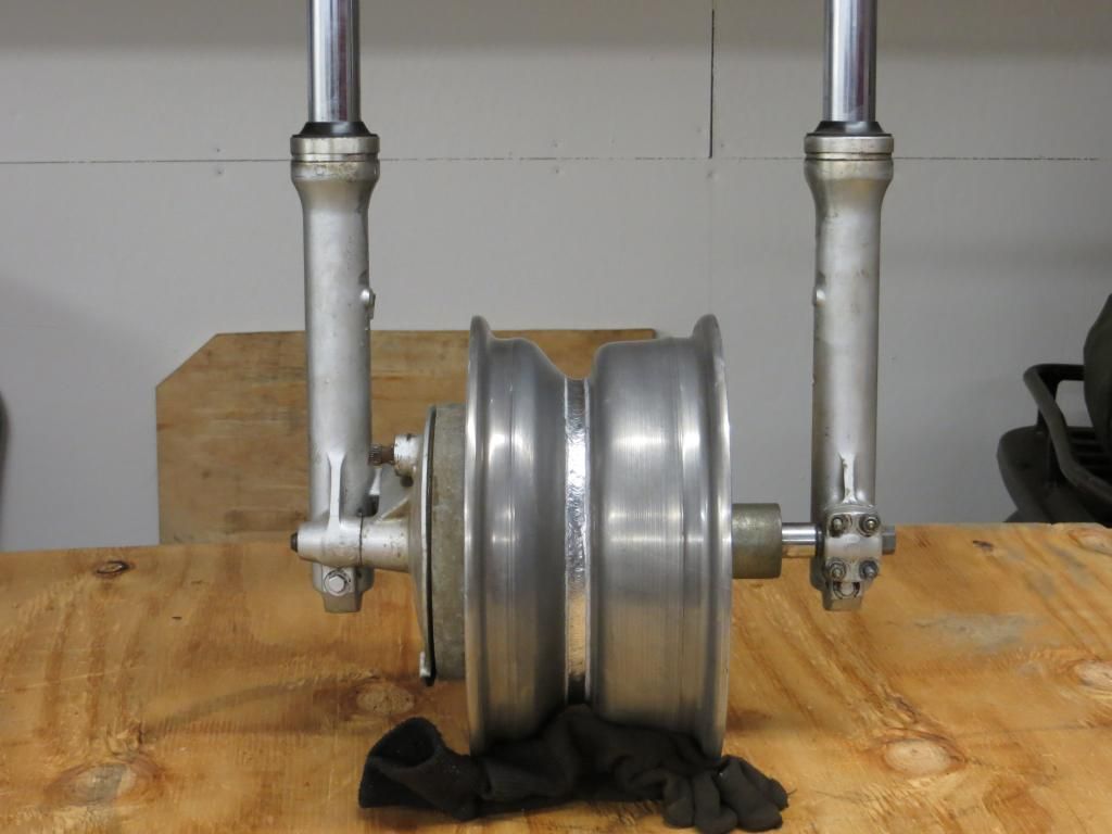

    Nice post Doug, This got me thinking, so I ordered the same tire you did and then this:
    http://oemcycle.com/Item/product/900040822 for the wheel. I mocked it up with spares and found I had to mount it as if it were a left side wheel with the air stem on the brake side, but it worked out nice. Spacing was balls-on.
    Yup, air chuck fit in fine with the rubber stem the wheel comes with, air gauge is a different story- have to get a pen style gauge.
    I thought I'd be a superhero and asked the tire guy if they had a stem with an angle to it, maybe a compact design- they did and I held it up to the rubber stem eyeballing it and said to put it in. I can still get my air chuck on it, but if it were any tighter fitting, you couldn't get air into the tire. So if you're considering going this route, be happy with the stem the Douglas comes with.

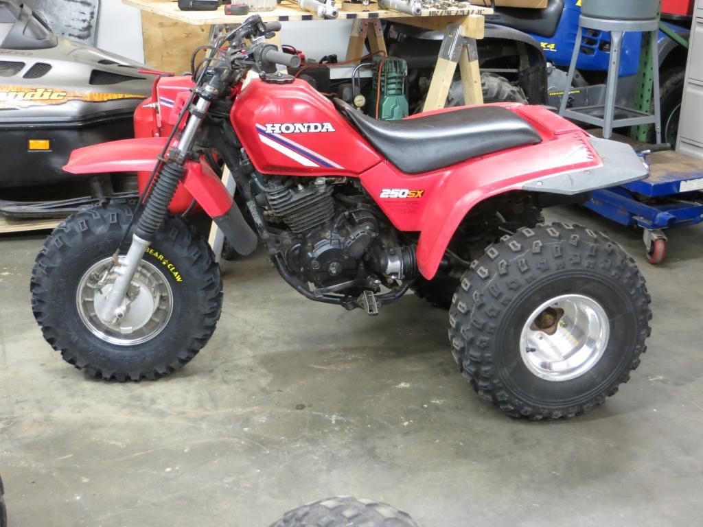

    And finally, the money shot:

    Looks nice 'Dave Little'..you can swap out the rim to any style you want. That is what is great about the formula I found..but.
    You ordered the '3+2' rim..if you ordered the '2+3' rim it would have fit as a right and had the valve on the other side.

    It sure is! I kinda like it on the brake side, stem is well protected. Just wished I'd stayed with the rubber stem, more forgiving.
