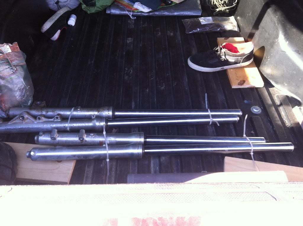

    Pulled a set of 350x forks and shock to take to Suspension 101 for rebuild. Aside from being pretty stiff, the tubes had pits, so they needed to be replaced. I grabbed a set of 83/84R forks with good tubes and internals to swap in. It wasnt until I set the two X forks on the ground next to each other that I noticed the one fork was 6in shorter than the other. Hmm... Maybe that's why they were stiff.
    the 83/84 250r fork tubes are the same diameter (35mm) and length as 350x fork tubes and will swap right in. You will need to use the 350x fork bottoms to retain the leading axle and dual piston brake caliper setup. Also, I've been told that the 250r internals inside the 350x bottoms will offer more travel. I cannot confirm this. The 83/84R forks I took to suspension 101 for this project have a terry kit in them. This terry kit will be going into the 350x bottoms. We'll see how that turns out. Should work well with the 10in wheel procured from Xowner
