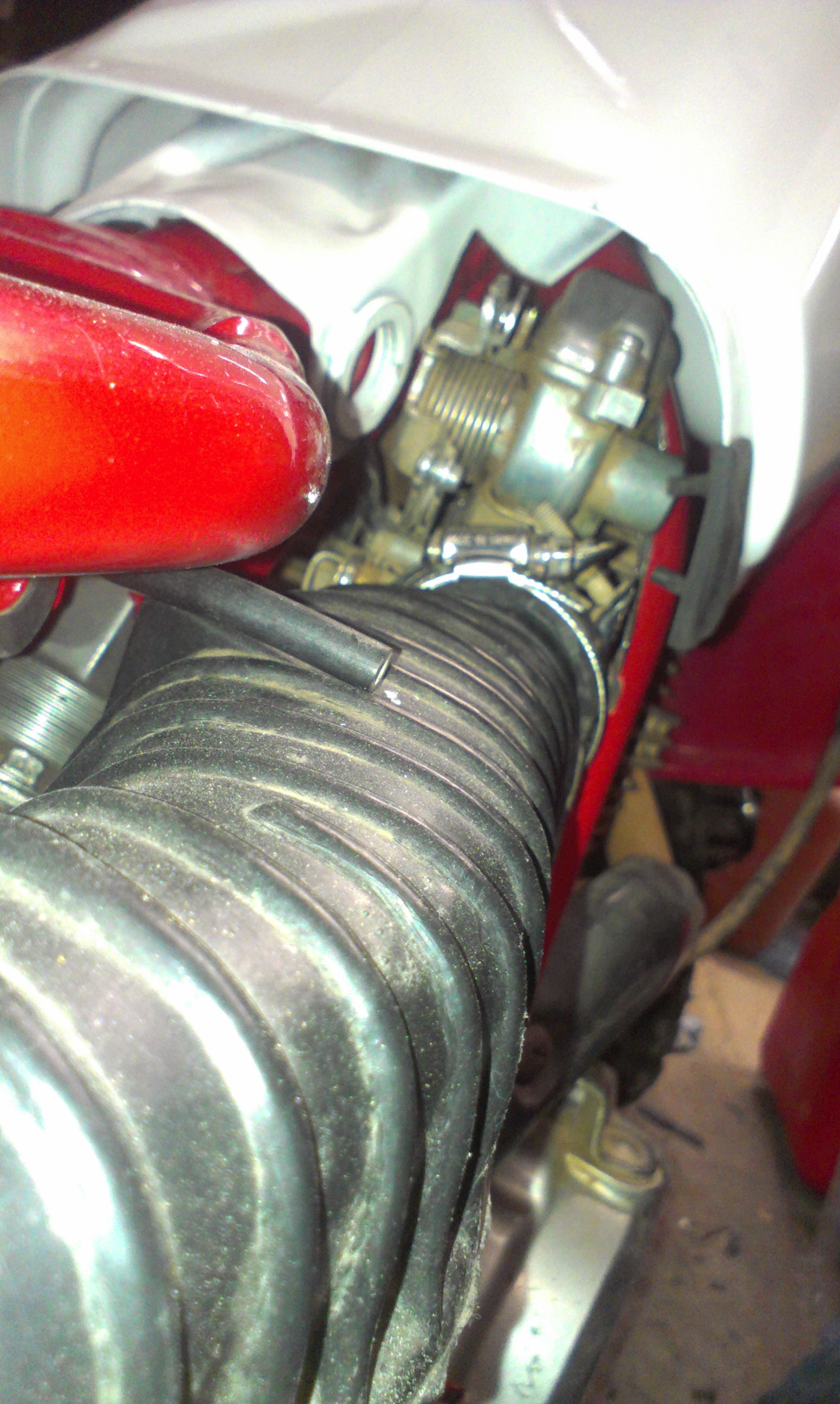

    So while back I bought a 200x with a blown engine and for some reason I always wanted to put a crf 230 engine into it, I liked the idea of an electric start and a bit more cc's. I found a complete running bike for a decent price so I bought it, engine smokes a bit but ill be fixing that.
    So fare I have the engine and carb in the frame and the carb is attached to the stock air box. I had to trim the frame to fit the carb in the frame. The motor bolted right in except for the head motor mounts. BUT The chain was way to close to the side of the frame, hardly 1\16, so I moved the whole engine to the right by 3/16, which was as much as I really could, now I have about 1/4 which is still close but alot better.
    Also, I have a 10 inch rim up front, something I modded!!
    Heres a few pictures, Ill keep updating you guys if your all interested! lol

    Got the gas tank to clear the carb today. Its a tight fit but its fits!

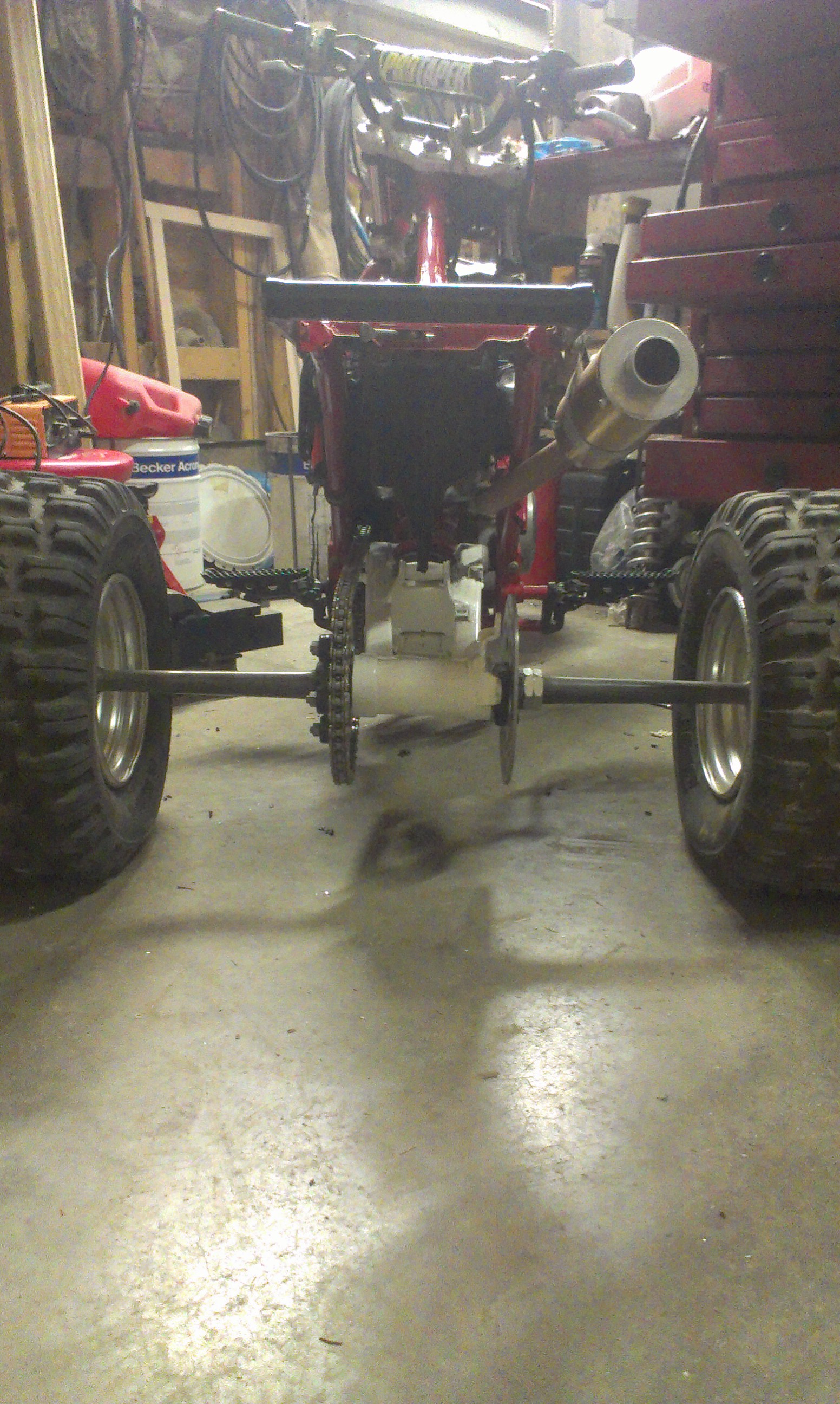

    sweet build!!! how close are the drive sprockets lining up?

    Wen I eye it out it looks good, haven't got a chain on and adjusted yet.. I just ordered the smalles front sprocket I could get for the crf. Wen I get it its the first thing Im gonna do.

    Past couple days I finished up the battery box and a bracket to hold the solenoid, happy with how it turned out!
    It still turns and still has spark
    Before I started it up I wanted too clean the gas tank nicely, didn't have time for that yet.
    Also put the chain on, as fare as my eye can see it looks good!
    Can't wait to try it out!!
