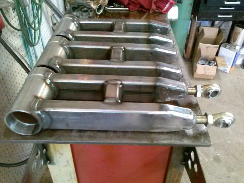

    last week I decided to start on a new 70 project,, well something from my past told me to do it 3 times instead of one,,,, so I am building 3 70's
    here is where we start SWINGARMS,,, yep suspended 70's its a big bite, but I am up to the challenge, first frame will be+3 then a +2 and standard length for the third one.

    well here it is compared to an A+ frame.. frame is 3 inches longer and the swingarm is 2.5 longer,, I am going to make the backbone .75 higher to help with carb clearance problems that are common with all these bigger motors,,, should have a roller soon...

    Hi Kasey, looking good. I had the black PK at trikefest last summer. What is the shock you have on it?
    1,775
    Looking good my question is how much of a pain is it going to be to adjust the chain. Any way KEEP up the good work

    Whats the plan for the forks ?. I've been wanting to build a set of tripples for mine, but just don't really know what direction to go with the forks.

    I think it will be a little bit of a pain.. but I HATE SKATEBOARD WHEEL CLAD SISSORS FOR CHAIN TENSION,,,, besides buy good chain,, and on a 70 you won't have to adjust I much anyway

    BOB for the first 3 I have very nice OEM Honda xr80 forks these came off some real low hour machines .. from there I have a supplier that can get almost and forks,, so it
    probably will depend on price ,,,
