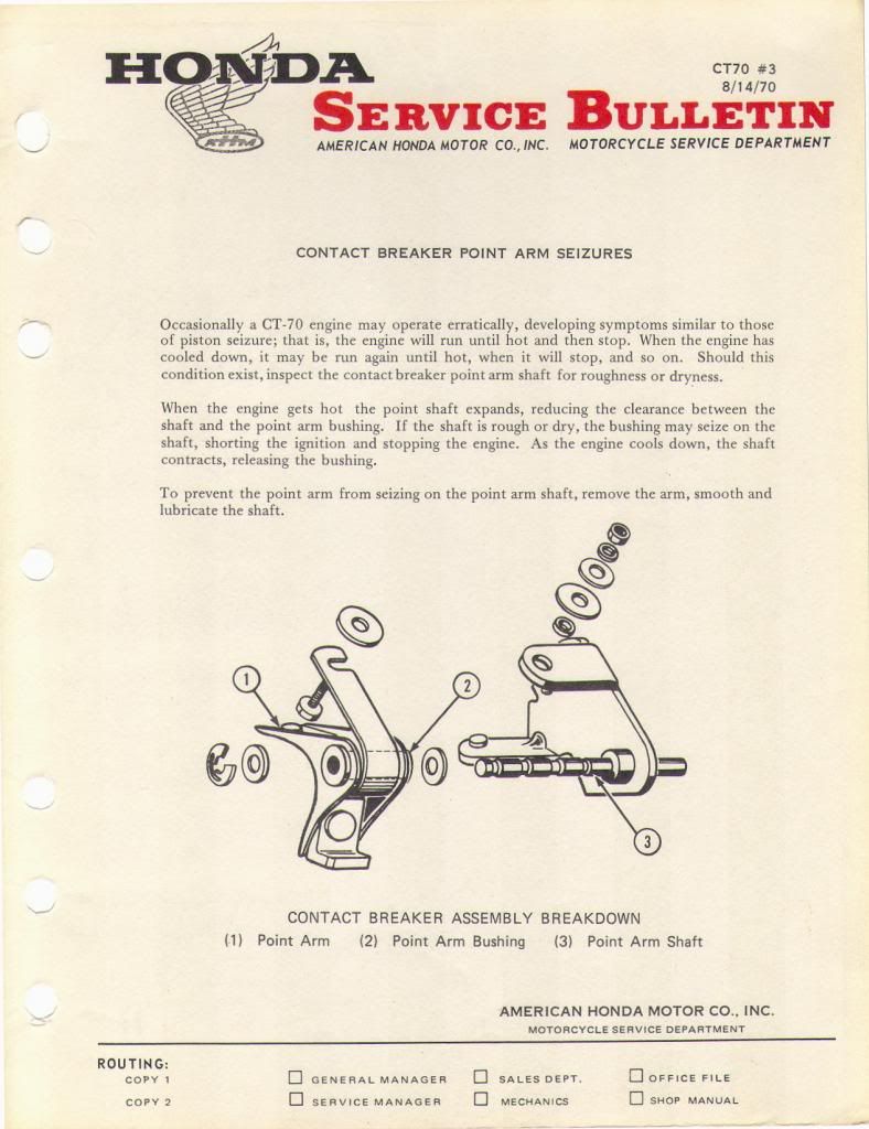

    NOTE: This next bulletin is for the CT70. However, it has a tip regarding the points sticking open when the machine is hot, giving a difficult to diagnose situation. It seems appropriate to include here since the ATC70 uses points as well.
    CT70 #3, 8/14/70

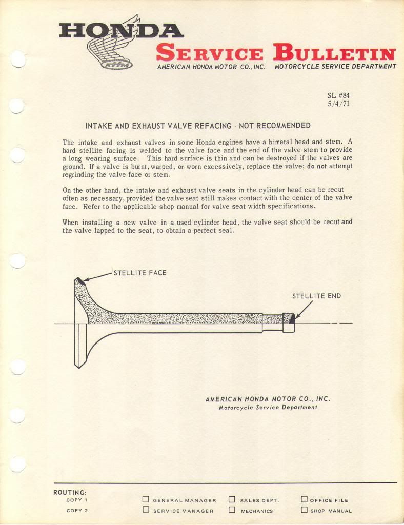

    SL#84, 5/4/71 - Valve Refacing Not Recommended

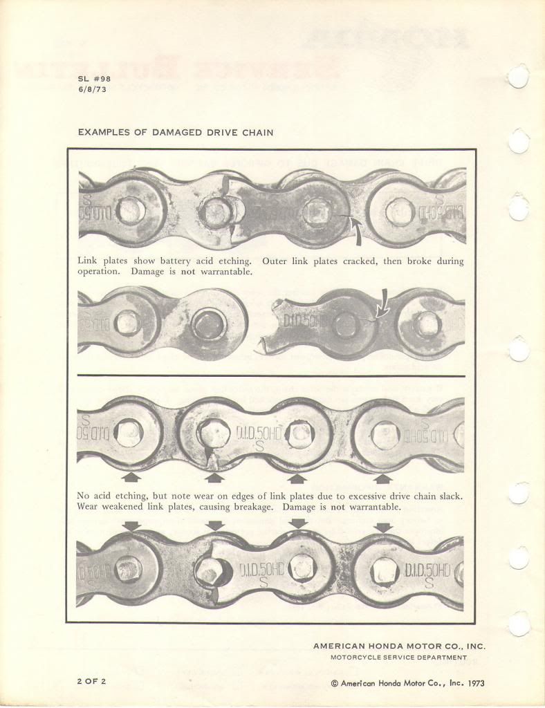

    SL#98, 6/8/73 - Chain Damage Due to Improper Battery Vent Tube Routing

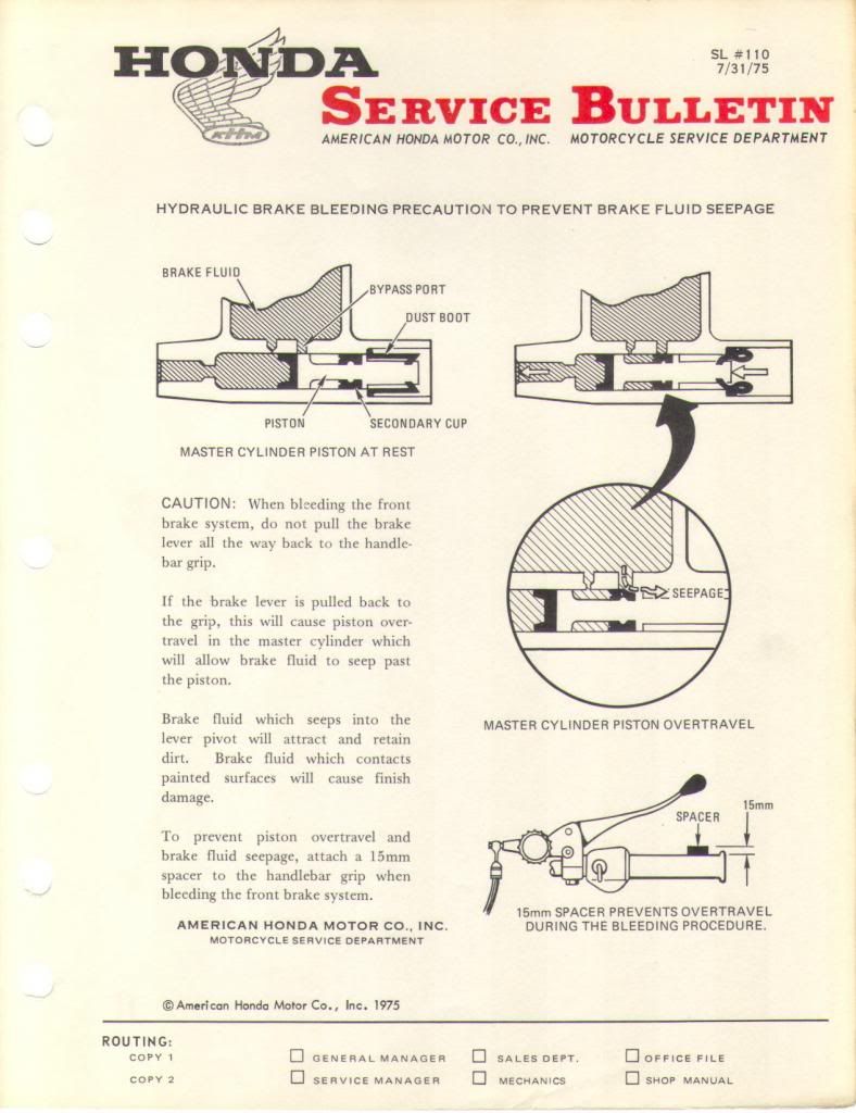

    SL #110, 7/31/75 - Hydraulic Brake Bleeding Precaution (NOTE: Why you don't want to pull the handle all the way on some masters...)

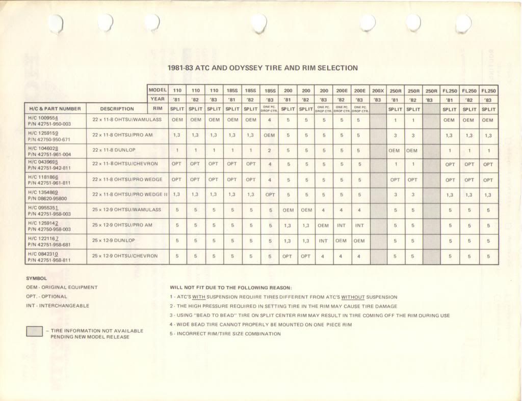

    SL #137, September 1982 - ATC and Odyssey Tire Interchange Chart
