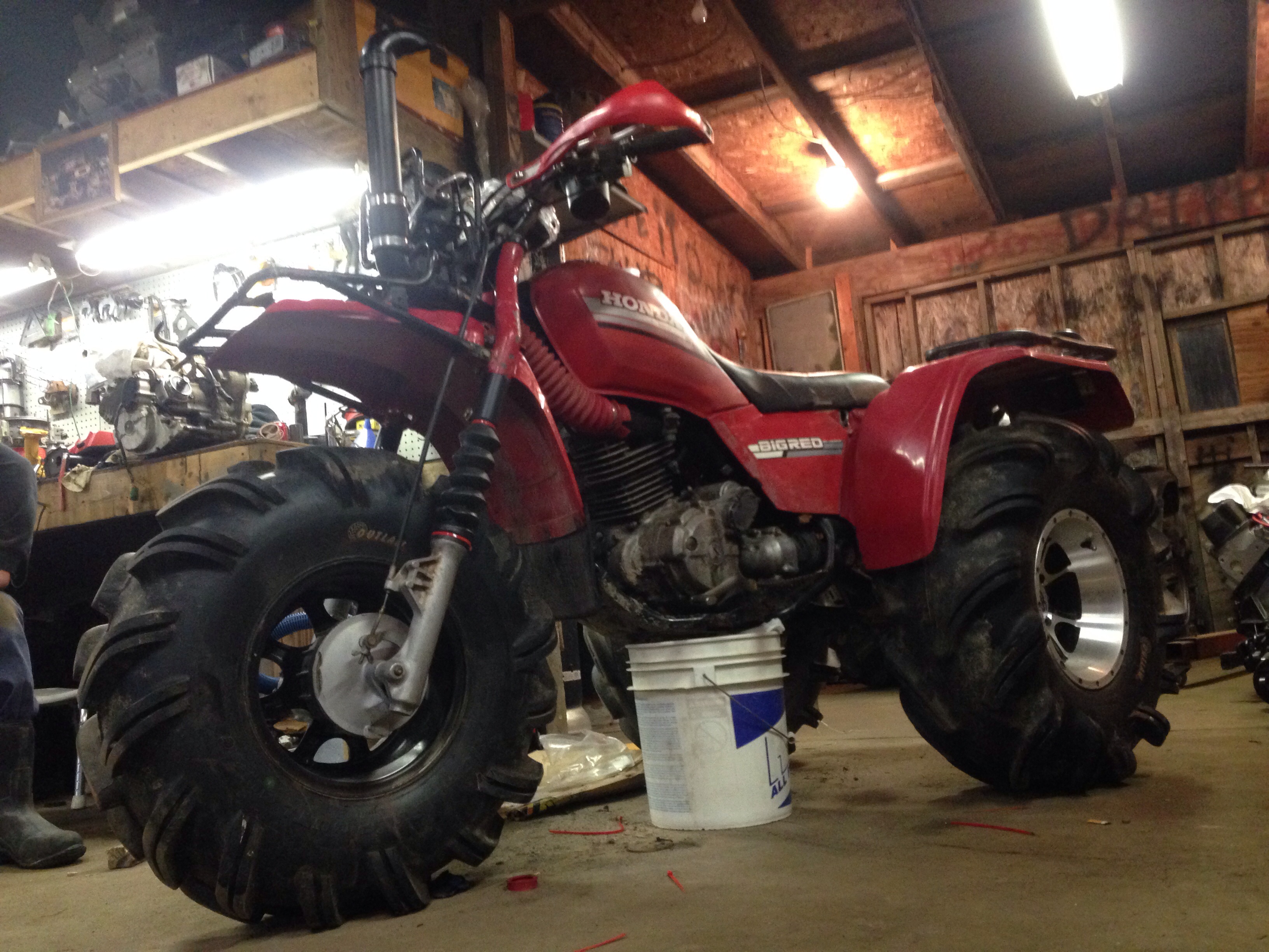

    I have started making bolt on lift kits for Big Reds! I only make it for the front, it's totally bolt on with no fabrication to install. It's a fully machined piece that basically spaces the front forks 3.25". The pics posted is it installed on my big red with 28" outlaws and my home made bolt on rear lift of 1.5" from bolt hole to bolt hole and it easily clears a 5 gallon bucket under the motor! I have more info and pics on my eBay post.

    If you don't lift the front end, but lift the back and put on larger tires, you'll end up with an outrageous amount of rake, which will make the 3 wheeler handle funny and it'll feel weird when you sit on it.
    I ran 27x12-11 Vampires on a stock 250ES for a year or so, and they would get into the front fender more than I liked. I wouldn't run any larger than a 26" front tire without some kind of clearance modification.

    On another note, the your kit does look very well made, much more refined than mine (although I built mine in a hurry in about 2 hours lol). The only thing that worry's me a bit, is that the new fork socket looks to not be any more than 2" deep, which is an inch shallower than factory, and only clamps with one bolt. Maybe that's enough though, I'm sure you wouldn't try to sell something like this without plenty of testing to make sure it's good and stout right?

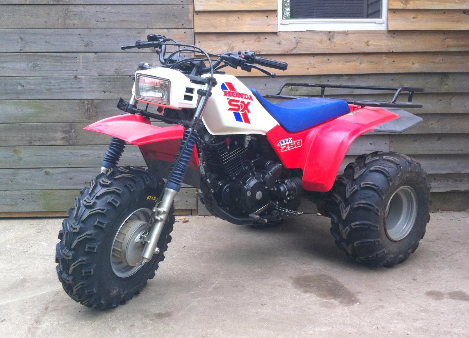

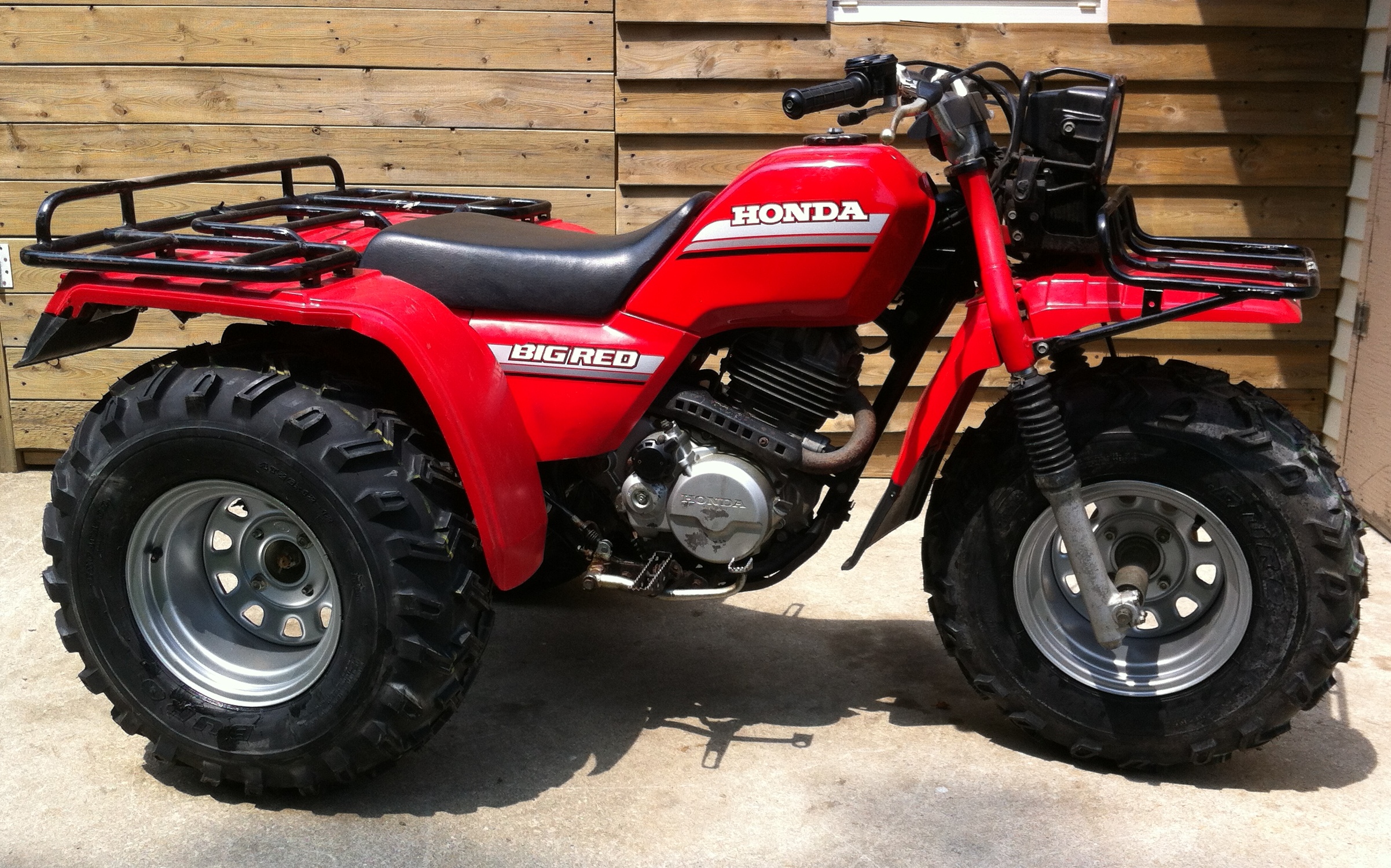

    I thought this is where we came to share ideas..
    So even if Trace did use your idea as a rough blueprint, if you didn't want that too happen you shouldn't have shared it.
    I sure didn't expect the idea about the front wheel swap on the SX and ES not to be tried by other members! That is why I brought my discovery, or rediscovery (someone else had already thought if it before and just didn't say anything)

    I happily share it and will give anyone the details to do it themselves..I don't make claim of ownership of an idea!
