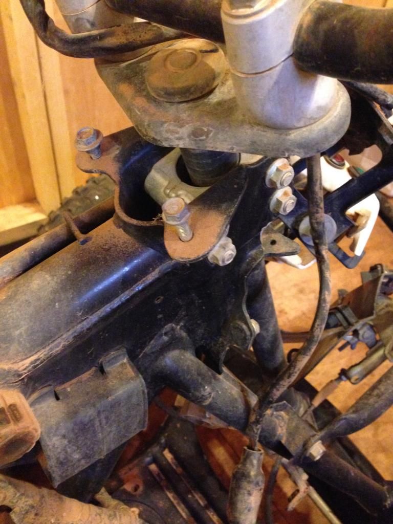

    here's where i think the triples might hit the gas tank, the front part of the tank looks like the triples would hit it, but not sure
    here's what the neck looks like with the steering stem gone, i will probably be cutting it out
