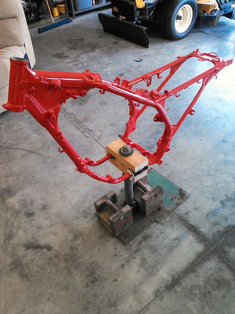

    Not a lot to see tonight...got a good stand to start work. Got new shock coming,swinger bearings here,chain guide,prm skid plate,decals for swinger.... Hope to have axle in and get working on front end in a few days...

    THat is a great stand you made.. Its looking nice good job!

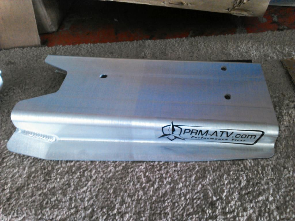

    Just ordered some westy swingarm stickers from mr. Clean!! Should have the rear together soon. Very impressed with the prm skidplate!
