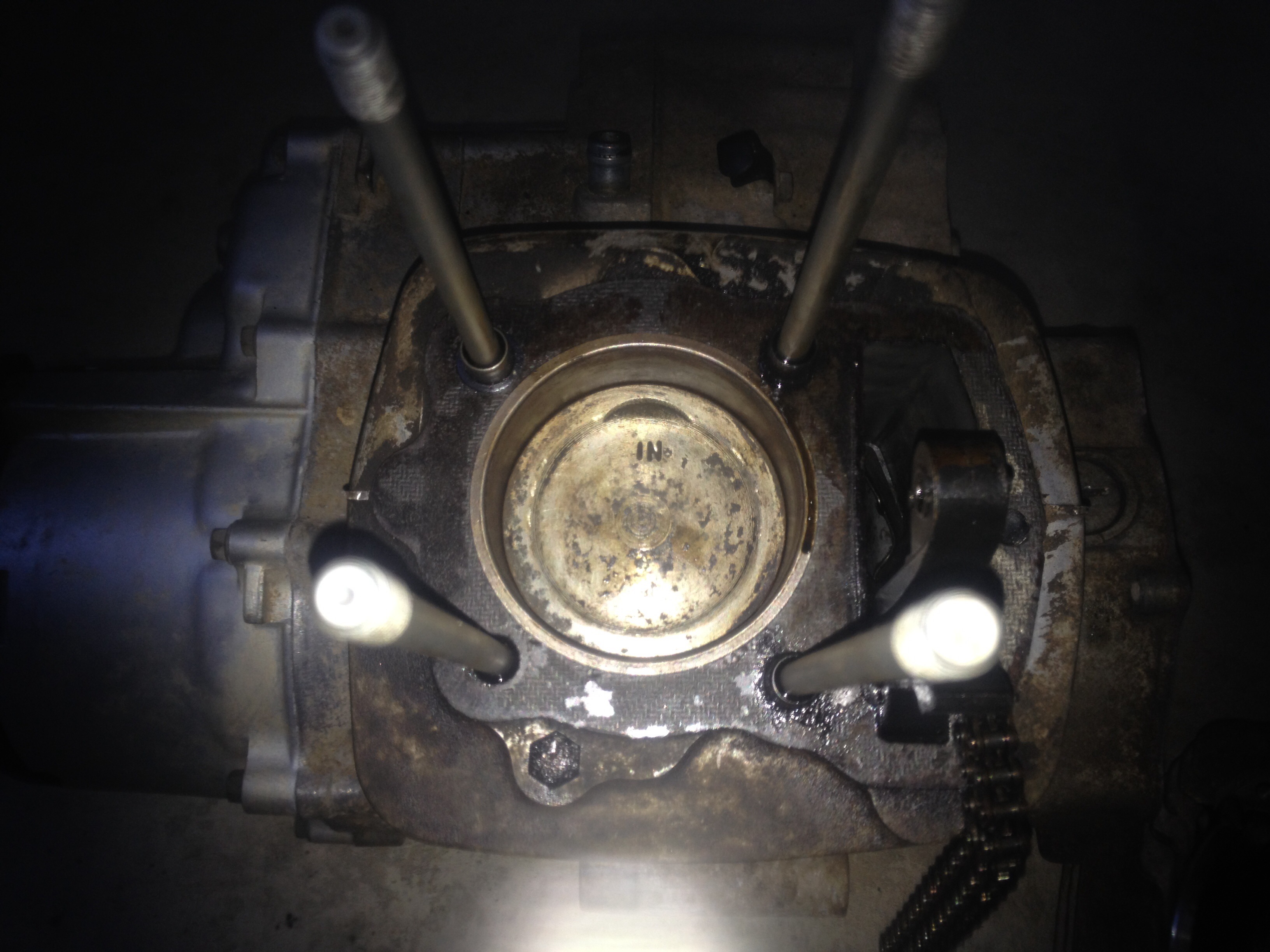

    Hey all,cracked it open & this is what I found...Click image for larger version.

    Oh boy thats a rebuild. Either it got swamped and parked or the plug was left out in the weather.

    yep you got that right, plug was left off for some time, it wasn't as bad as first thought,I gave it a good clean up , the piston moves now easily,and the valves move and seat correctly, Click image for larger version.
