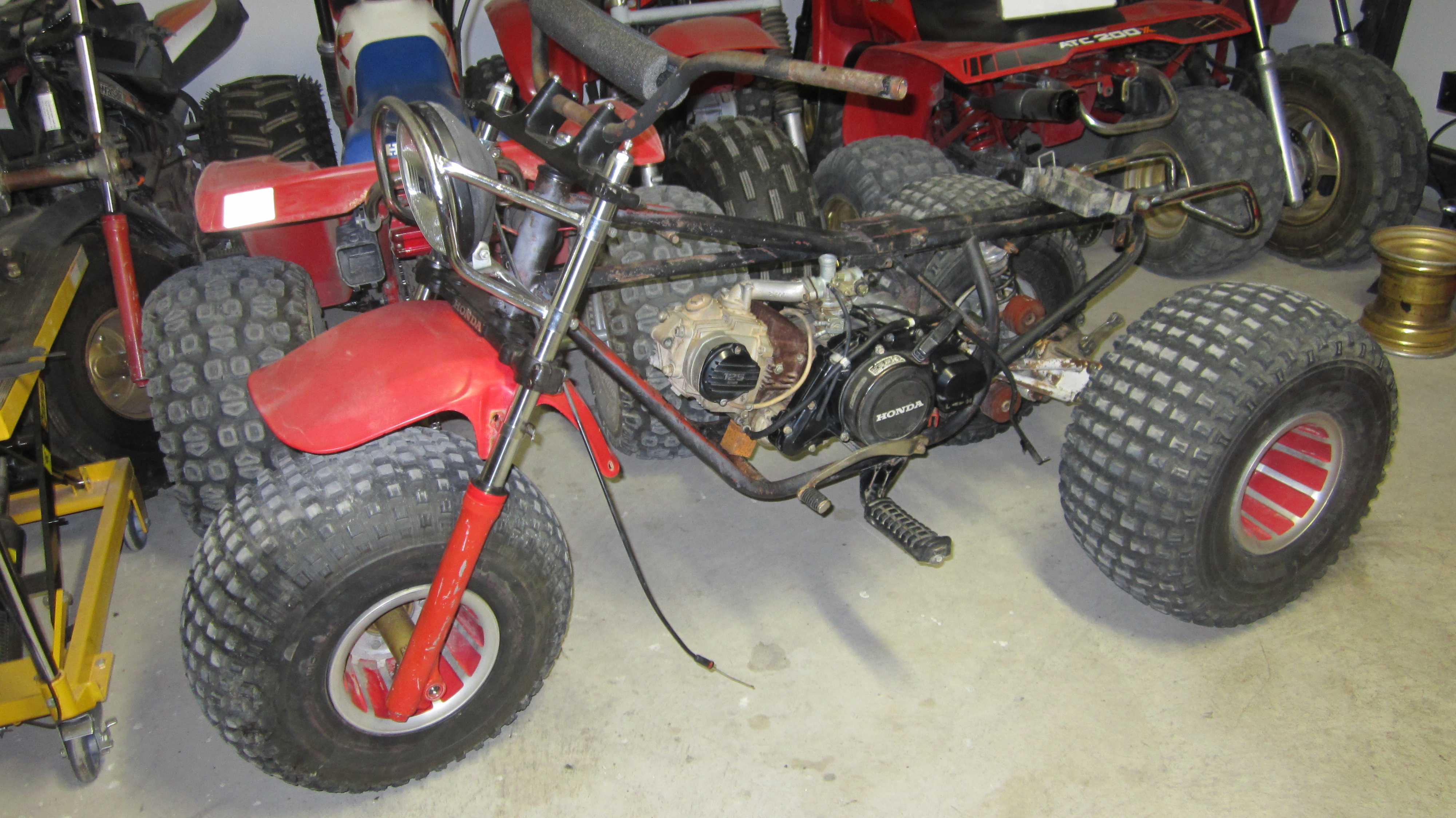

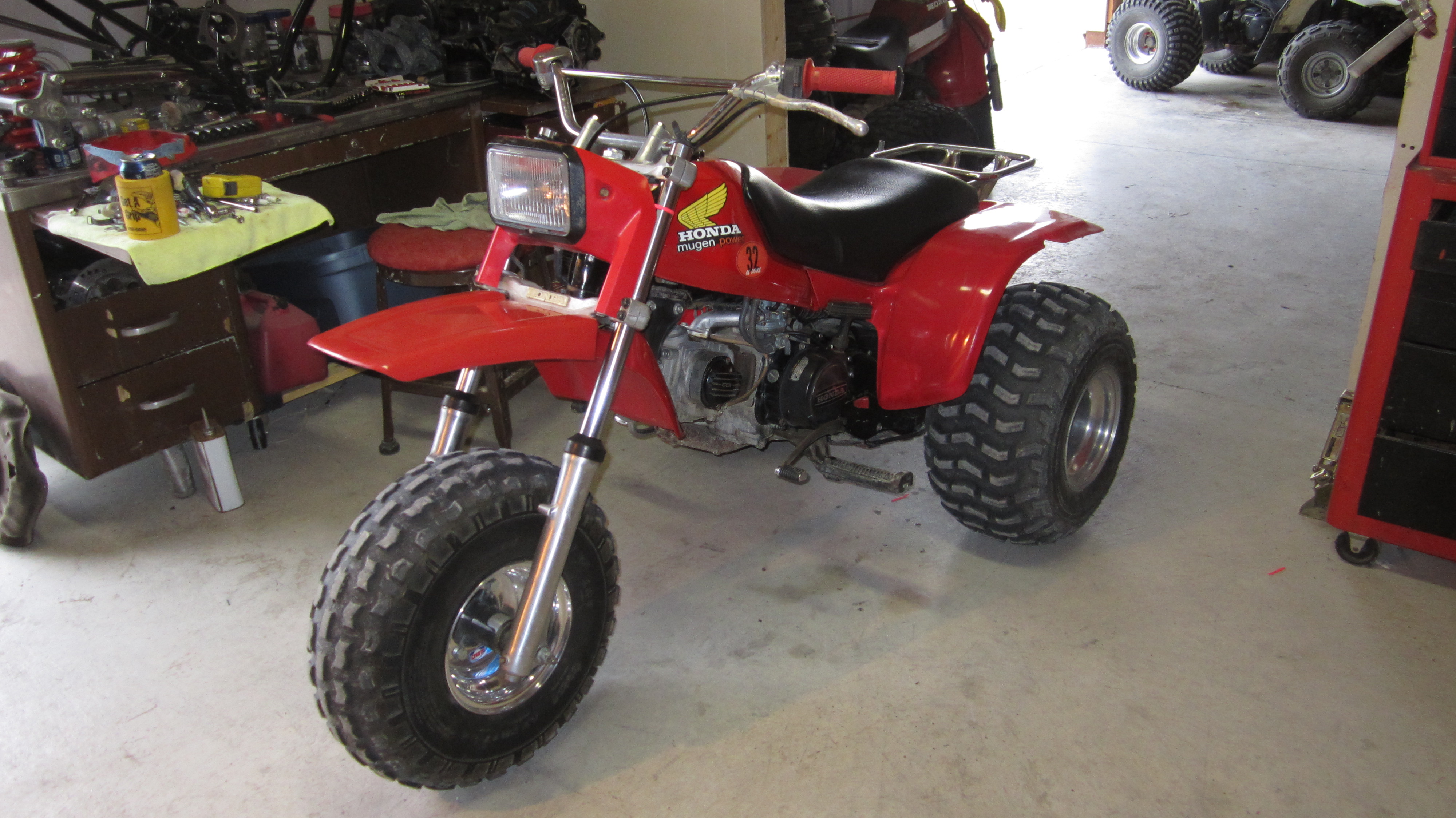

    Ol Deuce has a conversion to use the 185S stem in the 200X triple clamps. I have done a couple, and is a sweet deal.
    Aug 2007
    Montana
    857
    This is what I do
    Ol Deuce
    DO the Best With What you got !

    They work slick Ol Deuce
