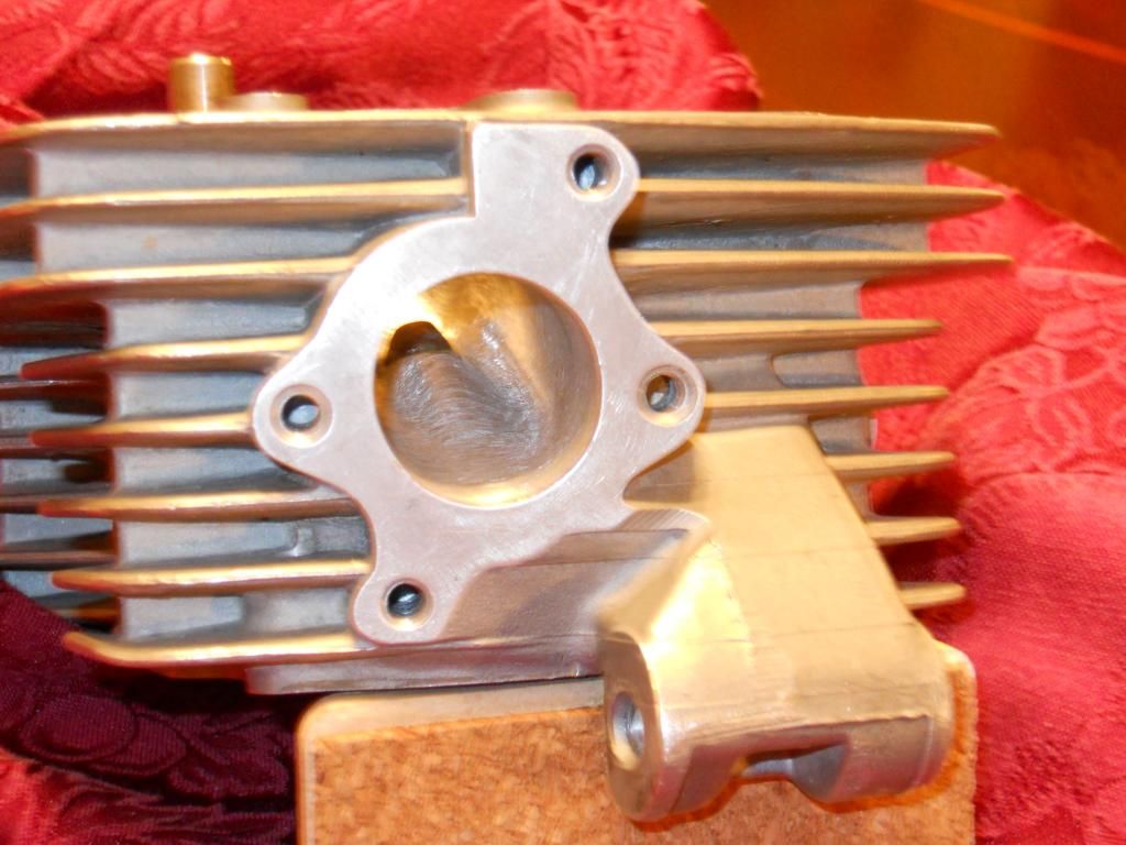

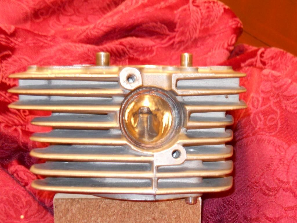

    My little Nikon camera just won't do the macro photos. This is about as good as I can get, attempting to show the texture to both ports. You're going to have to trust me, on the shape... Sorry for the poor photos.

    I THOUGHT about the welding but decided against it as I have NO/know idea, on how to weld aluminum! Thought I would go a little 'Ole school, on them... as with most things, time will tell.

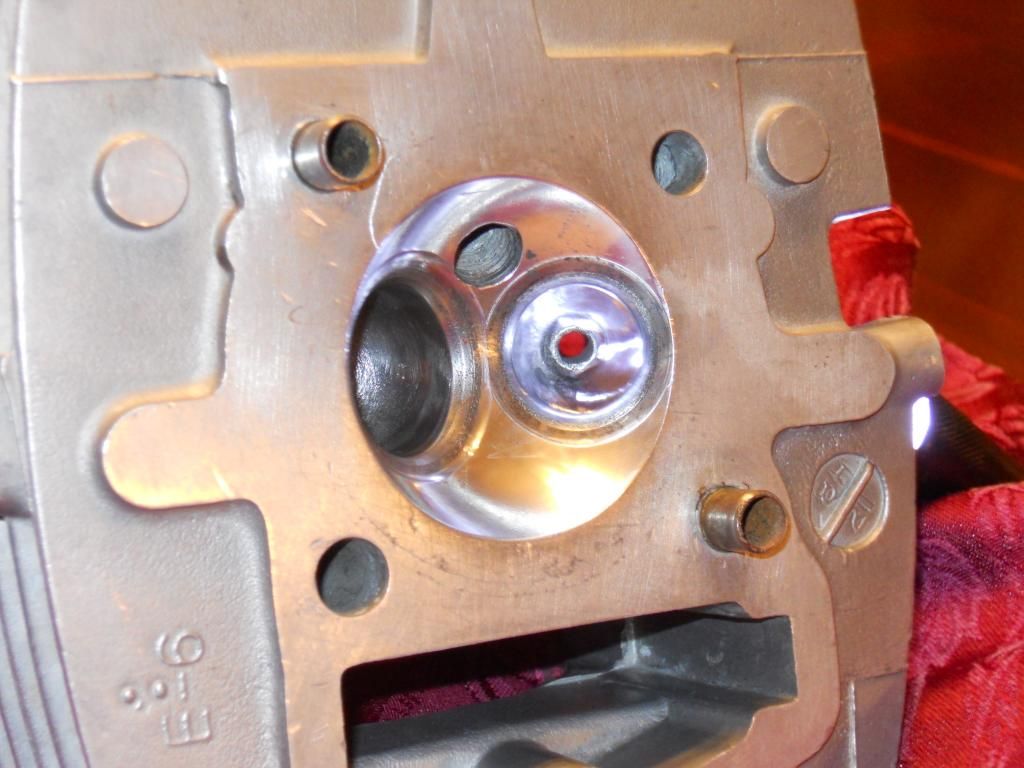

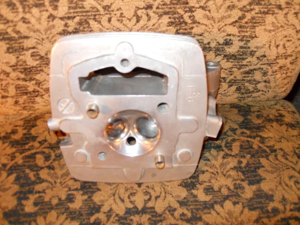

    Some better photos of the head. At least this gives an idea...
    INTAKE: finished with #80 on 3/8" drums
    EXHAUST: too much of a good thing
    AND THE POCKETS:
    good enough
    Now I can peel out the copper O-ring and get some guides in place...
