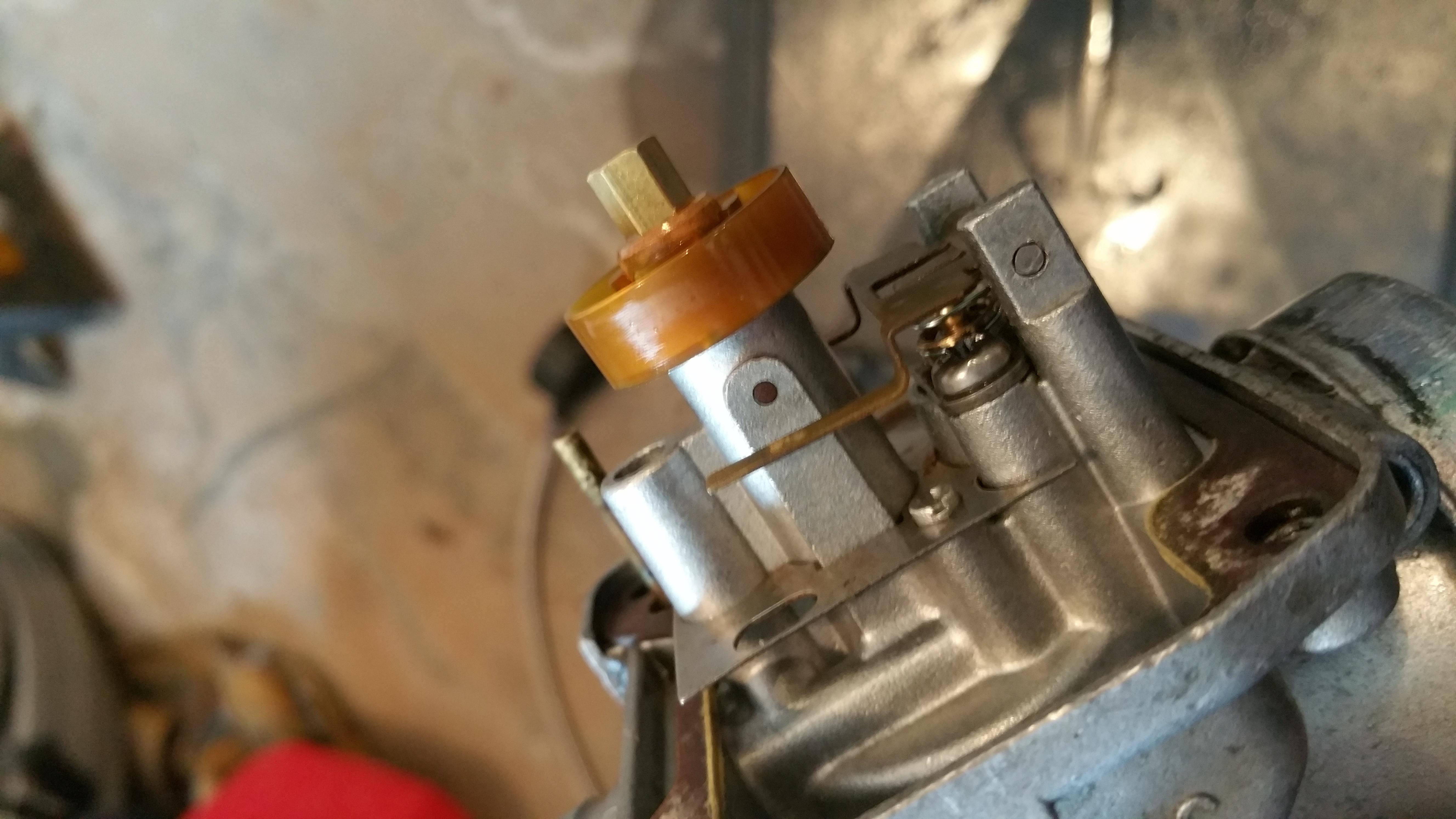

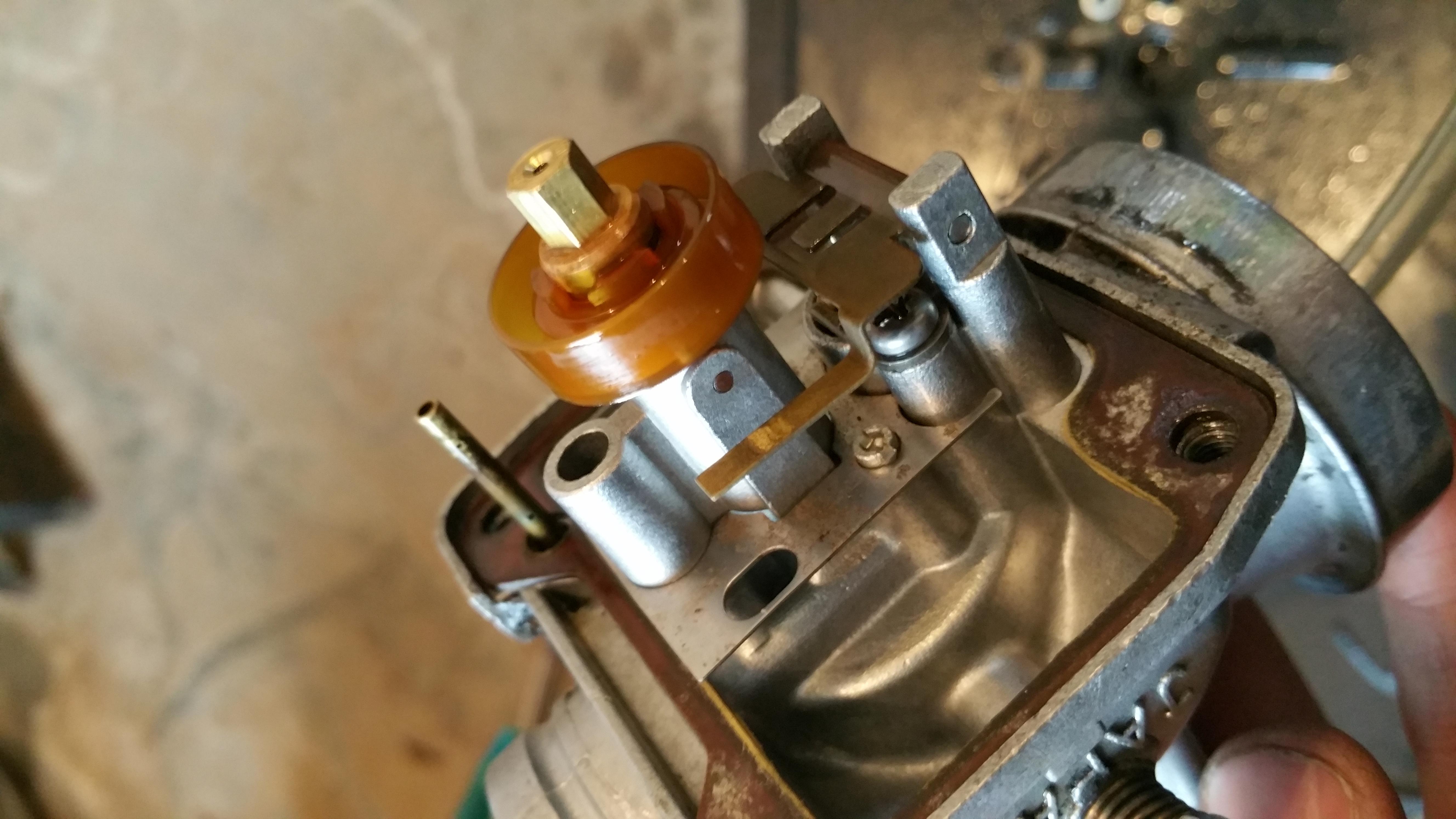

    On going battle to get the carb to stop over filling. I got the needle and seat to stop the bulk of it. but i think i need to set the float hieght. I know its 17.1mm but... from what??????

    This issue with needle seats going bad and leaking and setting float height is nothing new to me and many others that have owned Mikuni carbs. Do yourself a favor and buy a Keihin PWK 36mm or 38mm.
    Usually the 1 tang you bend in the middle to set float height is nearly flat and parallel to the metal around it.
    Dont bend the 2 tangs on the sides. Flat and parallel to the carb float bowl gasket area/carb body. Usually. Have fun geting gas everywhere and breathing the fumes.
    It doesnt take much adjustment for it to have no gas or too much gas.
    The height is measured from bottom of the bowl with the bowl on and since the bowl is not clear you cant measure it unless you tap the bowl drain bolt and put a nozzle and gas line on there which you can bend up so the gas fills the line and you can measure the height in the line. I have seen this mod and it was slick but hardly anyone does that.
    Usually the problem is always the float needle valve and not float height set from a tang/tangs that are not bent or messed with. I often gave up and just lived with the gas drip on multiple mukunis and shut the gas off when not riding.
