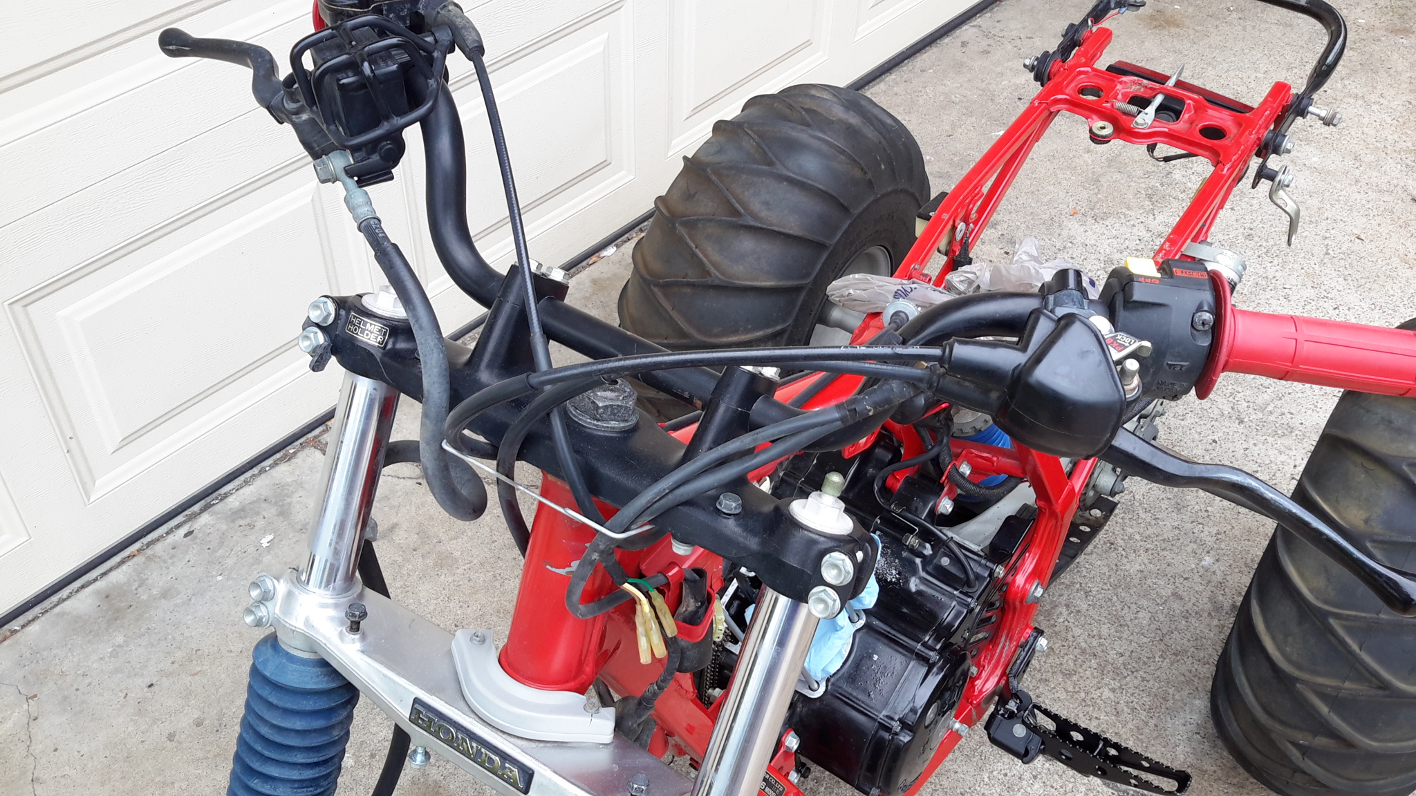

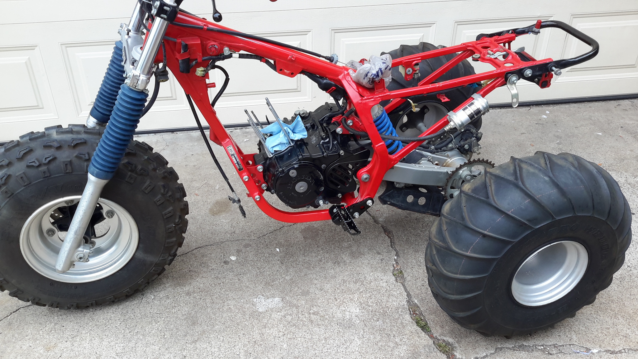

    I figured since I am cleaning my 86 200x that I should start a thread. I'm sure there are others but it's a good way for me to get acquainted with you all and 3WW.
    I call this a recommission vs. a restoration. First of all I found that a true restoration for practically any ATC is extremely expensive.........that is to do it correctly. A recommission is going thru the machine, cleaning, repairing, replacing worn parts and very limited re finishing. It's kinda keeping it's original state original with improvements. All this is what a recommission is to me. You need a good candidate for a recommission and I feel this 86 is just that.
    Just a brief history. ......I purchased 3 ATCs from a nice family who purchased them new. I picked up an 85 350X and 200x and an 86 200x for $850. They were not using them and haven't for some time and wanted the room. I only had room for 2 and wanted to keep the 350X and 200 but my wife liked the 86 so I had to change my plans and ended up selling the 350X for $4000. At that point I was shocked (pleasantly) at what these went for and also wished I didn't sell the 350X. With that said....my 2 200s are going to get cleaned up and used.
    I will post from time to time as things move along. Where it stands now is it had a bent exhaust valve. That was repaired and am going to reassemble the motor. Any input from any of you fine folks would be greatly appreciated. I am always in the learning process. Thank you.

    Reassembling the engine with new valves, top gaskets, etc. Doing a little cleaning as well.

    Putting things back together. The carb was cleaned. Both brakes were not working but now the rear has been cleaned and rebuilt. Either the rear shock was worn or it was set up for a rider that weighed 40 lbs....so I adjusted the preload. Now it is better suited for a modern Americans weight. Next will be the front end. Fix the brakes and install new fork seals.
