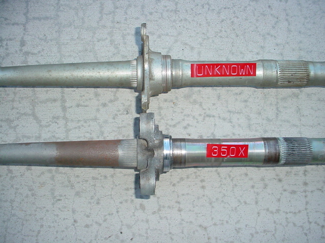

    I did some axle investigation back at the beginning of the year for an unknown axle. Turned out to be a 250x or 300EX axle. Buy the aftermarket extended 300EX axle with a 350x sprocket hub pressed on, no spacers needed and you use your 350x sprocket, bolts and carrier. The 300EX wheel hub splines are different from "85-86 350x, ATC250R or '86-89 TRX250R so you'll need wheel hubs. All other Honda hub are the same best option would be extended 400EX. Hope the attached pic's help, the unknown axle is 300EX and you can see the differences, has a 400EX hub on the left and a 200x hub on the right compared to the stock 350x set up. Sprocket misalignment of @ 3/8".

    what he said buy all 300ex stuff and sell 350x stuff for premium.
