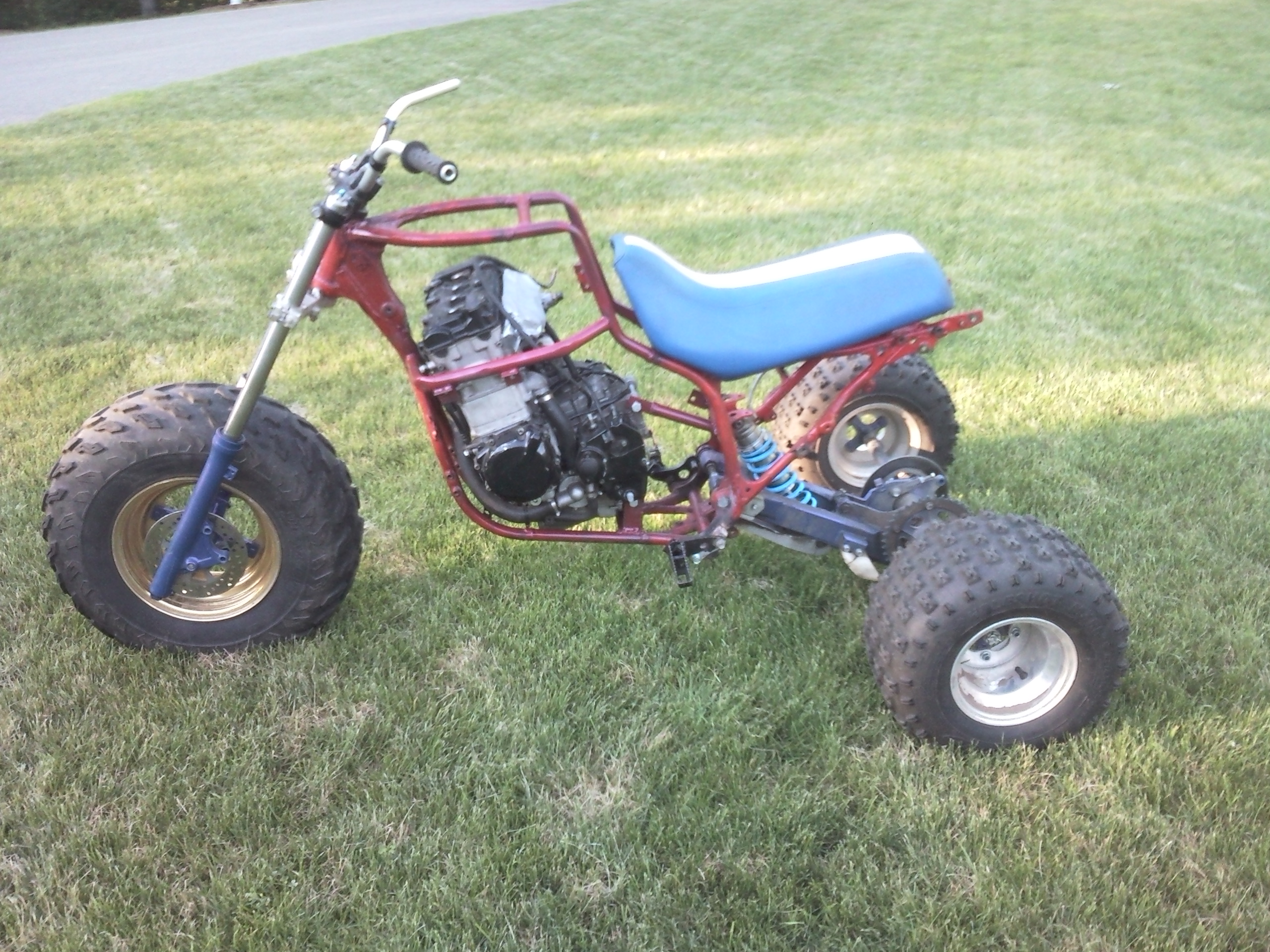

    I love this build. It's going to be one hell of a trail/dune/drag machine. If you get it suspended properly i think it will excel in all 3. The trails I ride are all wide sandy and this thing would be a dream. I like how you fit the 250r fenders looks great. Will the radiators mount in the stock location and clear the front tire. Did you modify the the rake angle so its not as steep? What all was done to get the swingarm and triples mounted? Do you have close up pictures of where the suspension mounts?
    I started a build with a 99 GSXR-750 engine but the guy that did the welding was awful so that frame is scraped. I now want to do what you did and use the factory frame/gas tank and add a +3/4 inch swingarm with inverted forks. I want to keep it a stock motor electric start reliable and fast as hell.

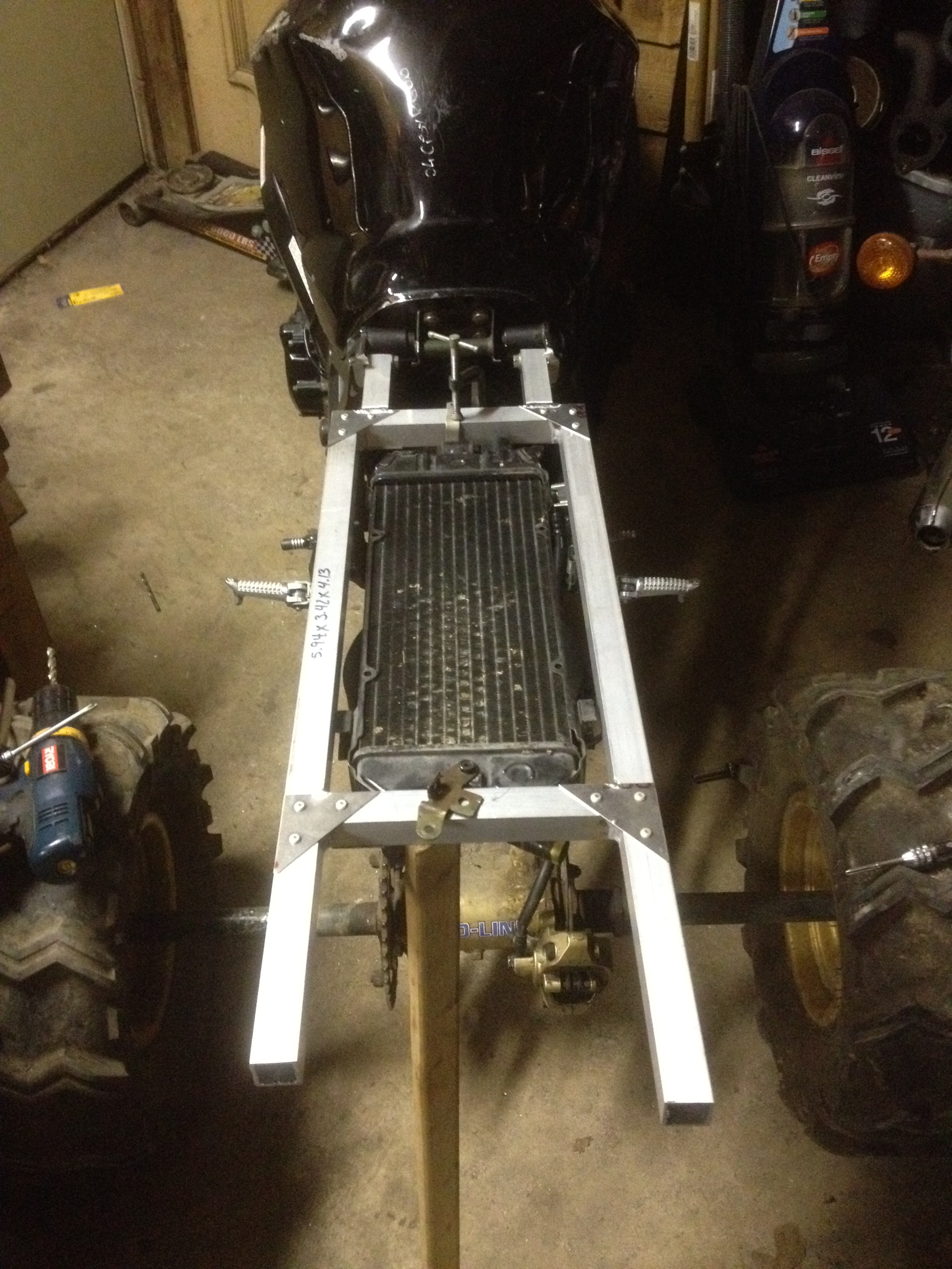

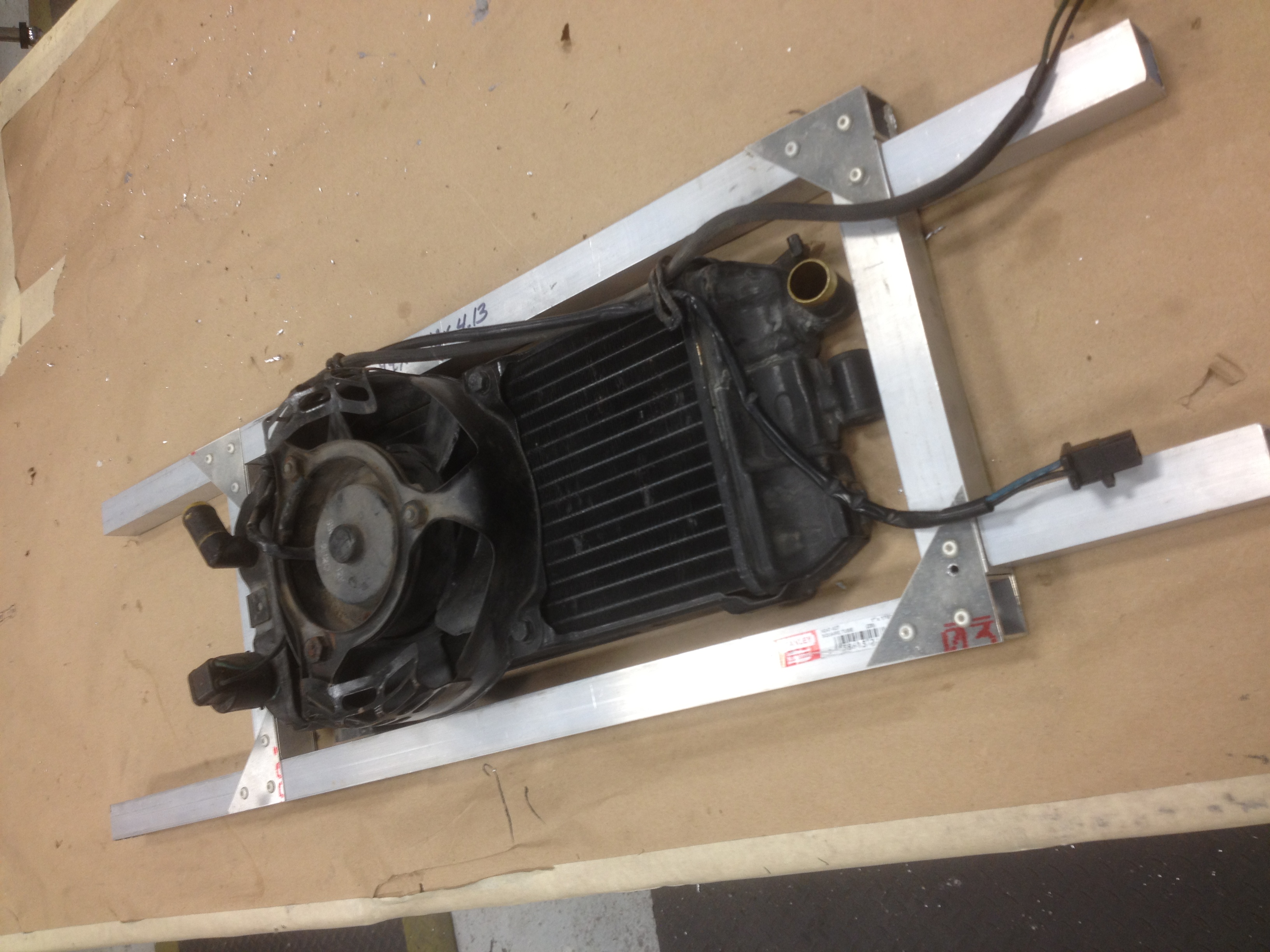

    I used the frame and motor from the GSXR750. I pressed the pin out of the GSXR lower triple tree and opened up the holes in the 250R uppers and lowers where they would press in. The front bolts on like stock with no mods to the rake angle with the stock GSXR bearings and seals. The swing arm is steel so I took a piece of .250 wall tubing and machined it where it was the same dimensions as the GSXR swing arm and welded it to the 250R arm so it too bolts on like factory. The radiator is actually mounted in a fabbed subframe under the seat.
ID:	221513   Click image for larger version.
  15. #30
    Aug 2015
    houston TX
    18
    The radiator is from a Honda 1100 and is a 2 core unit and should work fine. This is not my first build like this so that's why I responded like I did when people judged it from a picture. I have a turbo GSXR600 go kart, a 350+hp GSXR1100 turbo, 2 turbo Hayabusas, a turbo DRZ400 Supermoto, a twin turbo 355 S10, and that truck in the pictures has a Paxton Novi 2000 supercharged V10. If its got wheels I can ride it and I would never judge something like this much less talk bad about it from seeing a picture, I build all of my stuff myself with the exception of bugging friends for machine work and welding. I'll be the first one to help anyone who needs it and offer any tech advice that I can. Also I was just digging on the guy with the lowered Civic, I have 2 Civics myself. Hahahahah!!!!!!
