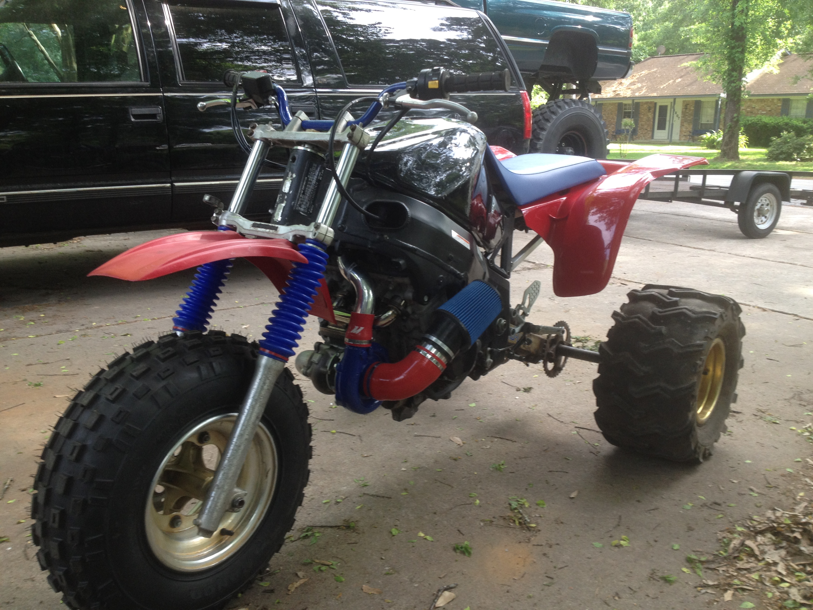

    Hey everyone, just found this site and wanted to share some pics of my latest build. I have built and raced 3 wheelers for years and its nice to finally find a place where we can all get together. This is a 05 GSXR 750 motor and frame with 86 ATC250R suspension. Its not complete yet but just getting the wiring done and finishing up the turbo kit. All the work was done by me, let me know what you think

    I guess everything really IS bigger in Texas! Who else here noticed the green monster in the background of the first pic? Nice toys you have there!

    You might be completely insane. but of completely insane creates a 750 cc turbo charged racing monster im ok with that
    In the pics, your forks were designed to be leading axle, so I'm guessing 350X front suspension?

    actually, when the pics were taken the forks were in backwards, its actually got 250R forks. Originally it has 1984 suspension but I just upgraded to 86 forks and brakes

    A turbo GXSR trike sounds like some sick sh!t. I imagine it in an 350X paint scheme. Looks nice. What about the suspension? I'm wondering.....you might need a different shock cause I picture this toy heavier...especially when the power comes on. I'd love to have a go with it at Glamis....I bet fun as can be. Welcome

    I am ordering a heavier spring for the rear shock, not sure what I'm doing with the forks yet since I just fitted 86 forks and brakes on it. I built another one about 10 years ago with a F2 Honda 600 frame and motor and was wondering if anyone had seen it. I sold it on eBay to a guy in California. If anyone knows where it is I would really like to see it. Thanks

    The tank is being painted this week, Honda red and I'm looking for a nice 350X headlight for it.I might register it and street drive it when it's done. I built another one about 10 years ago with a Honda F2 motor and frame. I sold it on eBay to a guy in California, if anyone has seen it let me know, thanks

    neat idea....but wont be a good trail machine...just an I can go super fast if I can hang on machine.

    You say that like its a bad thing? is that your opinion or are you assuming that because you couldn't trail ride i that it can't be done.? I have built a few of these and have trail ridden all of them. I have never understood peoples need to find fault in a build like this. Did you happen to notice the truck in the first picture? I don't build stuff to be like everyone else"s. I guess if I "titled" it it would be practical.

    That is absolutely insane... ly awesome. Insanely awesome. I've never seen anything like that in person and would love to see how it rides!

    i dont see anyone having cahones substantial enough to shift past 2nd gear. fun to look at tho

    Great to hear . Show us a 10 minute video trail riding it when it's done. We'll all be impressed. IMHO< peoples need to find fault in this is because it doesn't make any sense to them. Myself certainly included. Good luck ?

    I'll get right on that video......sorry I gave up doing things to impress others when I got married. You're right, a 170hp 3 wheeler is about as useless as a titled 4 wheeler and a lowered Civic, maybe a little less. Maybe I should list all my vehicles in my posts too and then try to sell parts. Good luck to you too.
