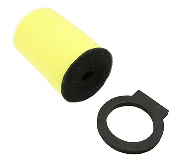

    Only issue I really discovered was with the air filter. The foam "donut" on the air filter guide has completely deteriorated. From some online research it looks like that style filter had been used for many years after on many Yamaha ATV's like the Moto-4, Big Bear, Timberwolf, etc... Even the newer Warrior/Raptor 350's look to be the same style. The only difference is that they seem to be an inch or two longer.
    I found a couple replacements online that look like they come with a new "donut" to seal the air box like the following:

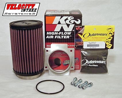

    Then I discovered the "airbox filter adapter" for the Raptor 350's, that replace the weird factory lid secured air filter all together.
    Those kits are kind of pricey, but I'm curious if anyone has used adapted one of the eBay cheaper versions for a Yamaha trike?
    After installing the "clamp-on" style mount you can use whatever air filter you desire.
    Just wondering if anyone has any experience or pictures of one mounted... Any insight would be appreciated. Thanks!
