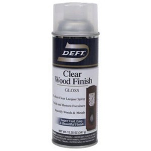

    I didn't see his bike but if you are on a budget and want to do lime green, you can buy aerosol cans of it from Colorrite on Ebay for $20.00 . One can would be enough to do the frame if you sprayed in on fairly closely . You could even paint the engine green then clean the paint off the raised letters so they stand.
    http://www.ebay.com/itm/like/1116551...&ul_noapp=true
    If you spray can the frame, I would spray gloss clear lacquer over it after it dries for a couple days . You can get it from Home depot in Deft or Verathane brand and it will usually say "For Wood Finish".
    This is Colorrite #777 here.
    This is orig Kawi #777.
