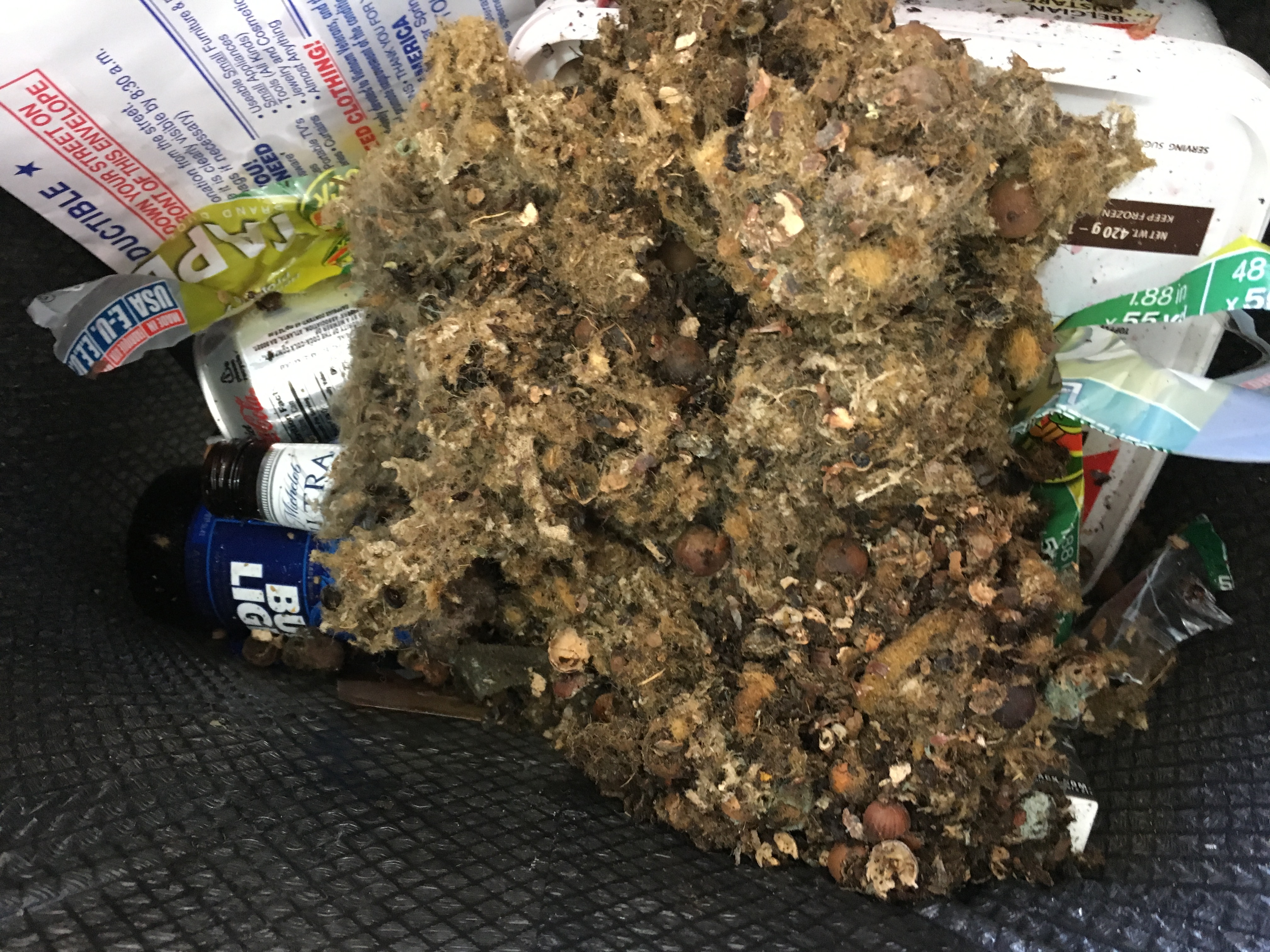

    The rats found there way into the air intake under the tank and made a cozy little home inside the air box. I pulled both intake tubes out and got them all cleaned up. I took nearly a whole bottle of carb cleaner to the carb. The choke and the thottle seemed responsive and smooth operating.

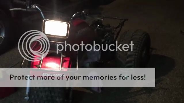

    So I rigged up a little filter to get it some fuel and decided to kick her over. It took maybe 12-15 kicks and she fired! I was amazed!!
    http://vid282.photobucket.com/albums...pspxvrvshc.mp4
