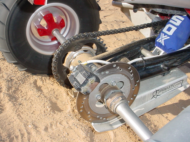

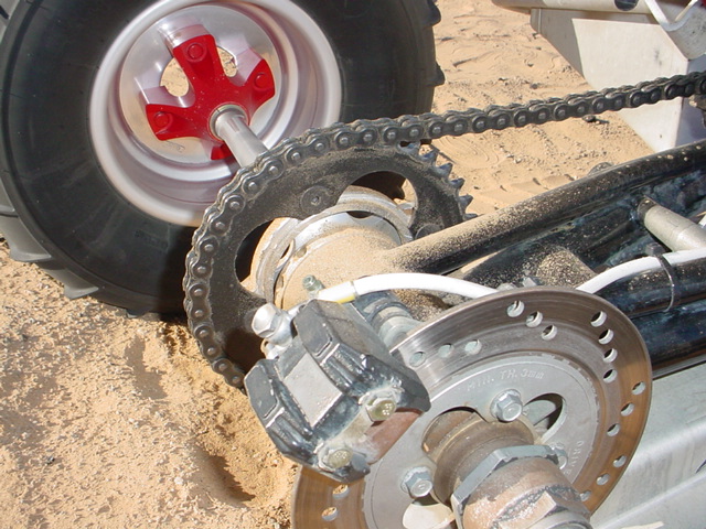

    Here's a couple pic's of Shawn's set up taken at the 2019 Invasion.

    All he needs is 4 spacers about 1" OD x 10mm thru hole and "xxx" length. Tell me lenght needed I'll turn 4 spacers for you and throw in your box. Lotta you guys over think shims and spacers. The guys who design the spacers like to take it to the grave for some reason. I make a drawing and offer the services as it only take a few mins to make.

    I went with the 300ex axle setup pictured above by Harry for a few reasons , I got an adjustable tusk axle for 200$. New 400ex (same as 300 450 200x etc) for 125$ (could buy used one eBay for less I’m sure ) and now I get to use more common sprockets. 300ex 400ex 250r 450r all share sprockets. So I saved money and got newer more upgradable parts. Carriers are the same either way. I originally just used stainless spacers I got at the hardware store. Ran that for almost 2 years until I saw the machines one on the store here. Never had an issue. Good luck let me know if you have any other questions.

    Yeah I have a niche carrier and have zero complaints. Yeah the durablue is over 400 bucks and your stuck with 25t hubs. They make Plus 1 hubs for 200bucks. That's 620 plus taxes. That's why I improvised. Tusk axle was 200 hubs were 100. Looks better just as strong and even wider. All for 300bucks. I did buy a new sprocket and axle nuts. Not a whole ton of cash. I used my stock 350x axle nut. I've had bad luck with the posi nuts from durablue. But I'm the only one apparently. And thank for the bike compliment. I dig the way it looks and love riding it.

    Yes he had a HRE swingarm. I was there yesterday again and he makes good stuff. You dont need HRE swinger just to run the 300ex carrier. both are the same, just need to swap some parts and have some spacers made. Mutiple ways to do the same things
