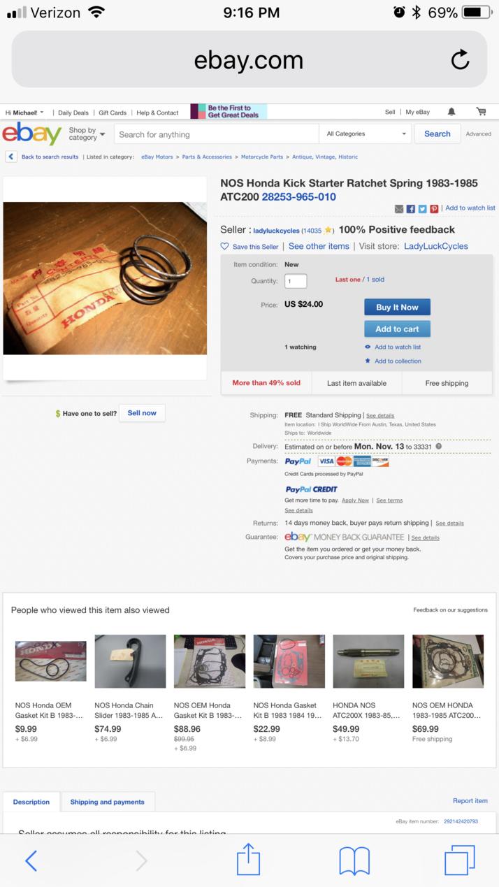

    Looking for the Updated spring for the kick start for the 200X, first gen, just took mine out today.
    Or does anyone have the part numbers?
    Thanks!!

    Here ya go . Hard to find .
    https://www.ebay.com/itm/NOS-Honda-K...edirect=mobile

    I was looking around, found them for about 4 bucks plus 6 shipping, but not sure if it's the recalled spring or not. In fact I read the xr200 used the same system. Thinking of swapping it all out for the xr200 set up. I appreciate it.

    28253-965-000 is the original spring , the upgraded spring is 28253-965-010

    Thank you so much!!
