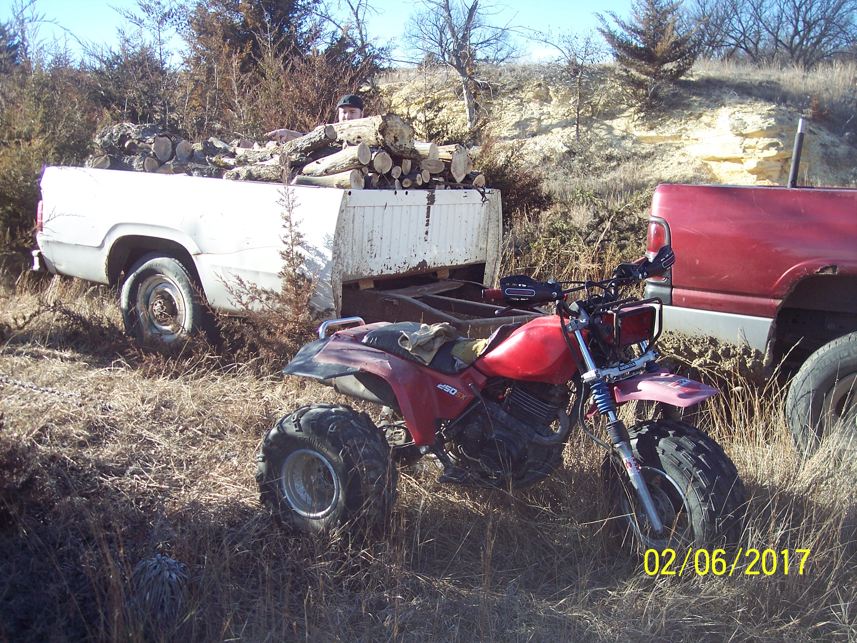

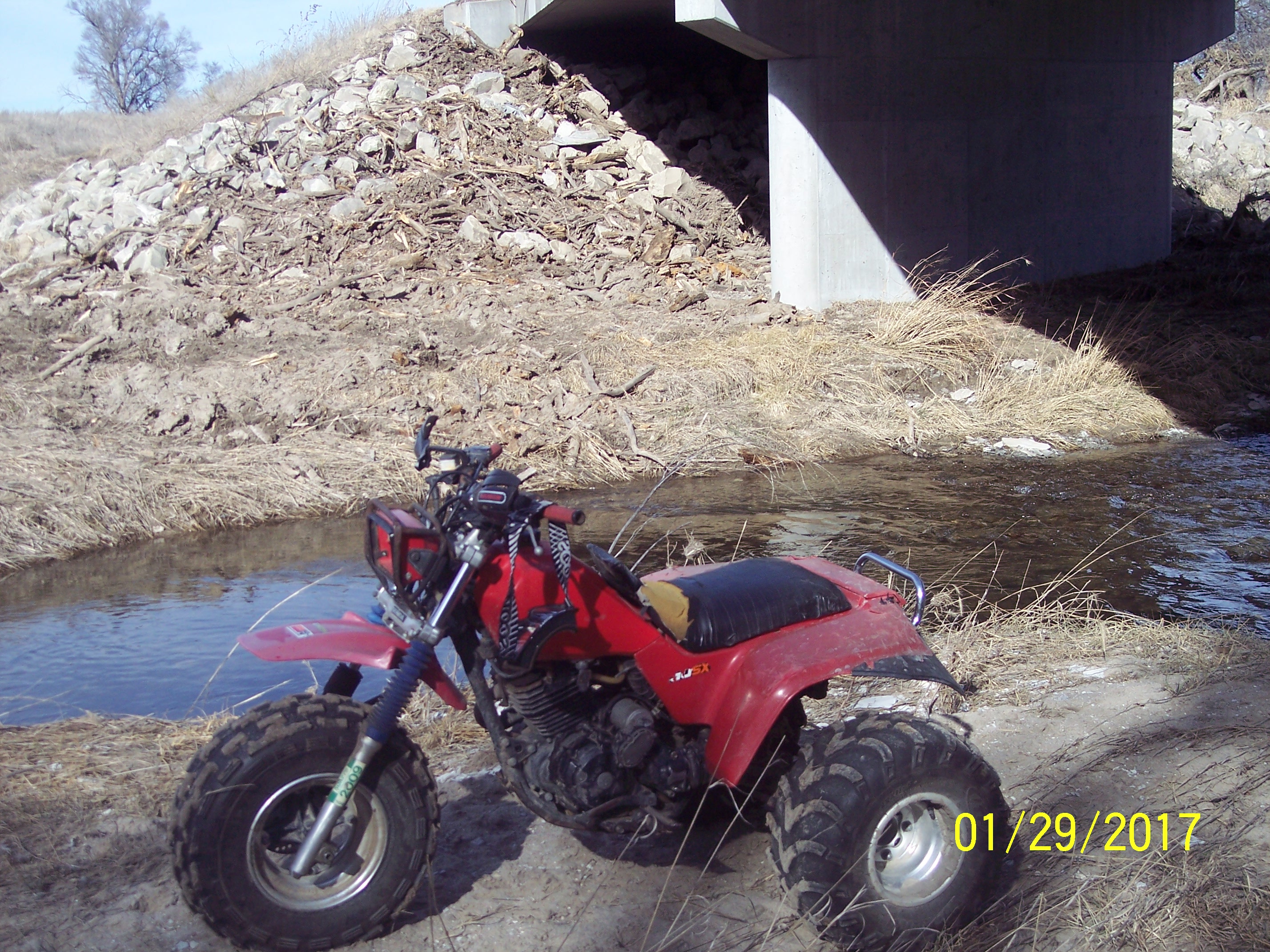

    If you want an idea of what a 200X front end looks like on a 250SX, here's mine. Not pretty, but VERY fun.Click image for larger version.
ID:	250651Click image for larger version.
