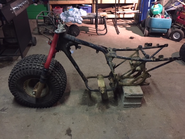

    Hello, I just joined as I am working through converting an 83 ATC 200E into a hardtail motorcycle. I have 2 ATC 200E's that I bought for cheap and I am going to try and keep the one that is the most complete together while converting the other.
    This is what I am starting with:

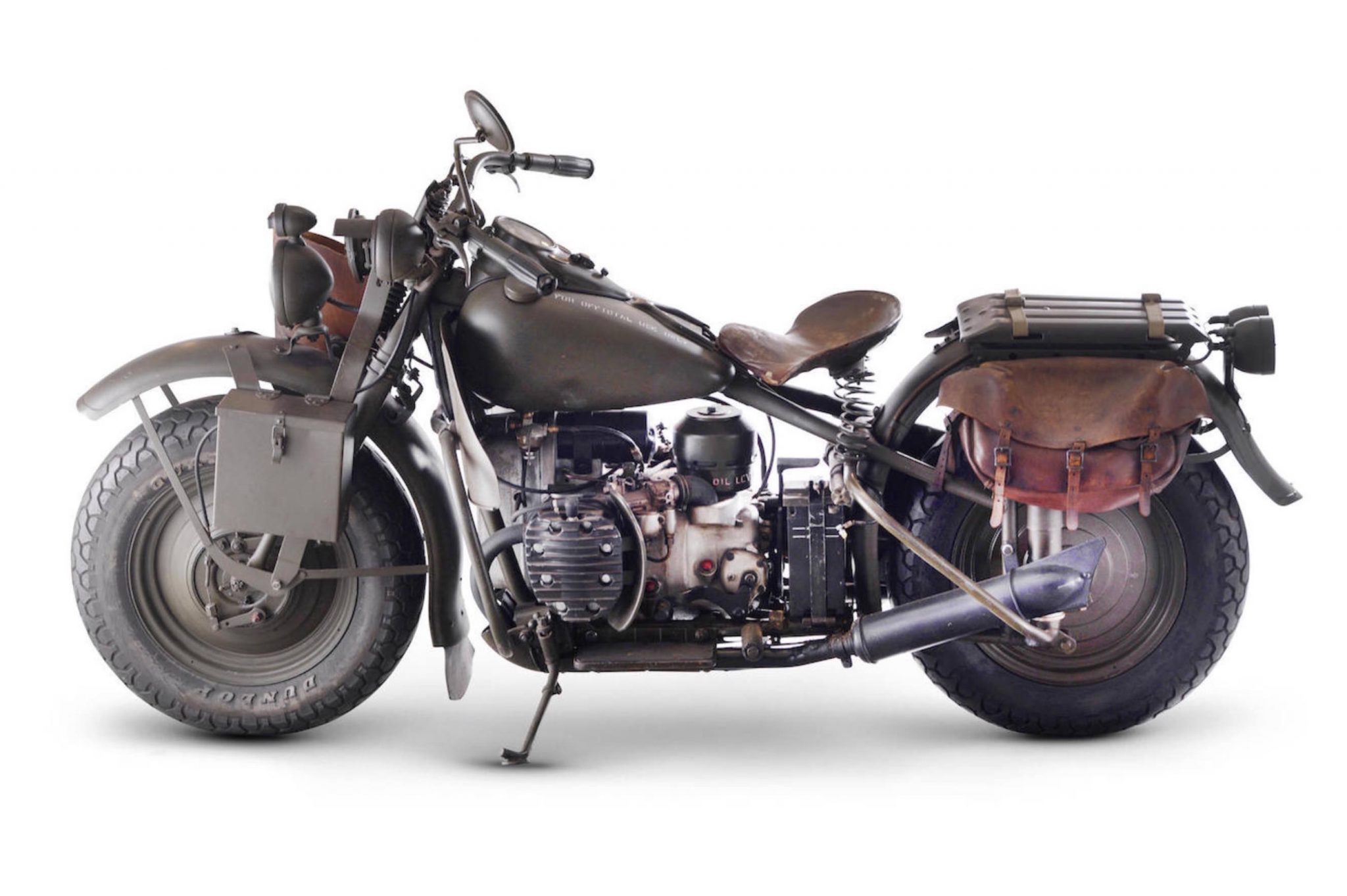

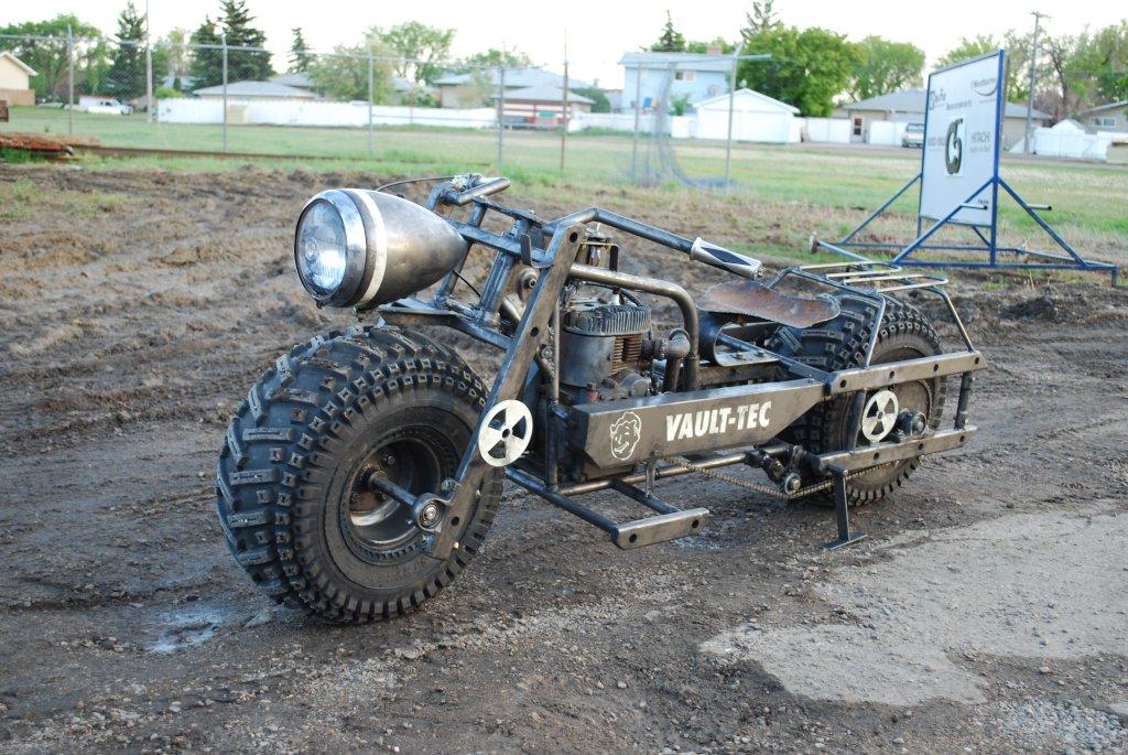

    And this is my conversion inspiration:

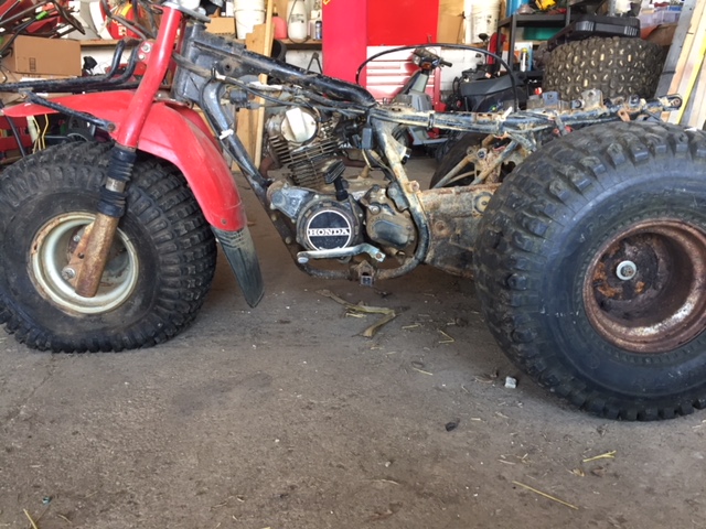

    This is where I am at so far:
    I have two questions to begin:
    1. Are there any detailed instructions/pictures on converting a front hub into a rear with a sprocket?
    2. Has anyone used the rear axle as a jackshaft so they could maintain use of the rear brake? I see issues with where the chain from the gearbox would meet the axle hub but if that has been modified easily before, it could really simplify the jackshaft and brake assembly. Plus I like reusing parts where I can. Let me know!
    I'll keep posting questions and pictures as I move along with the build. I am calling it Monstercycle for now but am definitely open to better names.
    Happy to be here!

    A bit more progress on disassembly and very excited about this....the engine runs! It turned fine and felt like it had compression when I tried the pull start but now I confirmed. I used some starter fluid and pulled away and brub brubg brurbrburburburburb! I was almost writing that off but these Hondas do last forever. After sitting in a guys back (junk) yard for who knows how long with no covering, very glad it runs. Anyway, I took most everything apart and then cut off where the toolbox and grab bar used to be as those tubes will not be used with my design.
    Next project is to remove the front forks and disassemble and see how the shocks and springs look. I hope they are OK because I hear these are not easy to come by anymore and most people just use 200m forks because of it.... we will see. But I did order my paint and I will be getting my tubing for the hardtail soon. I have some plans drawn up for how i want to do it and how i want it to look. We wll see how that works out in practice.

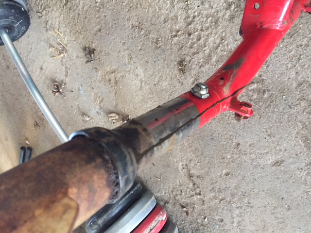

    Ok, a quick update on some progress. I finished up taking everything apart. First i took the shocks apart to see what I was dealing with. When I turned the frame upside down something leaked out..
    It looked like mud but maybe something else, either way that means the shock seal is probably bad.
    I got the bottom part of the tube off (tech term for where the axle and brake attach) and look at this.
    Ew.....
    So I pulled the shocks out, got very muddy in the process. As I did so questions ran through my head like "how old is this mud?" and "How rusty and bad are the springs and shocks?". Well luckily for me the springs weren't broke and the shocks seemed to have some life left so I am going to try and reuse them. I have them soaking in evap-o-rust right now.
    Then I did something very stupid. I took the front forks off without thinking or researching what bearing were in there and.... as you can imagine and audible 4 letter word came out of my mouth as I watched tiny balls spill all over my dirty garage floor and roll under everything....

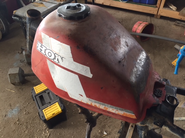

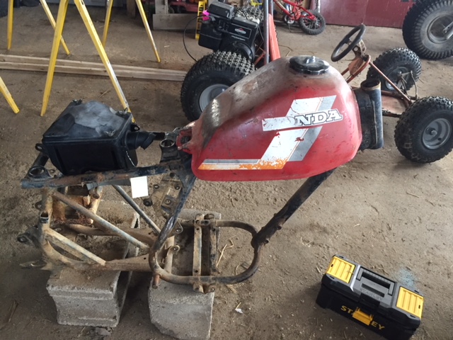

    A quick update, I haven't gotten a ton of work done on the Monster but I have gotten parts! (I did clean and repaint the shocks and springs) I got a used (slightly dented) gas tank and air box off of Ebay. Both look great.
ID:	251439Click image for larger version.
ID:	251440Click image for larger version.
ID:	251441Click image for larger version.
ID:	251442Click image for larger version.
    I will be trying to work those dents out before painting. Stay tuned for that.
    Also, did these 200e's have an air filter in that air box because my other bike doesn't have one either. Any suggestions on where/what to buy?
