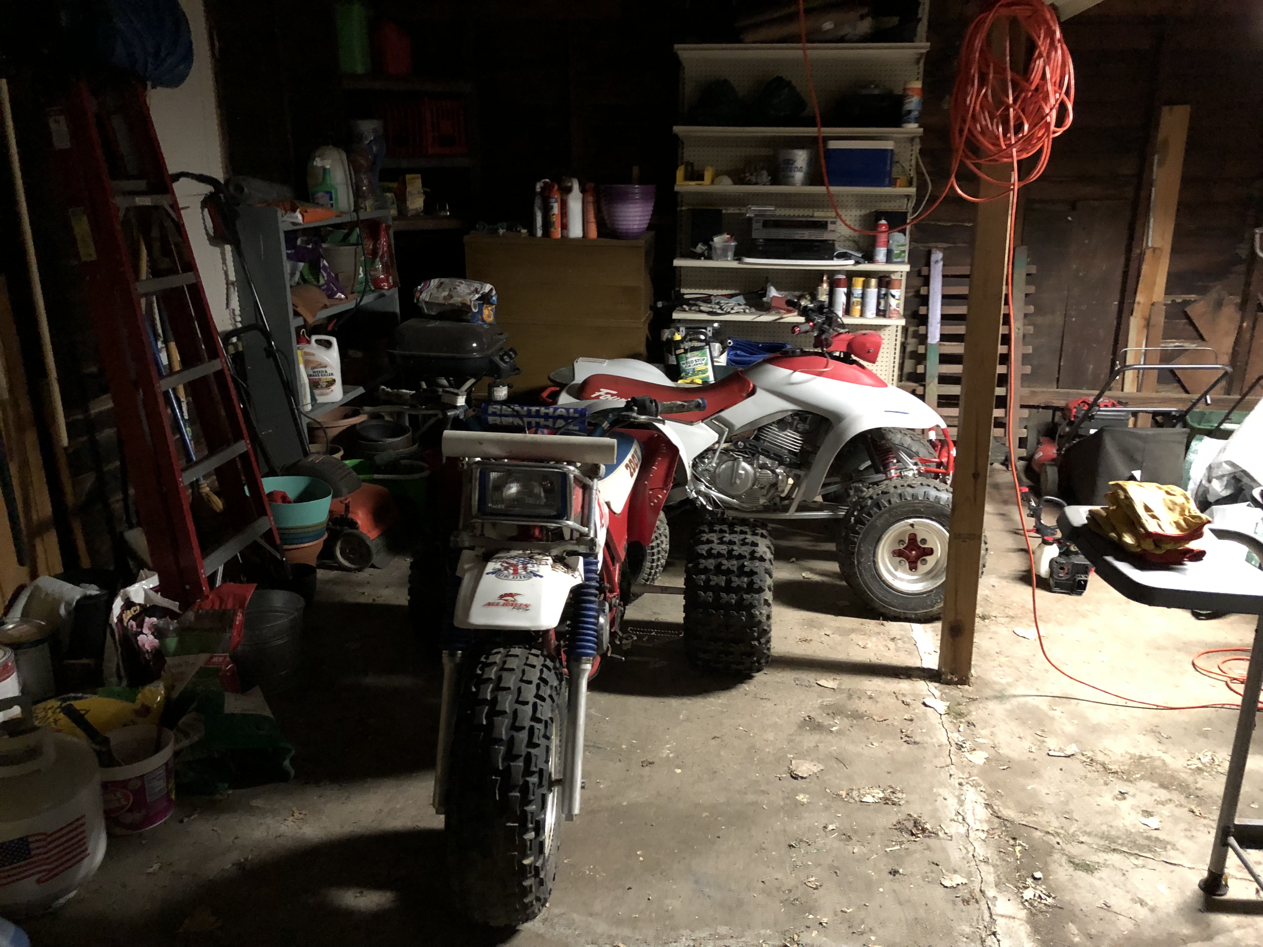

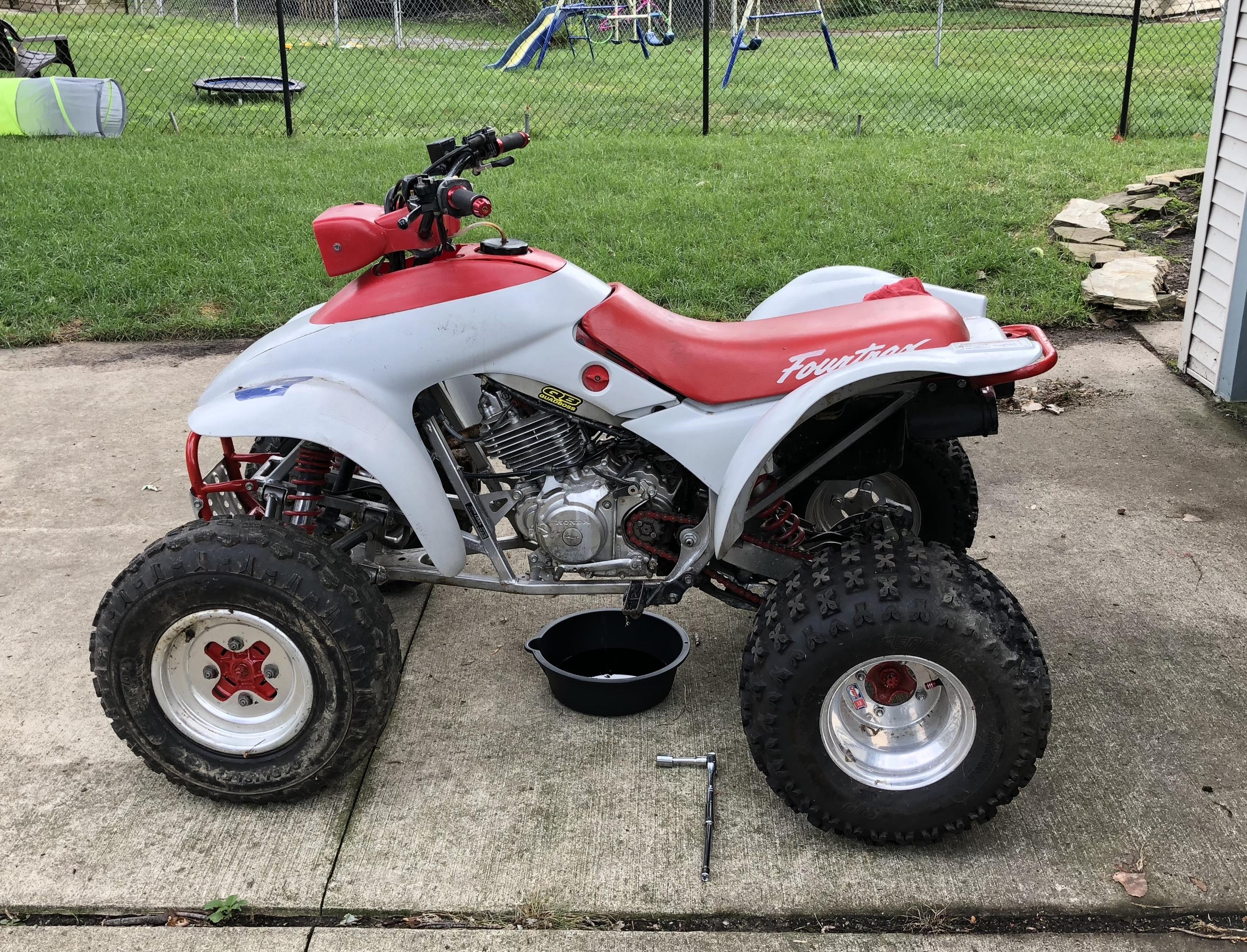

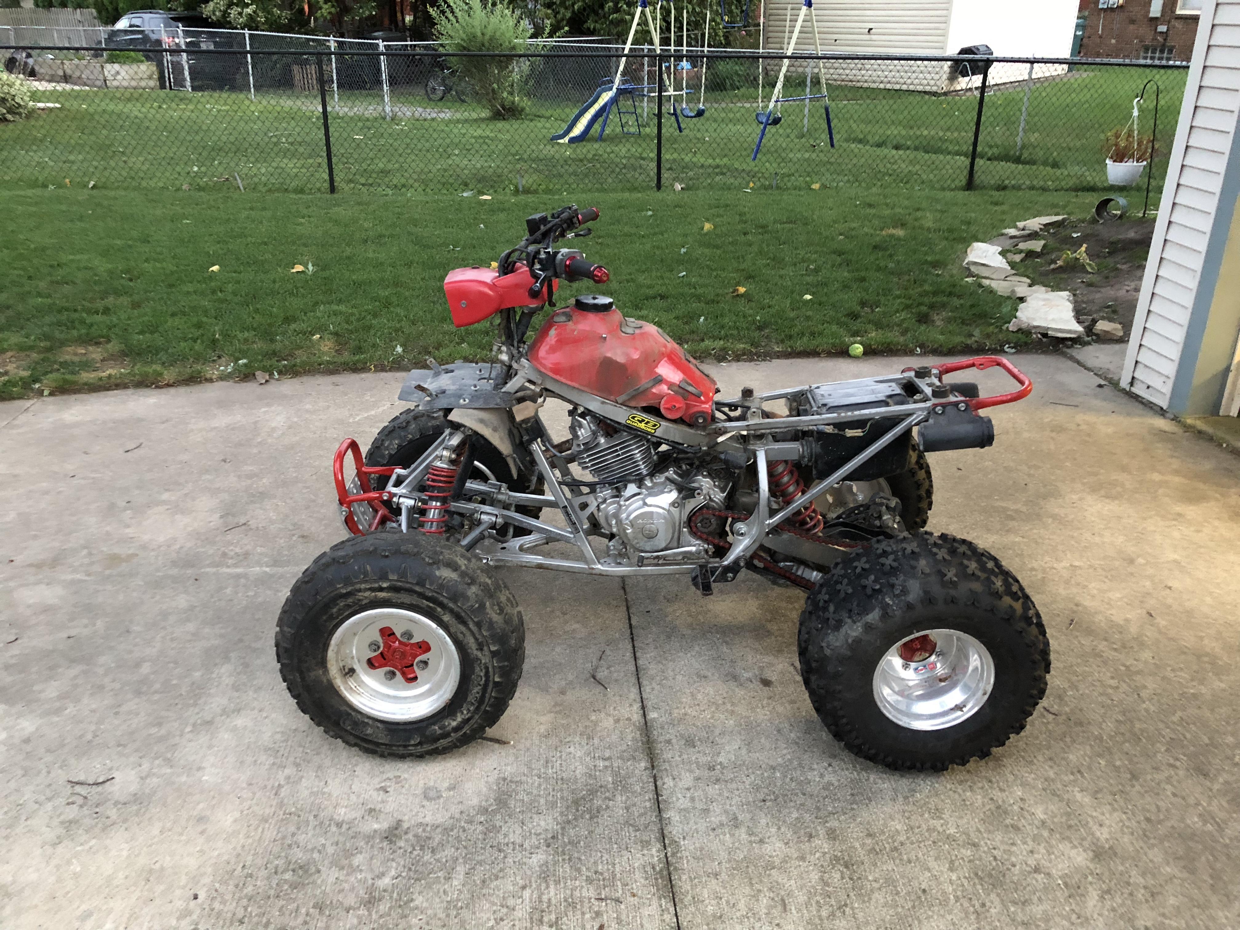

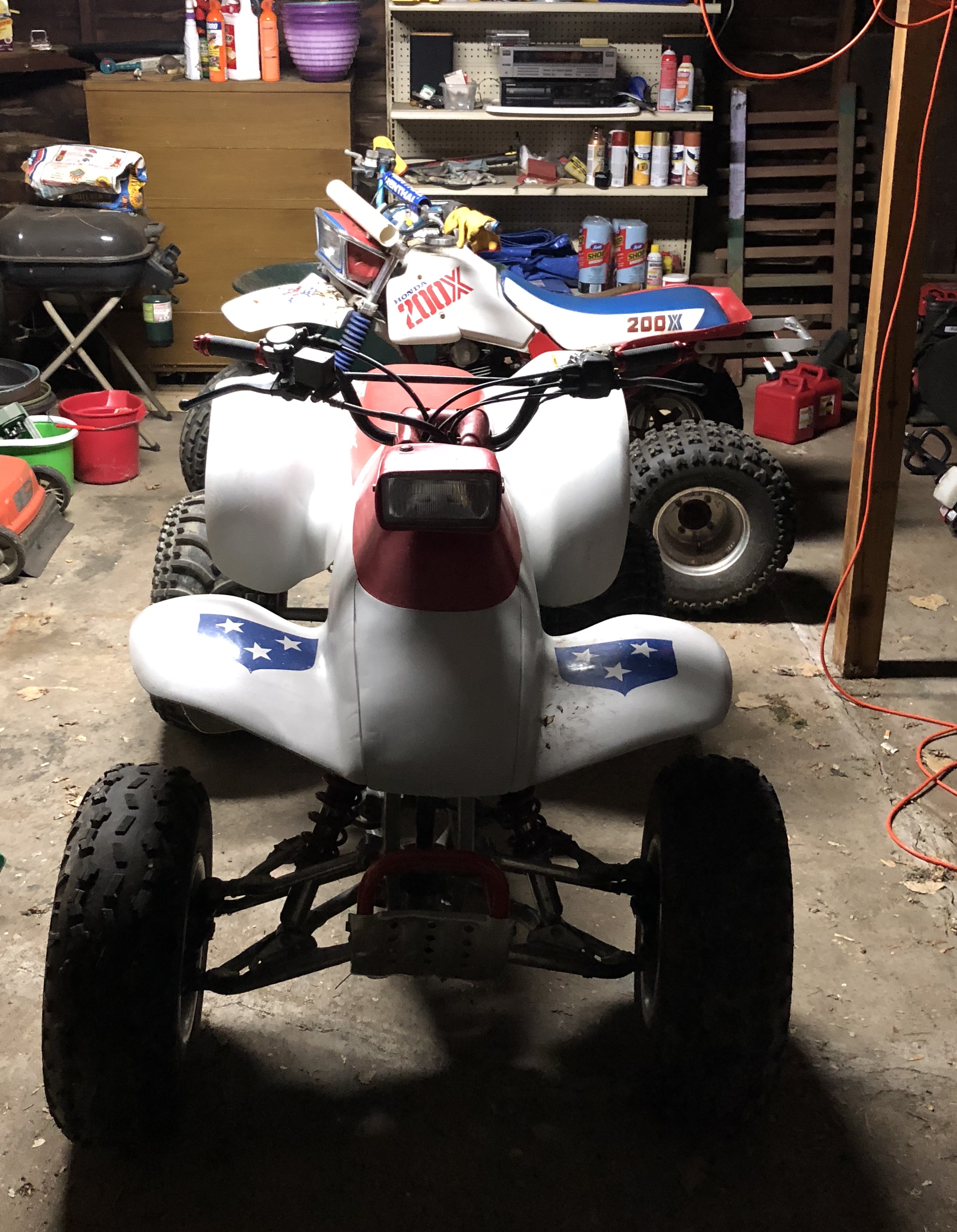

    I don’t have many pics, only a couple.
